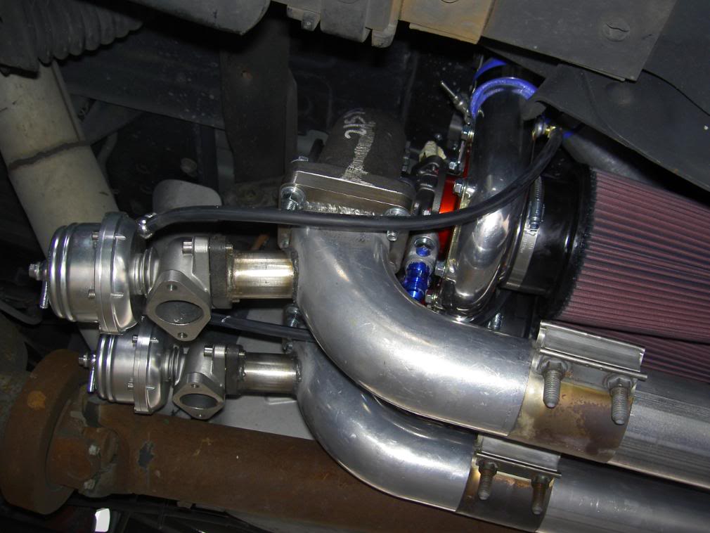

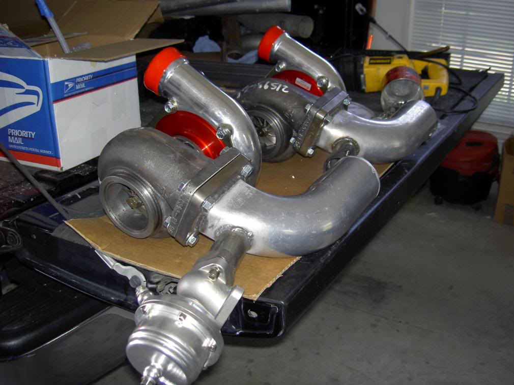

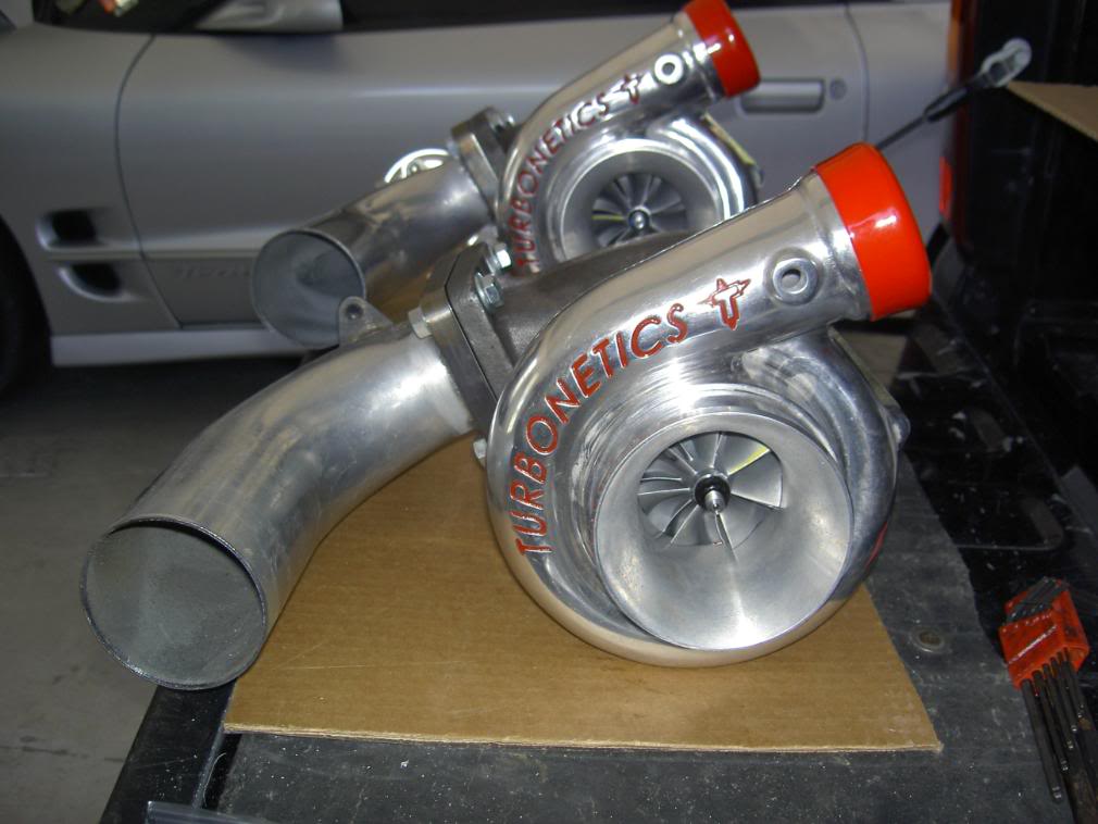

My dad built a custom twin rear mount setup on his 8.1l 2500HD with the allison trans. The turbos are 6*mm turbonetics, can't remember the a/r ratio though. He usually runs 5psi normally and 10 on the higher setting until recently he went up to a 8psi spring and runs up to 15psi for brief hits. The damn truck moves out thats for sure. Boost builds kind of slow but not too slow. He also pulls a fifth wheel travel trailer fairly often with it as well. It was tunned by Nelson Performance on here. If I remember correctly according to my aeroforce scan gauge the truck was making in excess of 530rwhp! and that was on the 10psi setting with a max of like 7* of timing. Conservative tune I know but for obviouse reasons.
Here are some old mock up pics.
