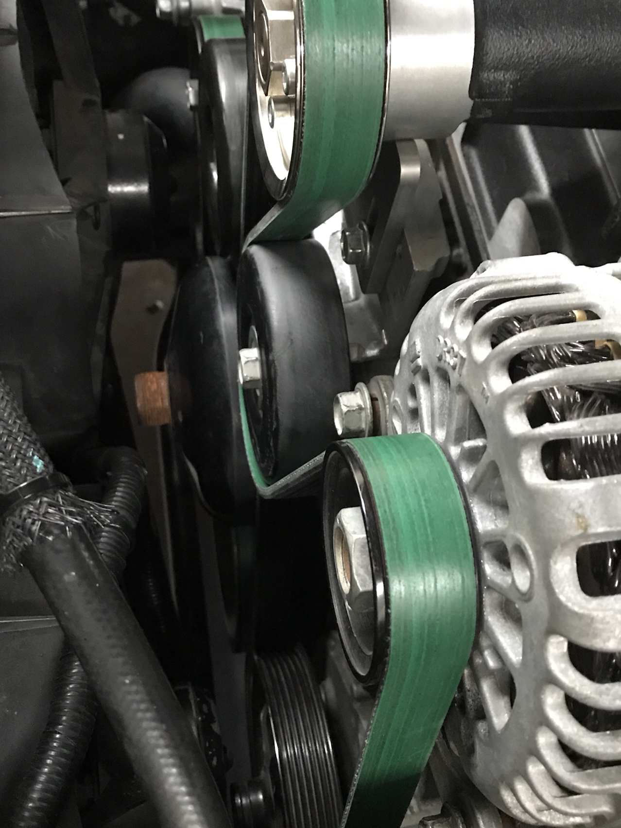

Crank is pinned. I'll weld the water pump tomorrow. Been meaning to do that. I'm still a little confused why the belt is riding on the outer edge of the driver's side idler though. I know that's not normal cause I've seen several pictures online of TVS truck setups and the belt rides totally in the middle. So something is screwy with something on my setup. Even though it doesn't throw the belt.

Post a pic please.

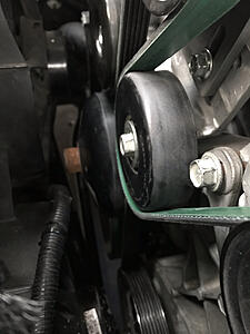

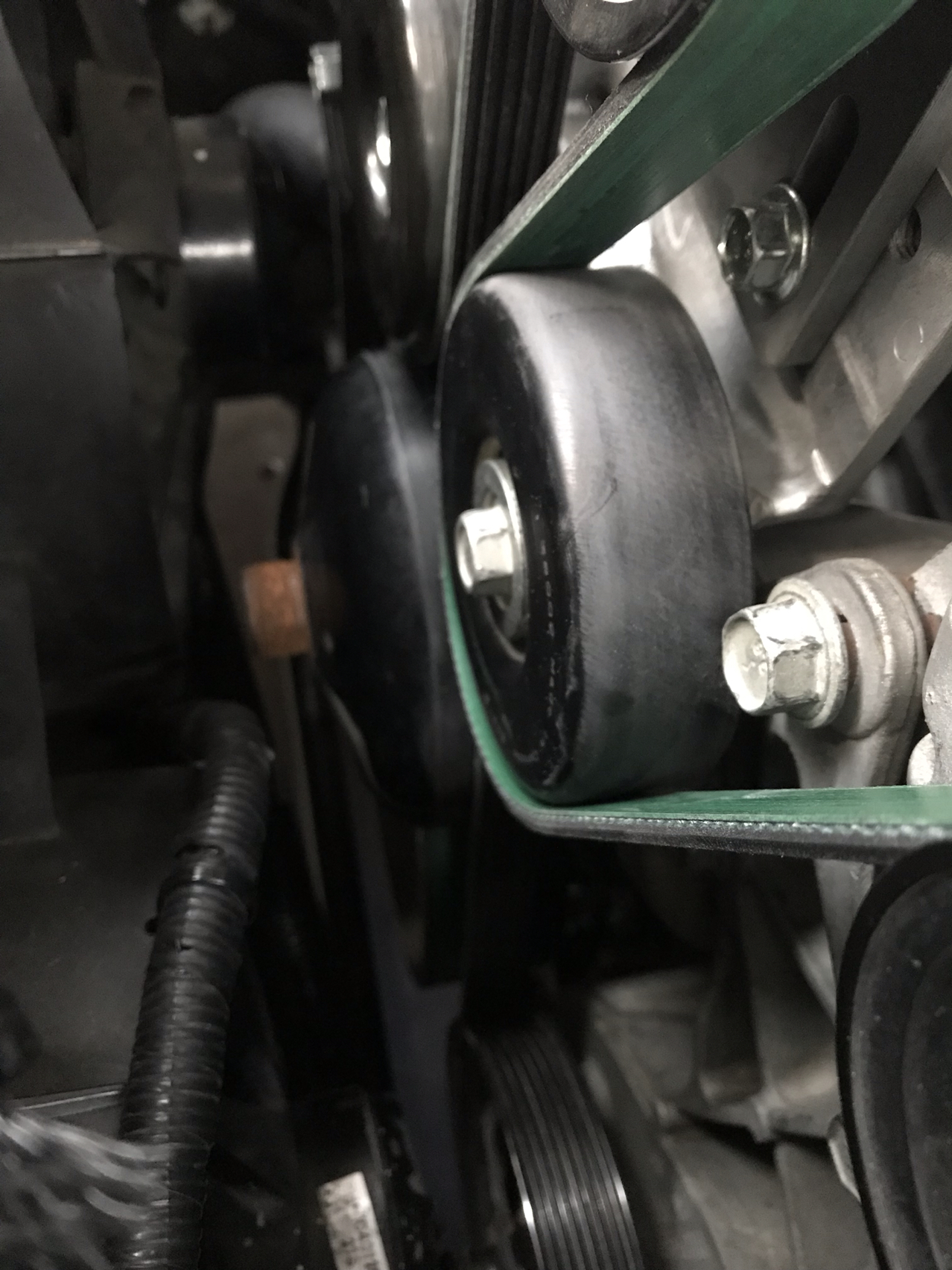

I'm thinking about putting a washer or three between the alternator bracket and the magnuson bracket?

Looks like the alt is the issue. I think your on the right track, that alignment makes my ocd twitch... Lol
