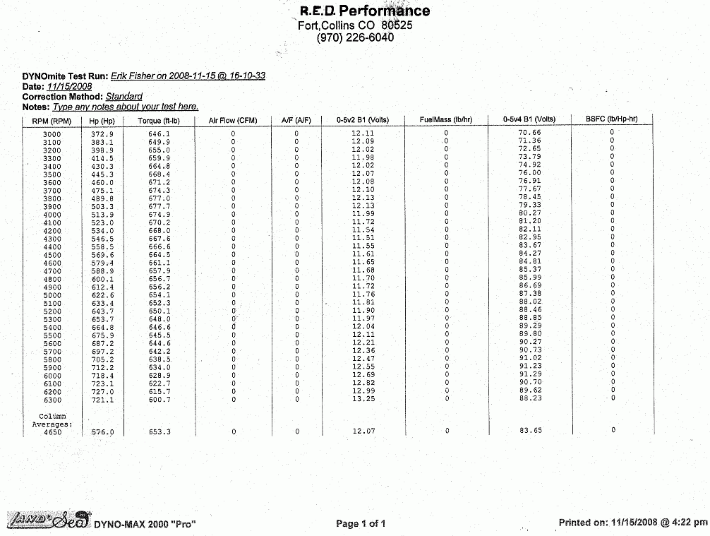

We went with a 228-236, 601/601 at 114 on a 408 with the 1900. I will post the dyno graph but the torque numbers were awesome, flat and strong averaging 653/lbs. The TVS puts out great torque.

Awesome pull right up to 6200....and TQ flat as a dinner plate. Must be a fun ride.

I am just now putting on the exhaust that we used in the dyno, pacesetter 1and 3/4 primaries into 3 in through and x-pipe and then two huge magnaflows. It is fun already but starting tuesday it should be increible. The TVS and this cam make a great combo.
