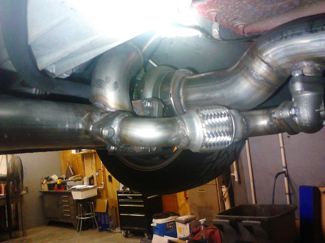

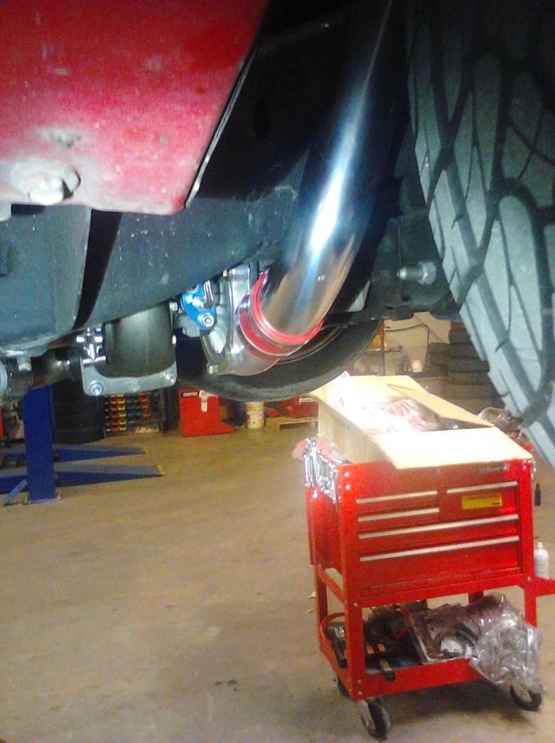

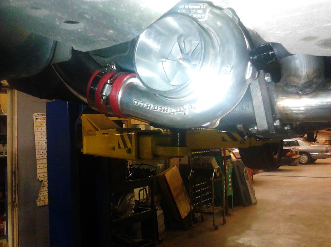

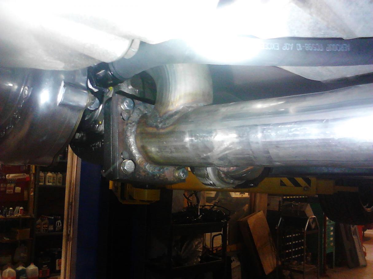

So im almost done with hooking everything up on this low mount setup.MUST say so the biggest prob so will be my down pipe is lower than the tranny cross member but ill figure that out some how. BUT my question is i still have two unconnected o2,s for the rear so what do u do with them just disconnect them or what. and will the truck run till i can get it programmed.

How is your dp lower then the crossover?
You loose the 2 rear o2's.

ILL be honest RICK im still trying to figure that part out. everything is bolted and turned the right way and i cat go up any further with the exhaust cause its just about touching tranny

You'll need to rotate your center section a little. So the drain is aim downward asynchronous as possible.
