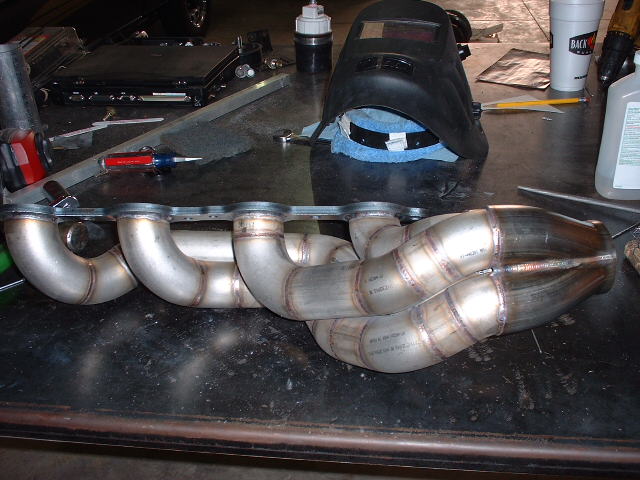

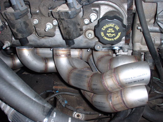

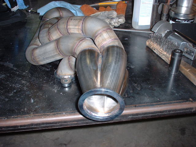

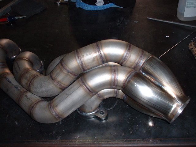

Here are a couple of pics of my turbo "kit" for my 2001 extended cab.
Headers are 8ga. stainless steel and i/c is a Garrett core 12"x24"x3.5" w/ custom endtanks. Turbo is a Garrett GT42.
Headers first
Attached Thumbnails turbo progress-driversidehdr.jpg   turbo progress-passsidehdr.jpg   turbo progress-passsidehdr2.jpg   turbo progress-passsidehdr3.jpg   turbo progress-passsidefin.jpg

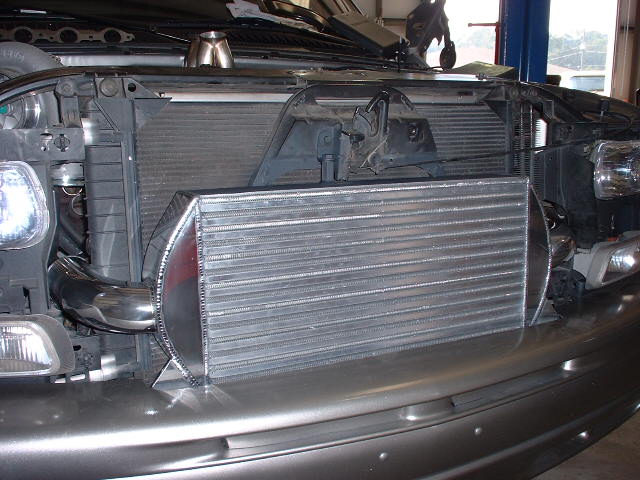

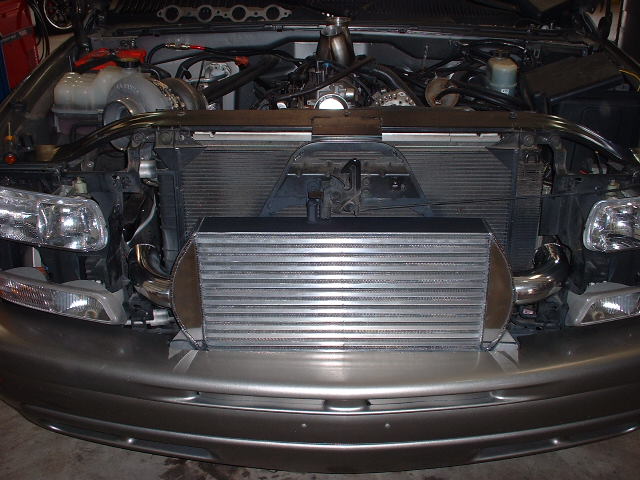

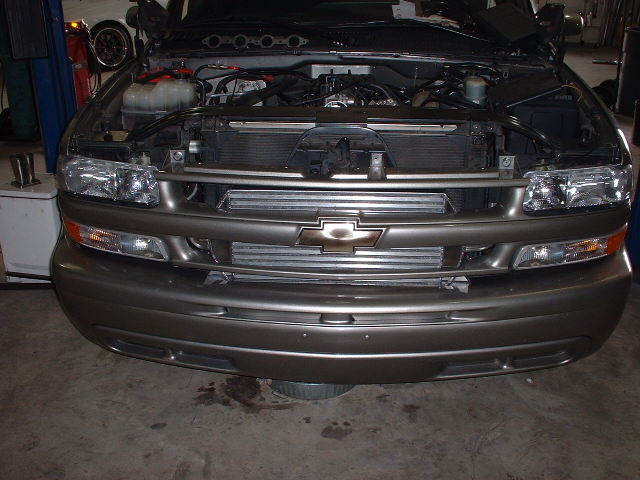

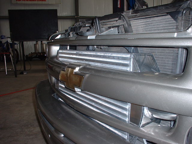

A few intercooler pics.
Attached Thumbnails turbo progress-intercooler1.jpg   turbo progress-intercooler2.jpg   turbo progress-intercooler3.jpg   turbo progress-intercooler4.jpg

hot damn! who's doing that welding? looks beautiful!

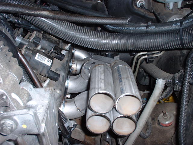

What are the specs on the turbo? That thing looks HUGE!
Nice job on the headers, how do you plan on doing the crossover pipe w/o it interfering with the intake plumbing?

Nice thick wall tubing on those headers too, should help you keep some heat in them! Can't wait to see it when its done.
The turbo is GT42, 102mm exducer. Capable of moving 98lb/min air
The crossover pipes will run "low" as to avoid the i/c pipe.
His name is Walker , a friend that works for me . He does awsome work as you can see.
