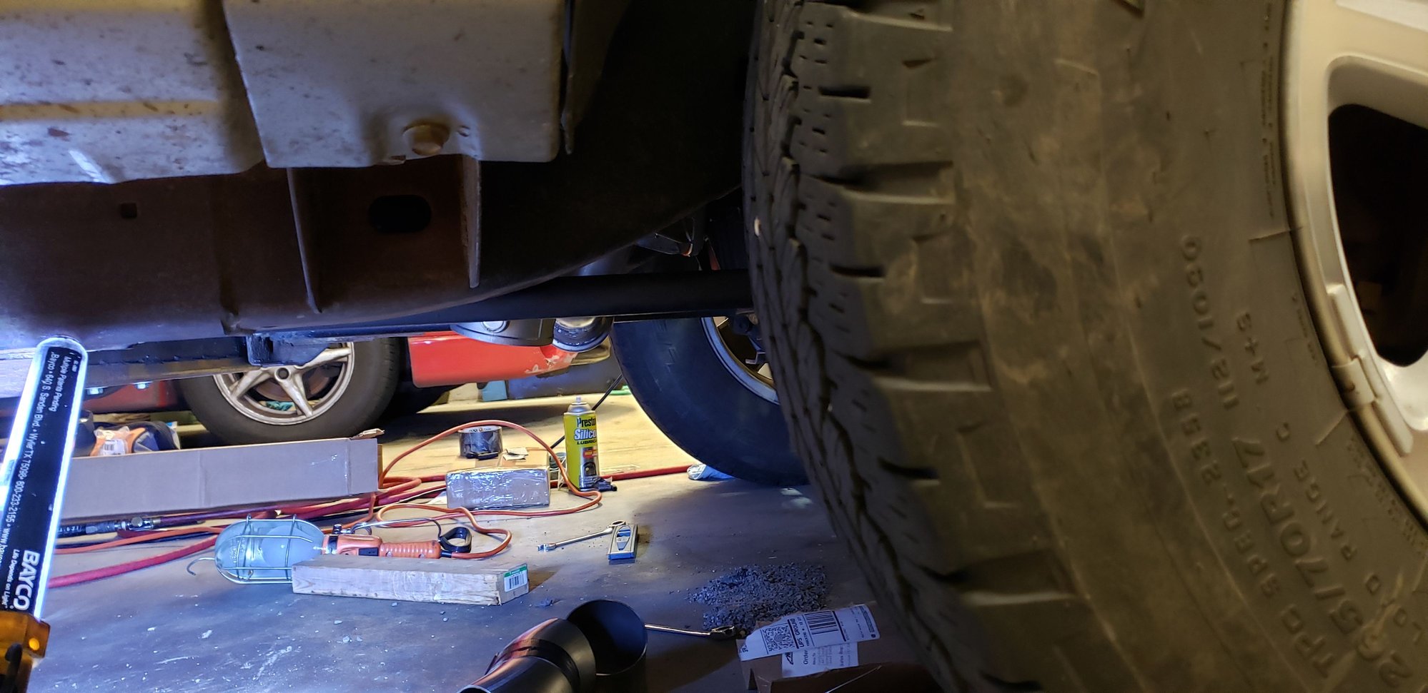

i'm running a vs racing billet 78/75 with a 3" downpipe since that's the size of the turbo exhaust outlet. i have a boost reference exhaust cut out *loudvalves* i built into my downpipe. see pic. i have the downpipe connnecting to my stock cat back for quiet idle.
installed in the truck my cut out exits just behind the rear of the front passenger side tire.
my cam is a 228/230 585 lift 112lsa elgin cam marketed by jegs. take a look at that cam or the summit stage 2 turbo cam. similar specs but reportedly better idle vacuum and a bit more top end. keep in mind i'm running a 5.3 and if you are using a 6.0 the cam will be a bit milder.
i'm using stock fuel rails and dekka 80lb injectors. i used nylon spacers and longer bolts to make up for the taller injectors.
fuel pump- a $100 walbro 450lph pump in the stock pump basket.
after i installed the new fuel pump my stock FPR couldn't control the fuel pressure so i switched to an external FPR. a pqy from amazon for $30. had to clip a few coils off the spring though. there is a guy on ebay that sells a block off for the rail mounted FPR. Atomic Fab sells one as well.
