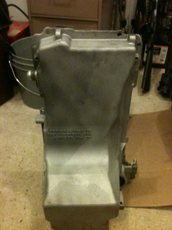

Got the feed and drain ready.
The pan is made from some weird aluminum i know that much. some kinda soft cast?
it sucked to weld haha
