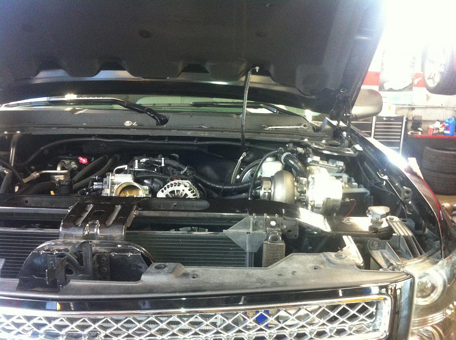

More fabbing

Stock cam and springs? It's probable floating the valves at that boost level or it has no timing in it.
I'd turn the boost down, lean it out to 11.2-11.5 and put a little timing in it.

Ok, contacted my tuner and he will adjust AFR. As far as timing, I'm at 12 degrees total, how high should I go?

Def think u are floating the valves. Do a cam swap w springs.

Ok then cam and spring swap it is. Any cam
and spring suggestion??? I am a Lead Technician at
a Chevrolet dealership so any parts that are GM, I can get
a great deal on..
