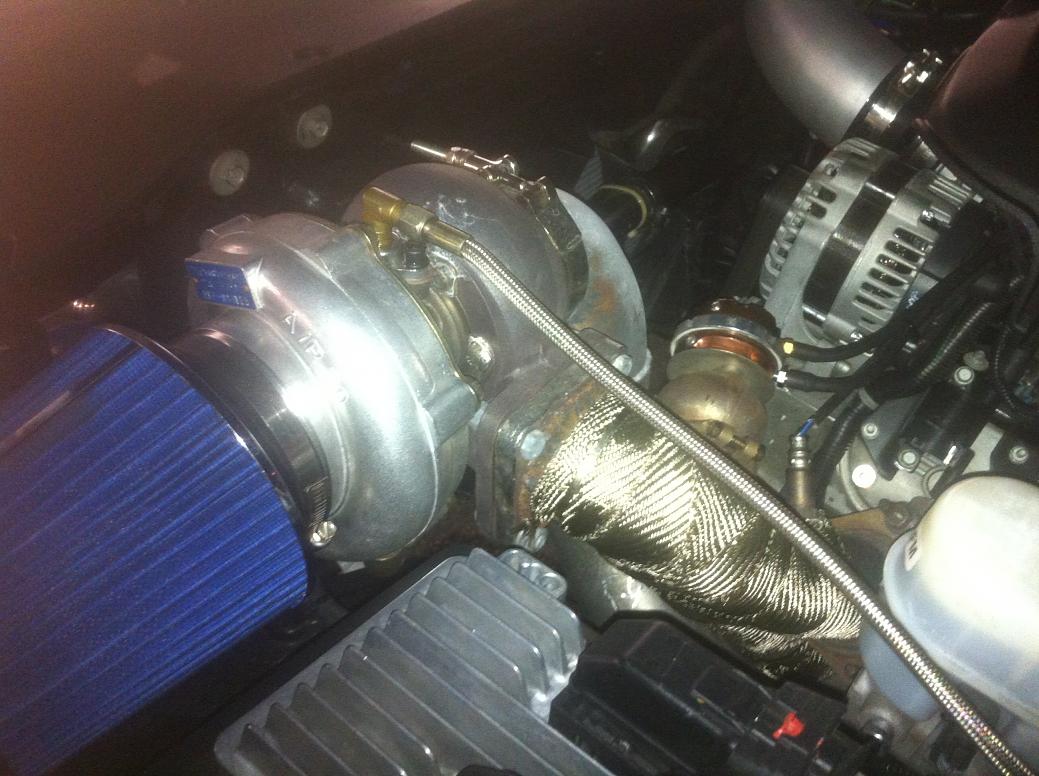

Here are some pics of the build

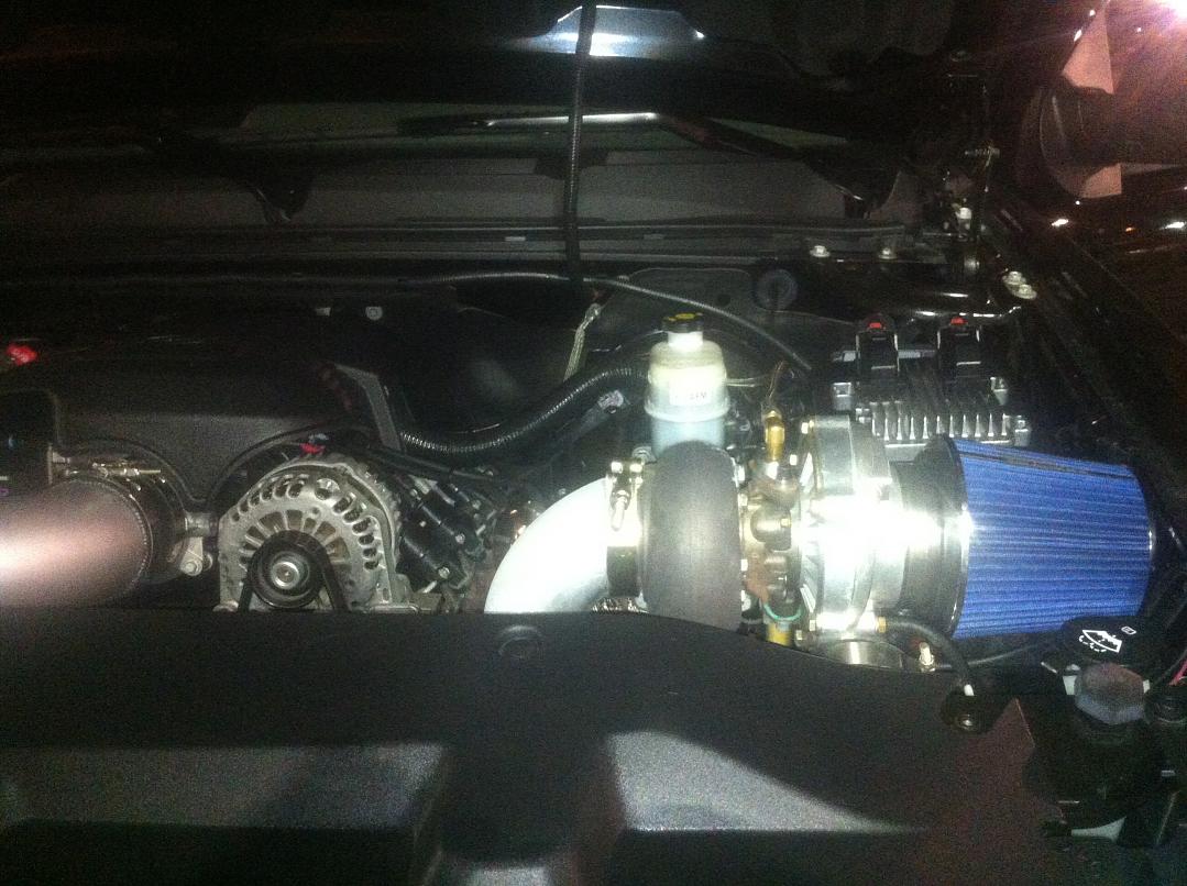

Pics.

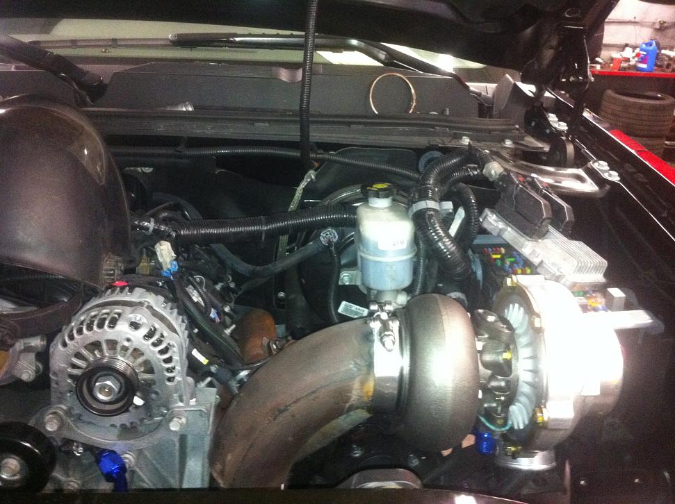

Finish stage

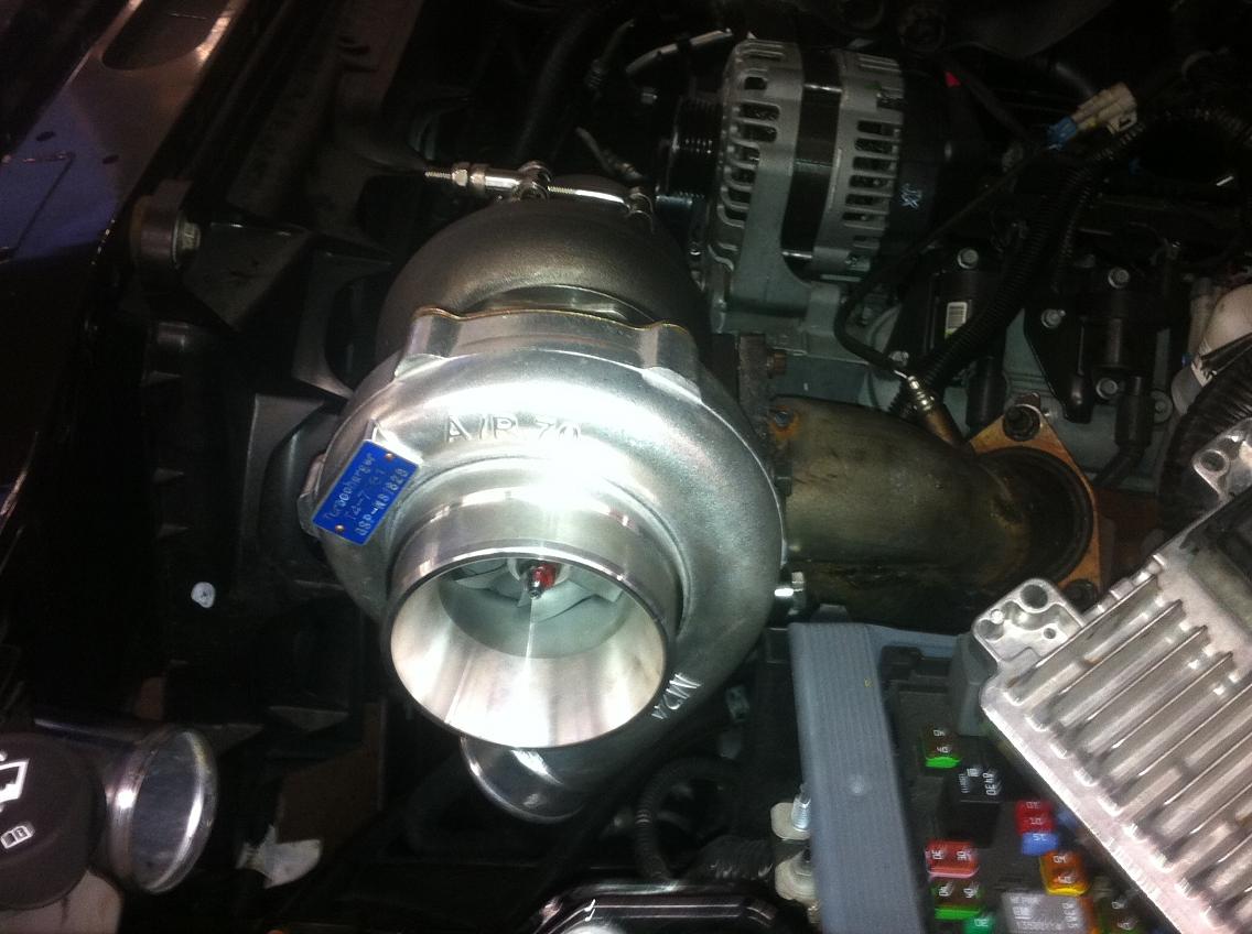

More pic

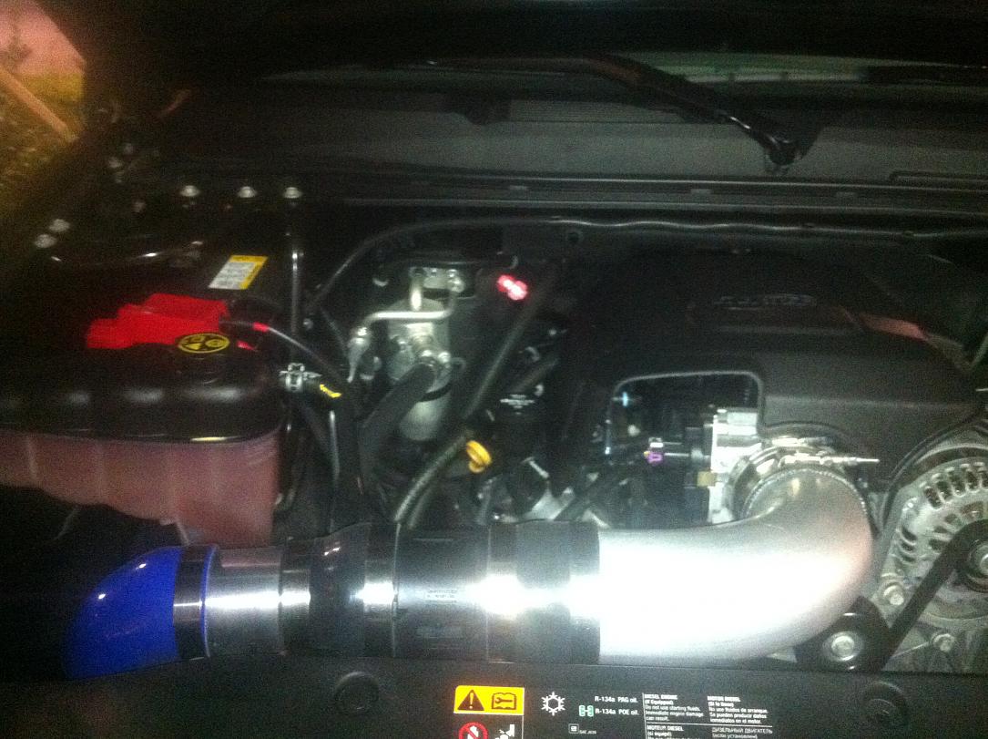

Fab stage
