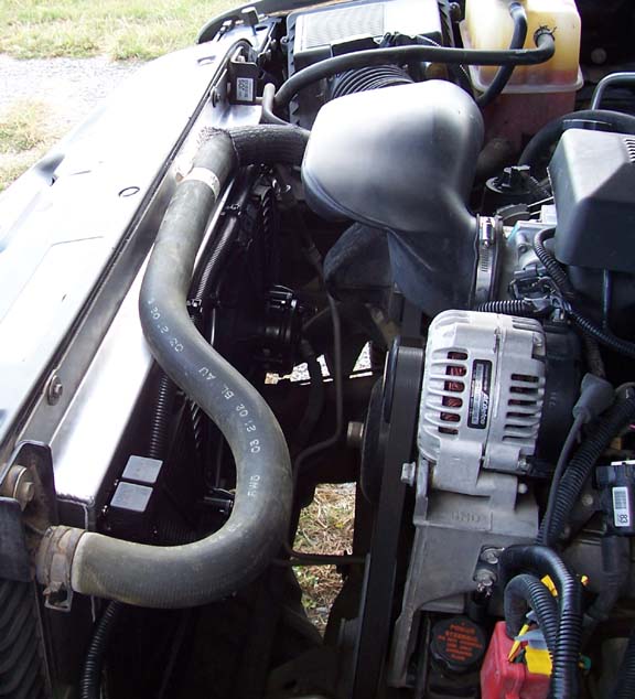

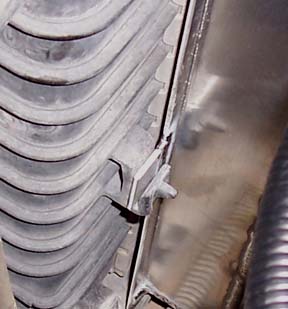

Ok we got the fan shroud finished up. It got delayed for several reason.
The 29" core is alot different then the larger 34". The hose necks are extremely close to the core leaving little to no room. So the first sample had to get tweek a couple of times.
Now we are really happy with the fit and these twin 14" pullers have no problems keeping this truck cool, just sitting with the a/c running for over 10 minutes after the test drive. You can feel the air getting pulled in at the grill.
Installs into the factory location, using the stock hardware.
Install time for the fan was under 30 minutes. Took a little while to find my 10mm socket. LOL

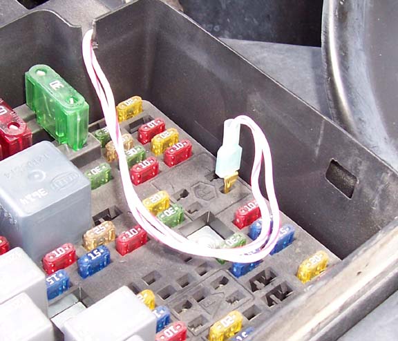

We used dual 30amp Bosch relays, wire loomed everything, and installed dual circuit breakers for protection. (They are the yellow covers in the pics.)
Right now the fans are just ON when the key is on.

Fans with NO relays will be 350.00 + shipping...
I will be heading to the dyno next week. Then the turbo will be going on.....
Rick
