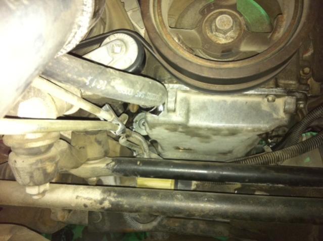

Go ahead and use se zip ties. And tie the oil drain line in place so it will not bump you ac compressor pulley or belt.

Thanks for the advice. It's already zip tied to the cold pipe going from the turbo to IC. So, that oil drain line will not move an inch from it's place.
Here is a closer pic although the zip tie is not showing in the pic.
