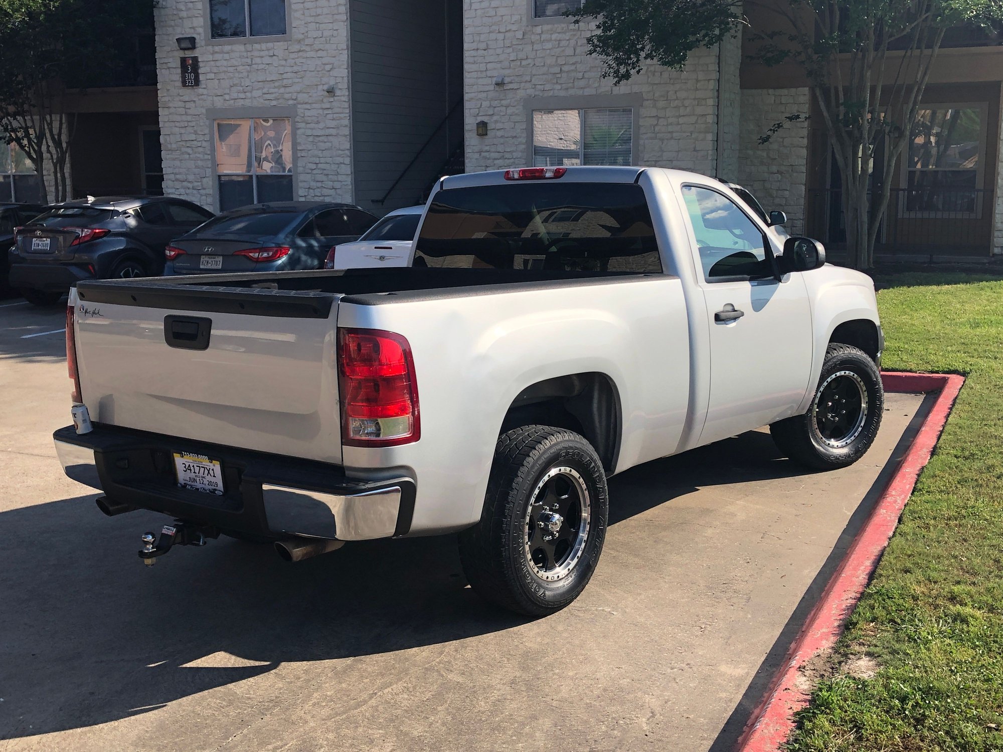

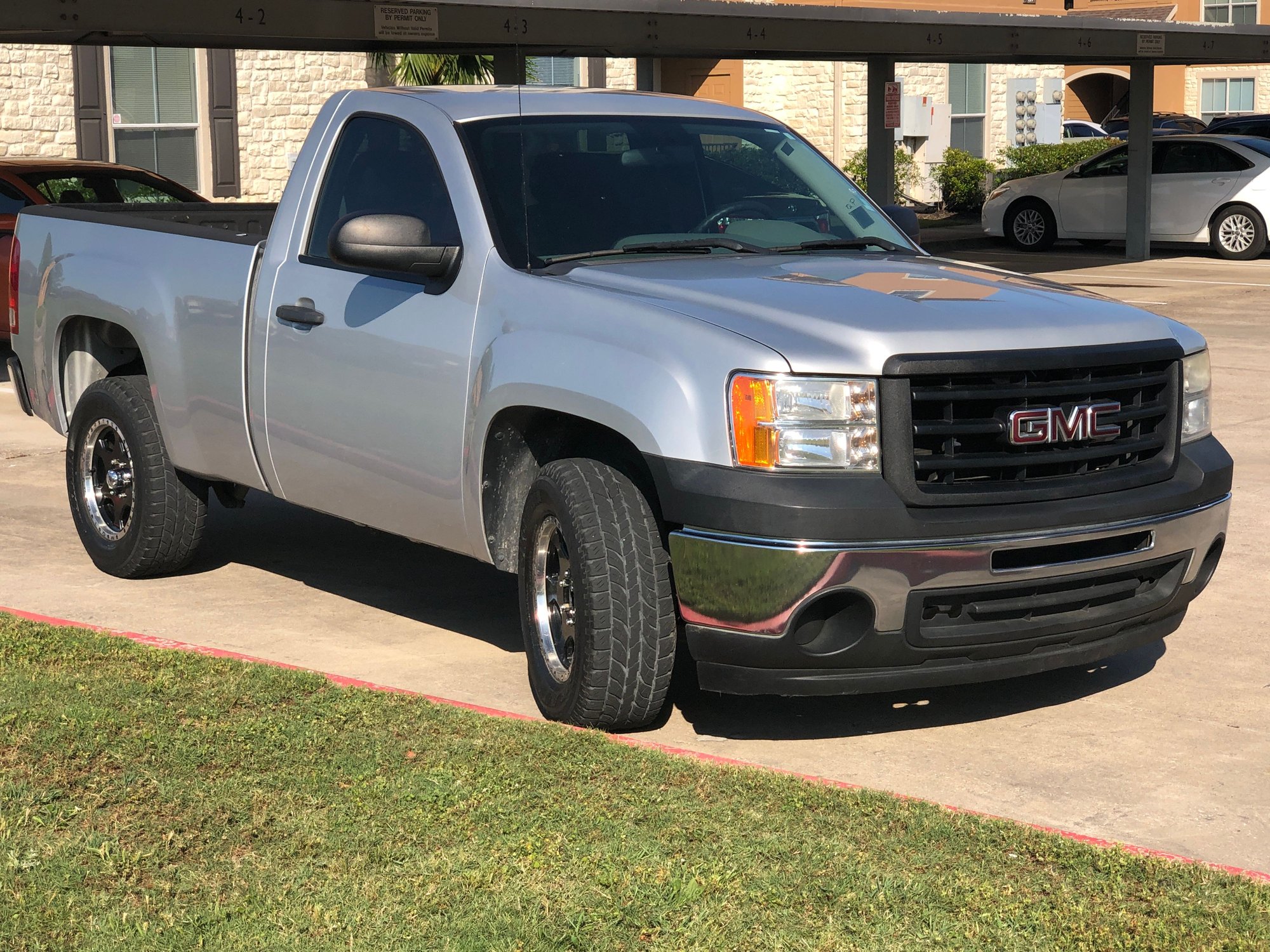

Pulled the trigger on a Trick kit... VS8375 turbo and meth.
Bone stock 2012 rcsb Sierra 4.8 ffv 2wd @111k
Zero modifications, though I have a TH400 and a 3800-ish stall sitting on a shelf, waiting for the rear end and drive shaft. Wheatley is supposed to be doing the first tune.
From what i understand- the injectors will be done around 450rwhp or so, then the pwm pump/fpr will be done about 550ish...
So besides a full trick kit+tuning, what do I HAVE to do to get my 2012 FFV 4.8 to the limit of the STOCK flex fuel system?
Thank you.
-Jake
