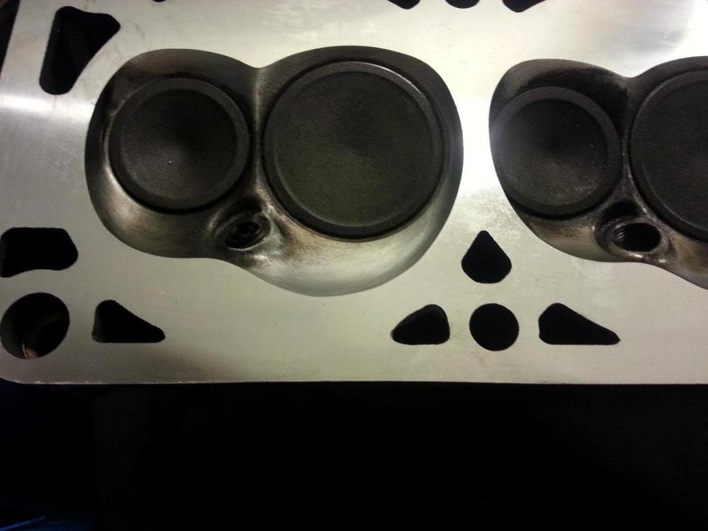

Sure, but that requires machining of the block for the reciever groove which means dealing with freight shipping and machine shops...no thanks. I talked to several people with way more experience than me (Brian at LME, Richard at WCCH, etc.) and they both agree I dont need orings, I just need to keep detonation out of it. I would much rather blow a headgasket and melt a head and give the pressure somewhere to go versus melting a piston. The headstuds I got are the CA625 ones that have a 100ftlb torque spec, something like 190,000psi tensile strength. The problem is not the heads being weak or gaskets not good enough...if it detonates its going to push water no matter what. Keep in mind this is just with a little 82mm turbo and I dont plan on changing that.
While we are on the subject, here is the head damage:Name:  IMG_3806Custom_zps93da0b05.jpg
And the repair by the same guy that did my turbo pipes:

That guy does badass work, top notch.

Nice looking repair that's great work .

Wow that head looks awesome. When will it be back together?
