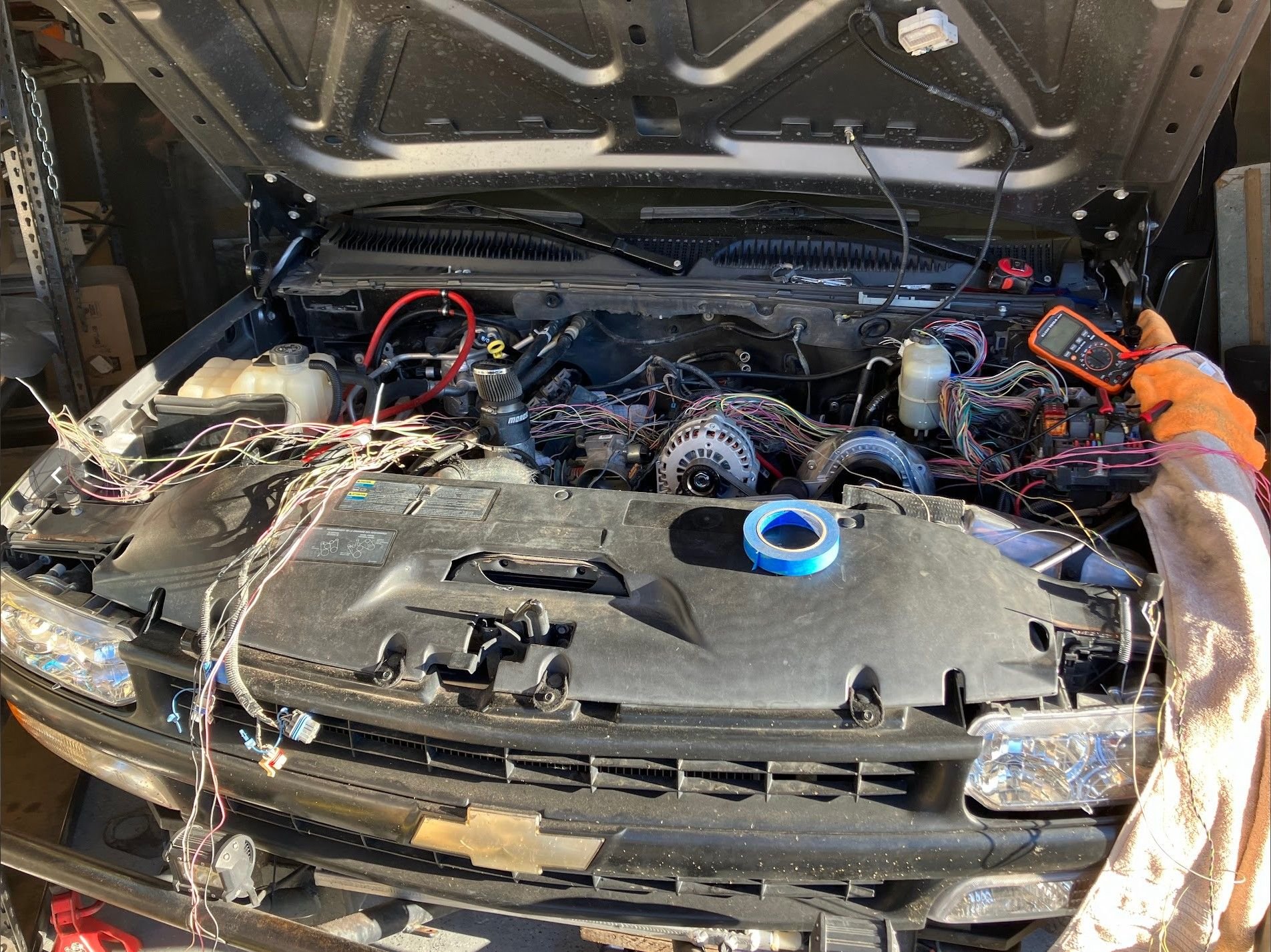

those of us with too much time on our hands would de-loom the whole *** harness and depin the unused wires and save them for later
Oh trust me its on the list to do, I have a ton that I need to rip out on mine.

I hope I don't have to tear into my harness quite that much for my build... I am planning to put in a Deutsch bulkhead though to run most of my custom wiring through. When the engine is out, lots of room for activities under there.
