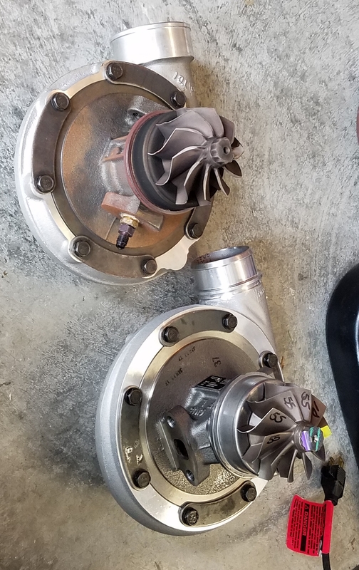

Originally Posted by 94heritage
Now I have no personal experience with this so I'm totally going just off of what i have read and seen. But you may not see any gain or actually a loss in performance. From what I understand the compressor side actually does flow a good bit more than the standard 66mm version. But the turbine side is the limiting factor. The sxe chargers run an full back turbine that helps with spool up. The standard version has a clipped back turbine and flows more air out. So the sxe turbine is actually a bigger restriction. Im excited to see
the difference though keep us updated.
They both had the same exhaust wheel, both were clipped too

Call me crazy... but they look slightly different to me... no?
the 69 looks like the fins protrude more toward the edge at the exducer?

They could be, when originally looked I didn't see much difference, I thought he meant by clipped was that bat edge along side.
