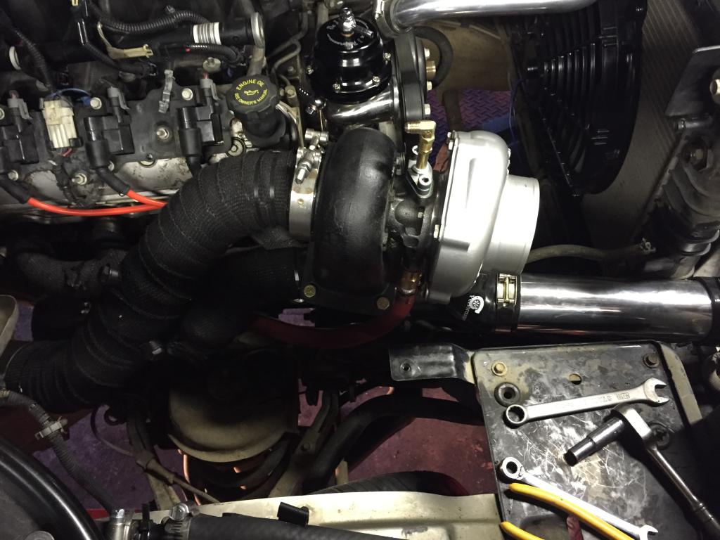

Crossover on and it took some work, i would suggest a friend help, and i had to take about half the end off so the threads could come through to get it started while i was squeezing it with oil filter pliers (which actually work pretty good lol)

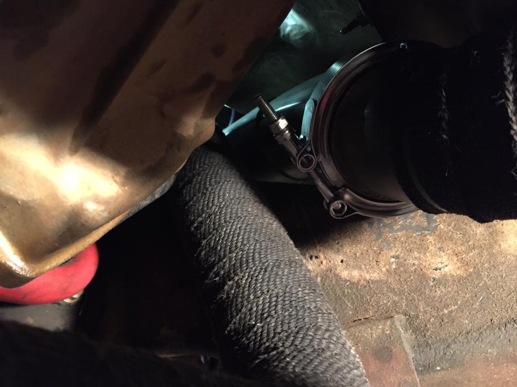

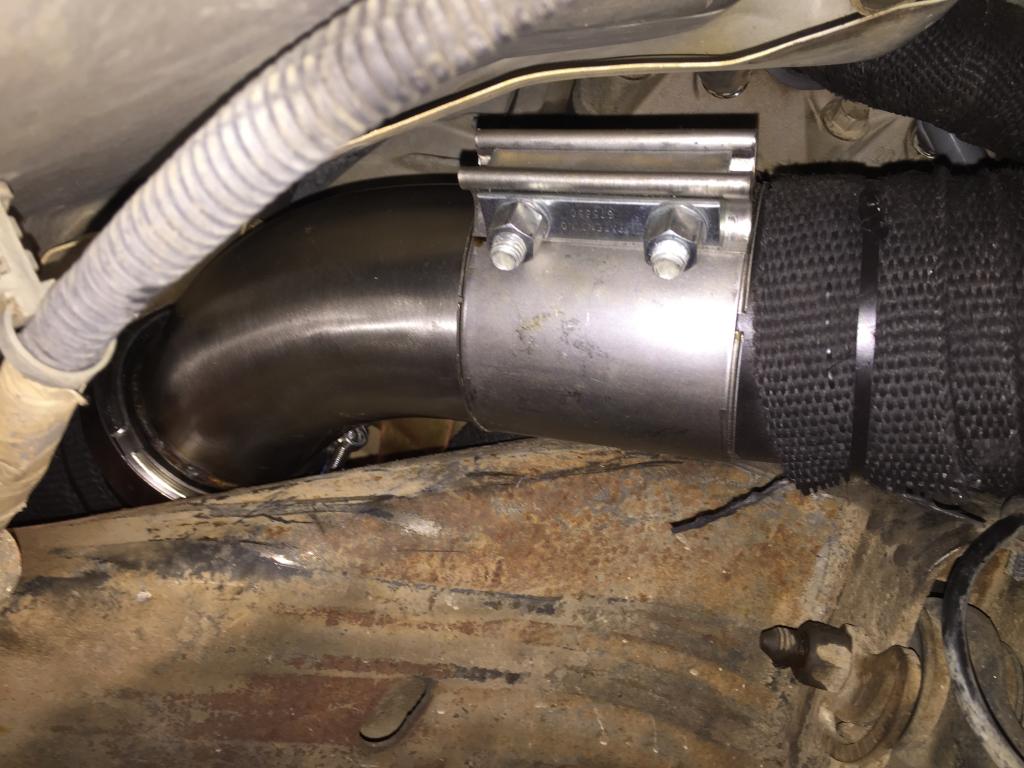

Downpipe actually all went very smooth and i was able to do that by myself, they do send the first downpipe from the turbo in two pieces so you can make the flange come down a lil bit further
I only got one 3.5" coupling in my kit, and you need 2 of them to put it all together. I used theres in the back part of the exhaust cuz it looked really cheap and flemsy, i bought a Torca exhaust sleeve clamp (item#TBS-350) to use on the actually downpipe cuz its way better, i think it was about $30

The Torca sleeve

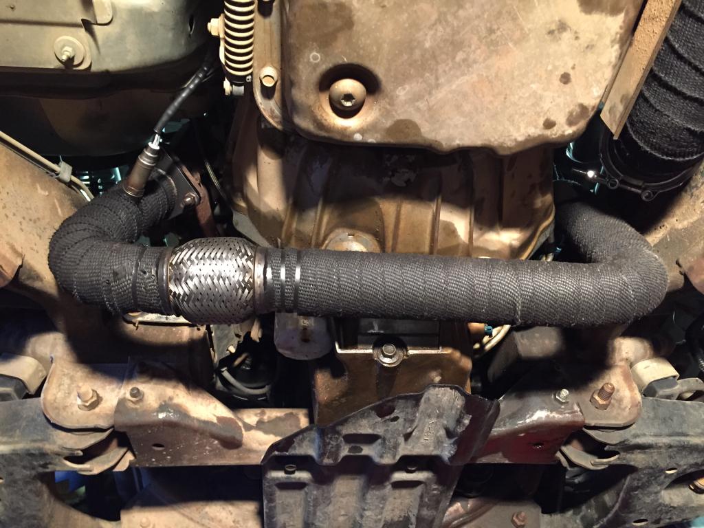

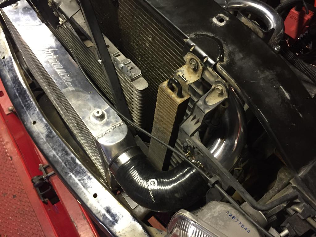

Mounted and started plumbing, first straight section was from the kit, i just cut some off on the elbow side to make it work
Front i just used to of the 90 elbows to go into the engine bay
Driver side i used another 90 from the kit to make it a straight shot to the TB
Now a heads up, they only give you 1 straight piece and its only 3" long, you need a 6" long piece to connect the blow off valve pipe with the elbow, i cant get one around here so i cut the piece that had a slight slant to it and made it work

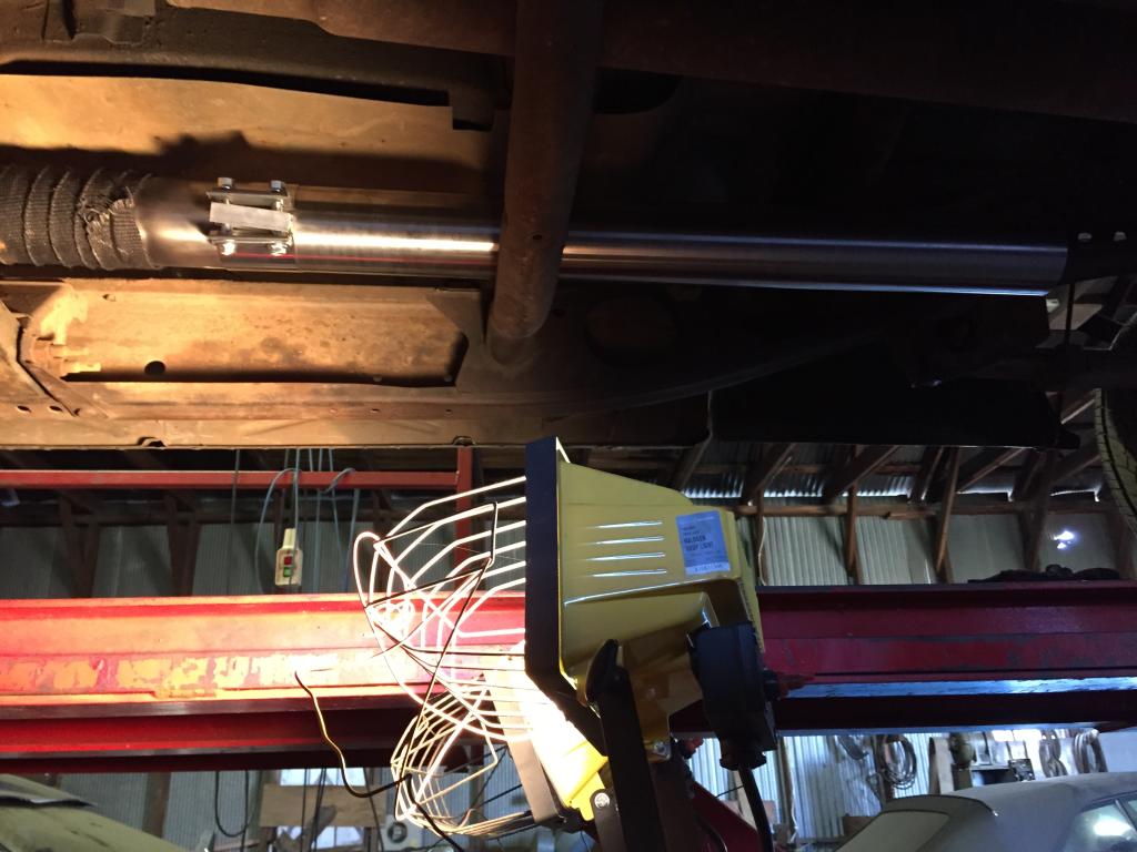

This is how far the exhaust goes from the kit, im prolly gonna put a elbow on it and go out the side at a downward angle

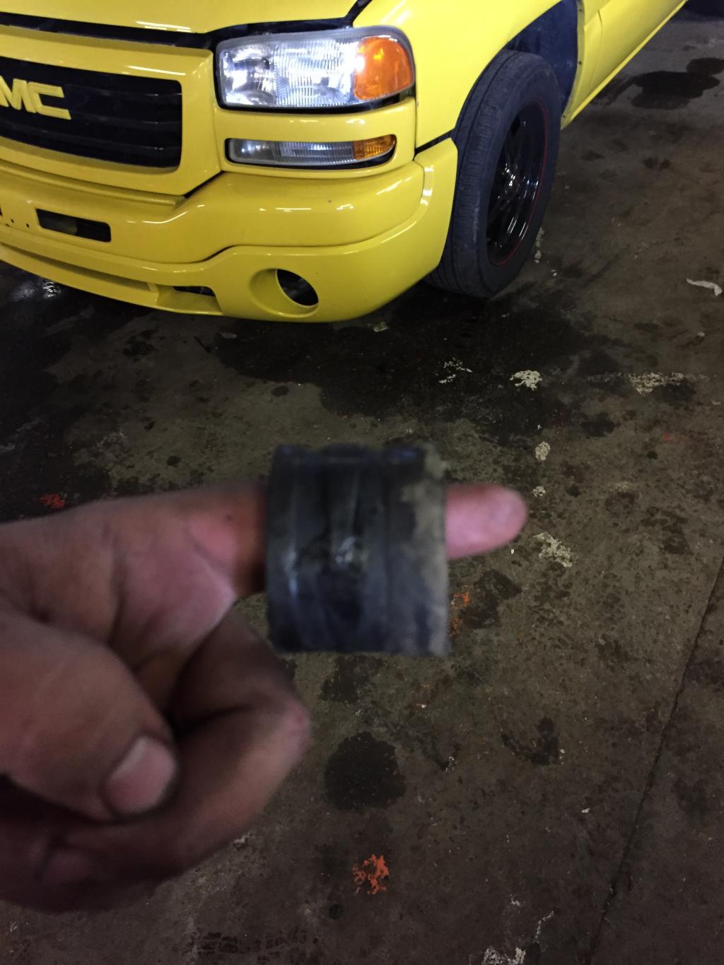

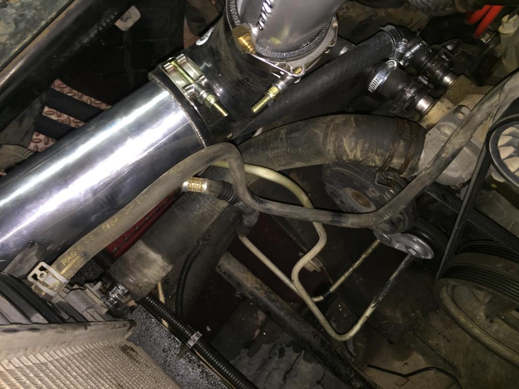

And another thing i wanna share, the elbow from the turbo wont work with the coolant hose right there, you cant keep your stock hose if you just do this to re-route it.
Undo it completly then cut about 1.5 or 2" off one end
Then take the end from you radiator and route it under the trans lines and put it on the motor, and then the one from the motor goes to your radiator

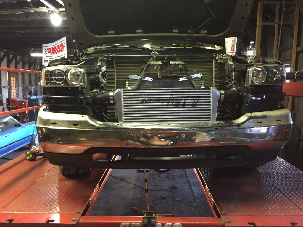

Originally Posted by GRRR65GTO
You should do some reading up. Intercoolers behind 99-02 grills take a little bit of work to make fit. For example in my truck i moved the radiator and condenser back about 2 inches and everything fits good now
Its not that, it was more less that i called and asked them about it and i was told that there was no way it was like that

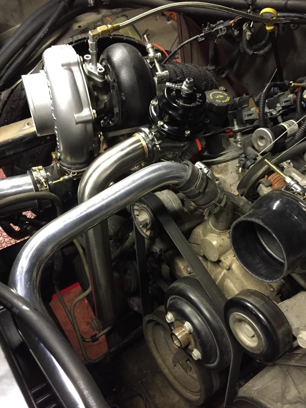

Got wastgate on, meth tank mounted, over flow tank mounted, and some gauges done, hopfuily will be wrapping it up tomorrow and get it on the dyno, i have there LS 2 bar for SD, not running a muffler or A/C
