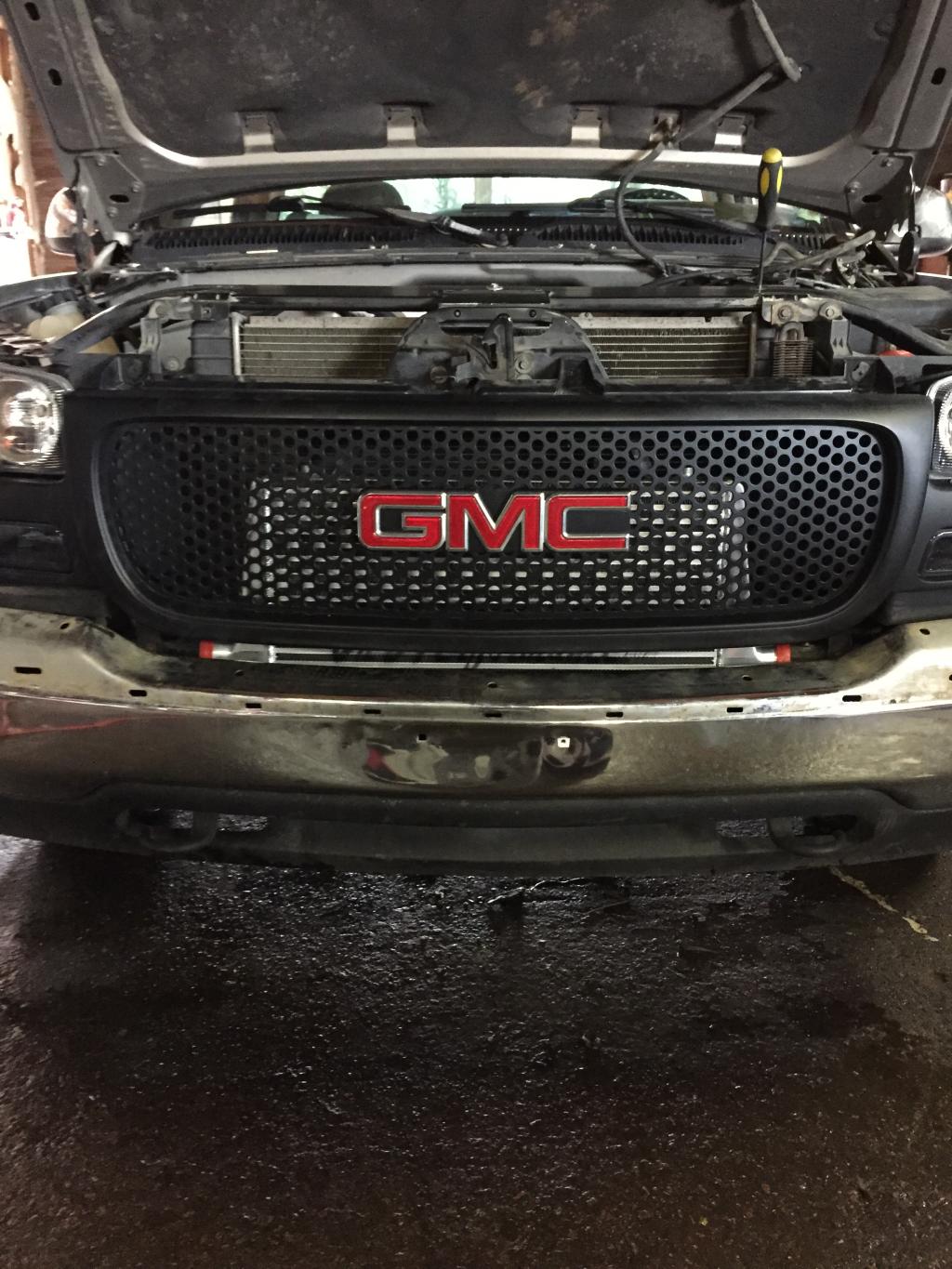

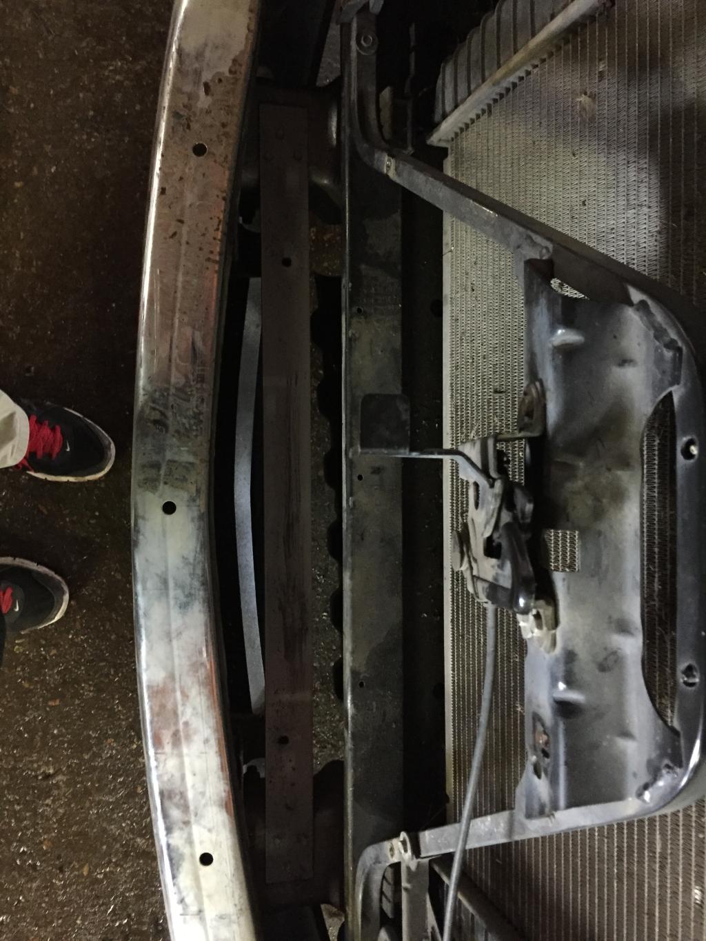

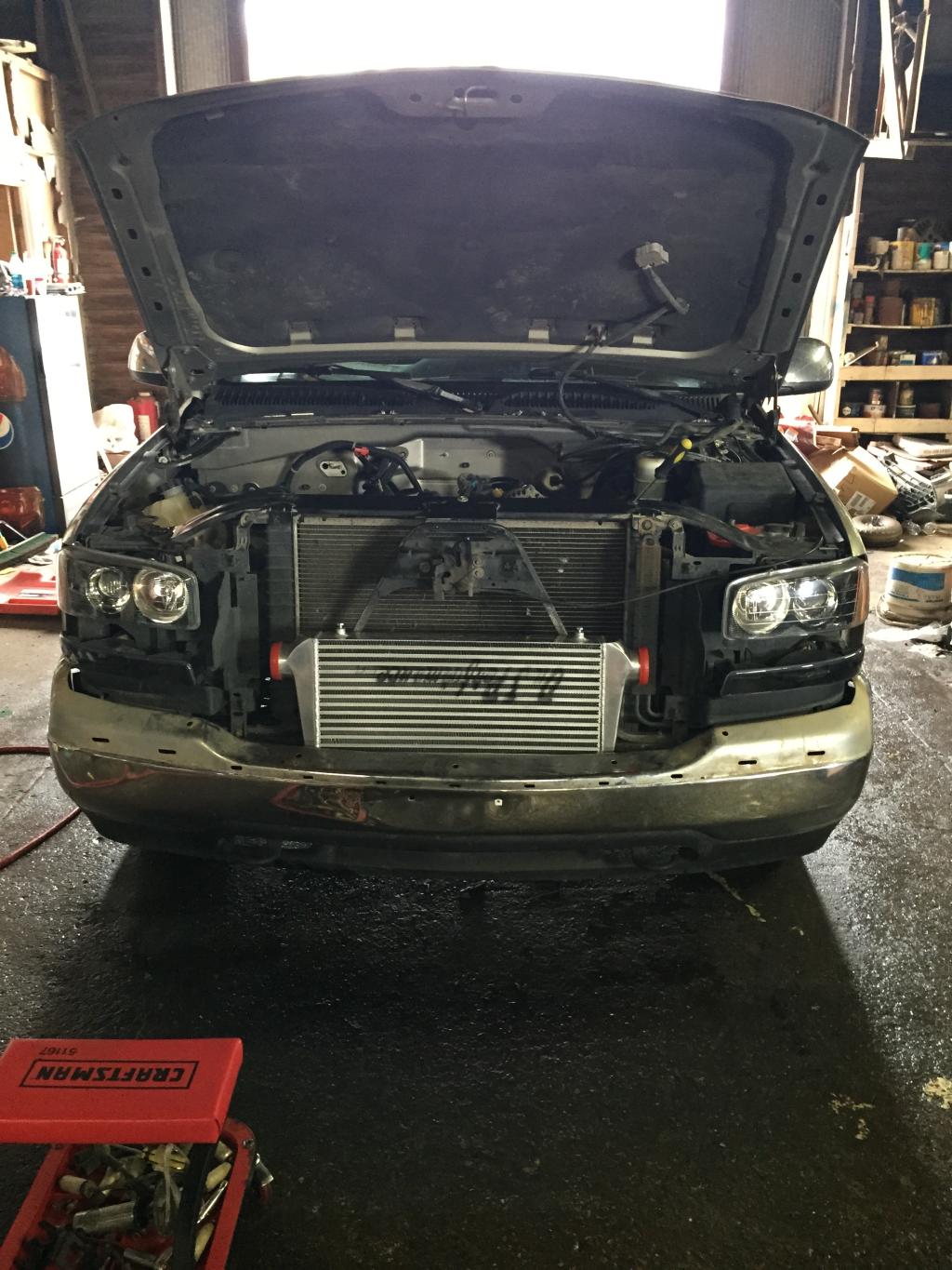

Started my 0n3 kit install on 99 sierra

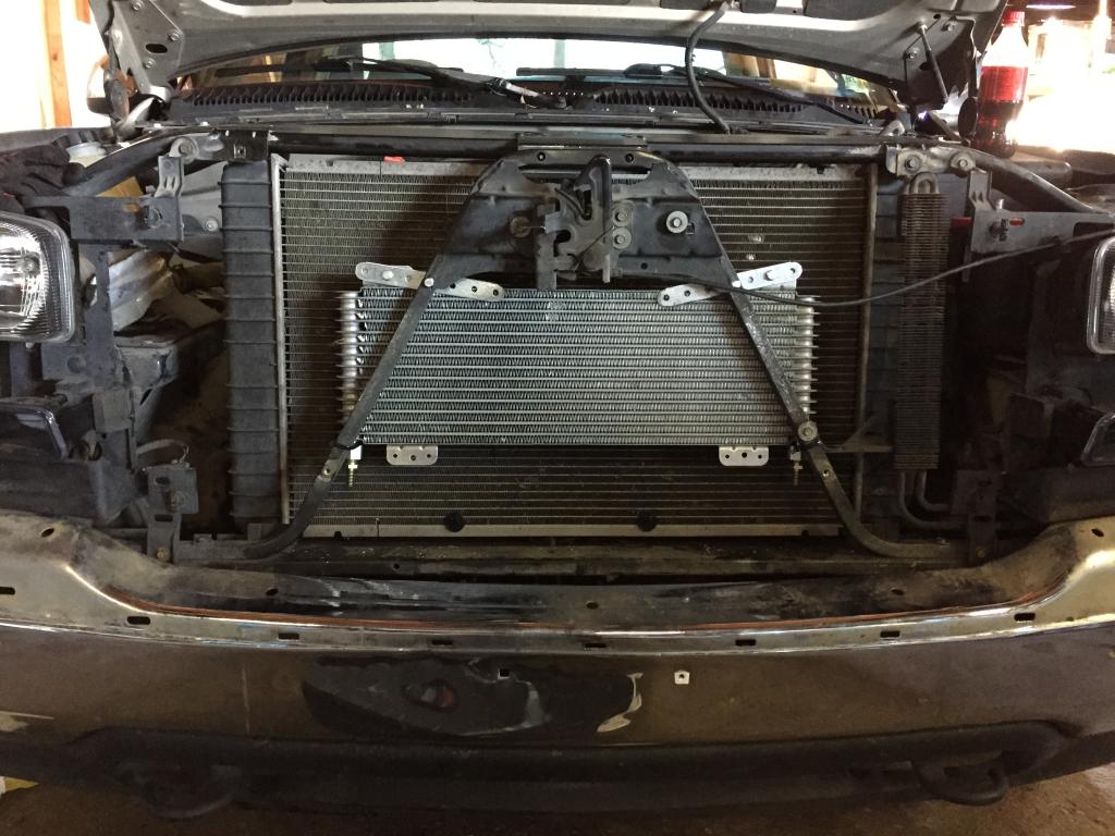

Old Mar 4, 2015 | 02:24 PM
08lambochevy's Avatar
Joined: Aug 2012
Posts: 247
From: Louisiana

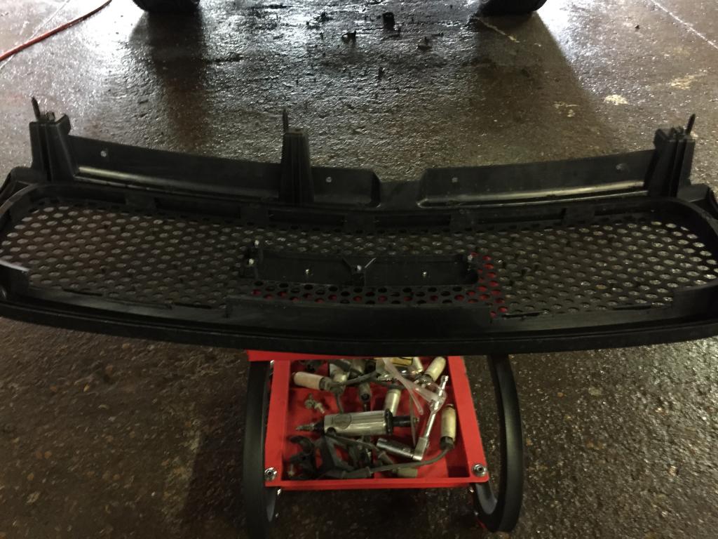

This is what i had to trim out the bottom part of the grille to get it to go all the way in and have about a **** hair of room between the intercooler, and this is there 3" basic intercooler

The craftmanship is real good, all the cutting and fitting took alot of time but i went ahead and put in some ls6 springs, ive read alot of bad reviews on the injectors so im just gonna put a set of siemen deka 60's in the first time to make sure theres no fueling problems.
But as far as the intercooler problems, if you have the 03-06 silverado then you shouldnt have any problems.

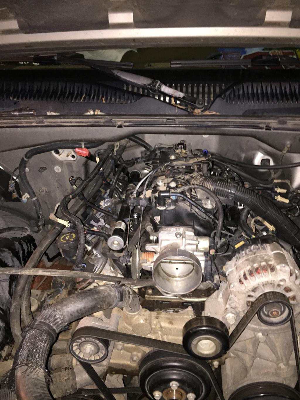

Intake installed and everything hooked up

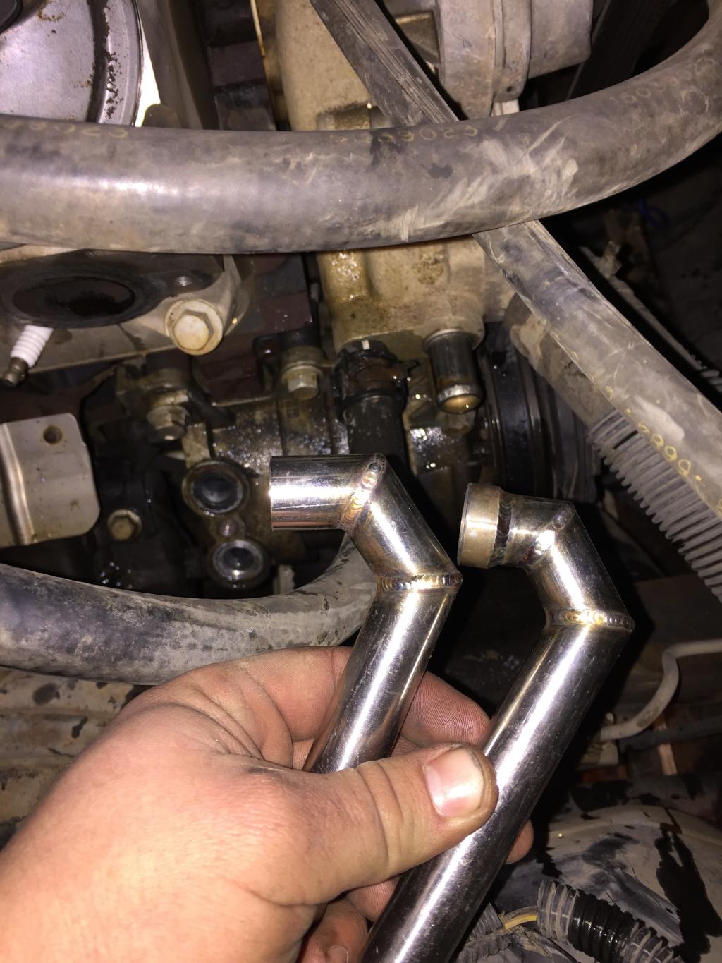

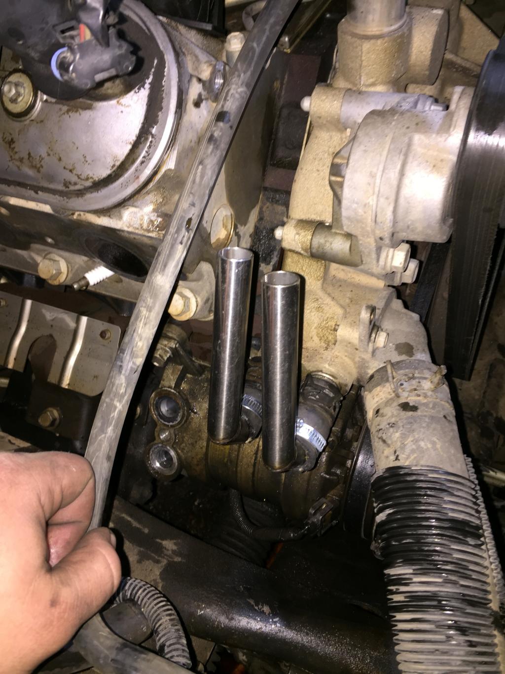

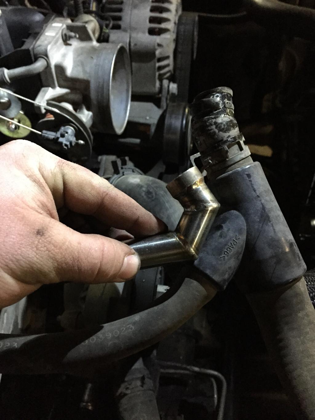

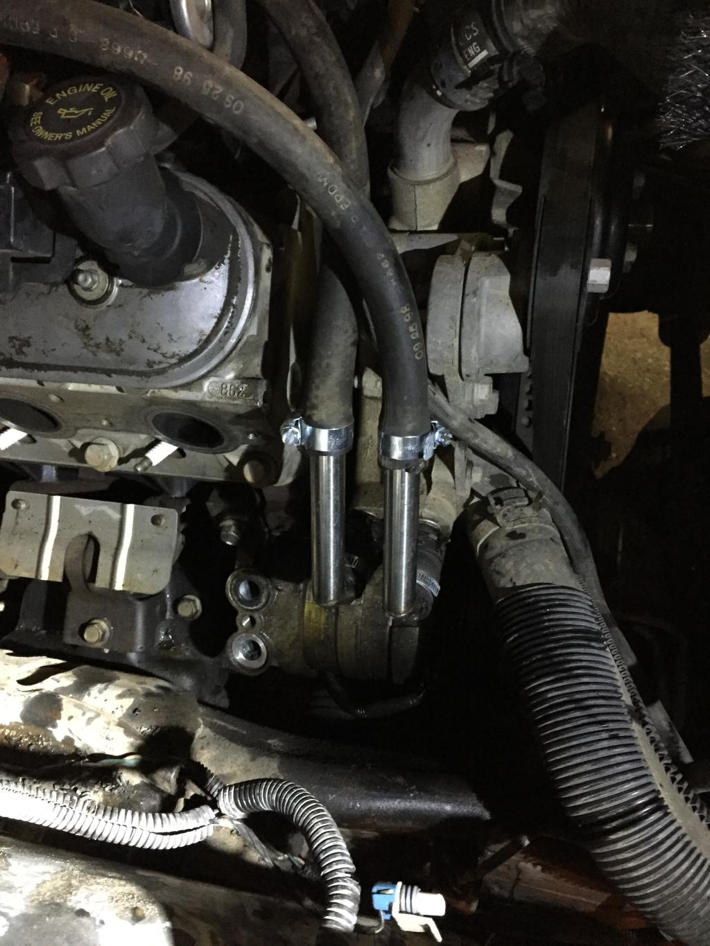

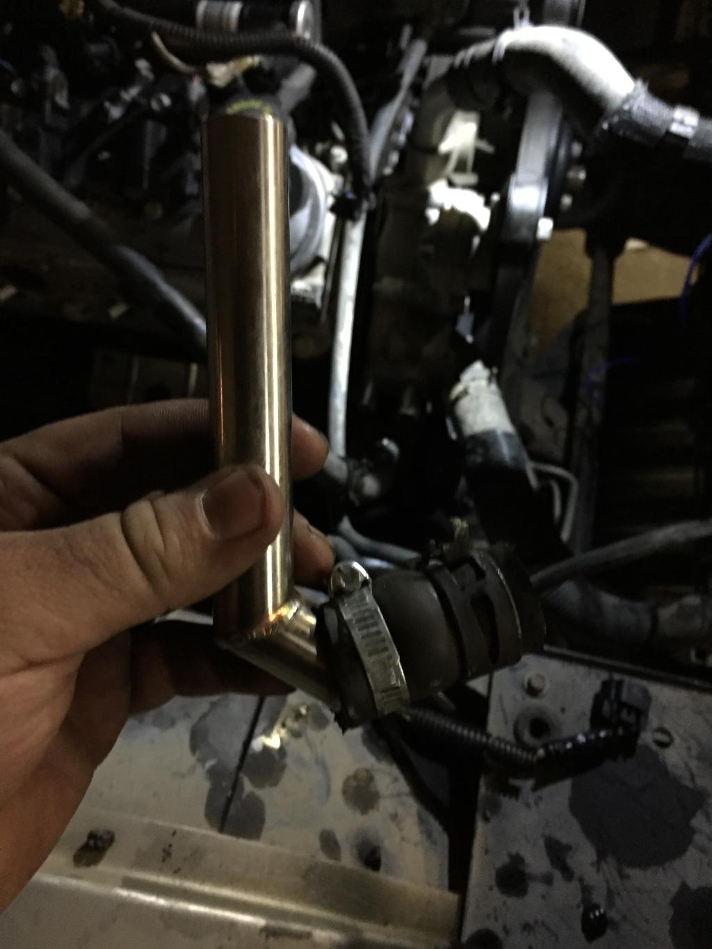

Next few images are of the heater hose relocation pieces Name:  AF802115-1070-4761-88D3-650A5B69FD07_zps8lhnhilo.jpg
As you can see theres two different pieces, one with the lip is for the bigger hose as shown

Another member had to notch his frame to get the WG tube to fit.
The nipple from the TB to the passenger valve cover needs to be capped off.
The issue with the intercooler is not specific to ON3/china - other kits put the IC between the frame rails down low.
