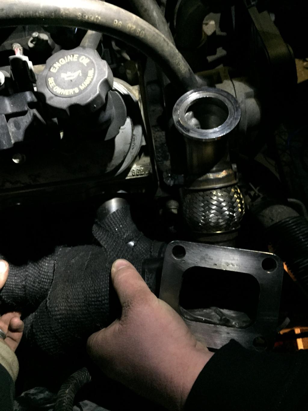

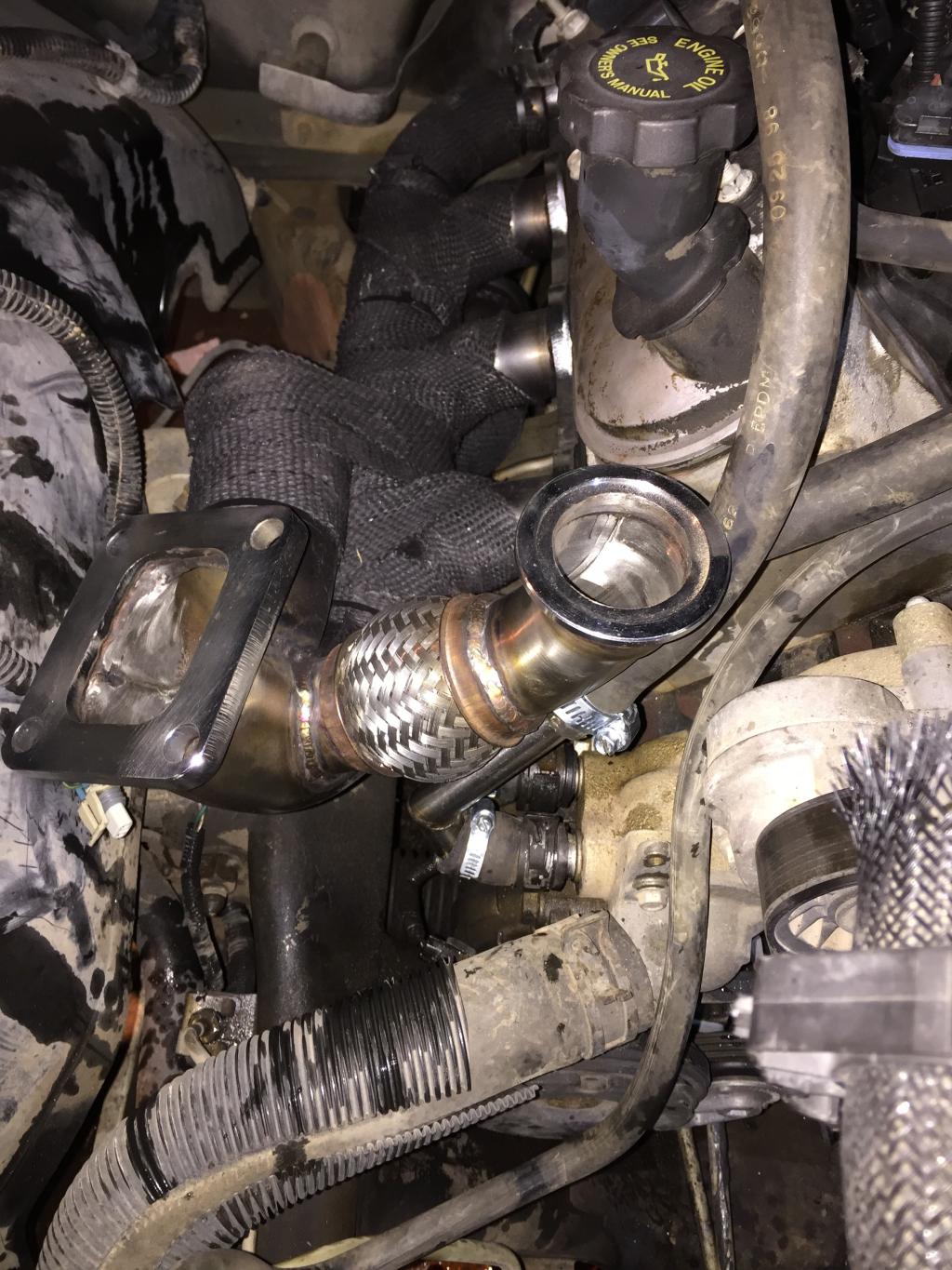

Wanted to mount my manifold up with i noticed the wastgate flange pushes on the heater hose and metal pieces, so prolly gonna re-route them a different way tomorrow

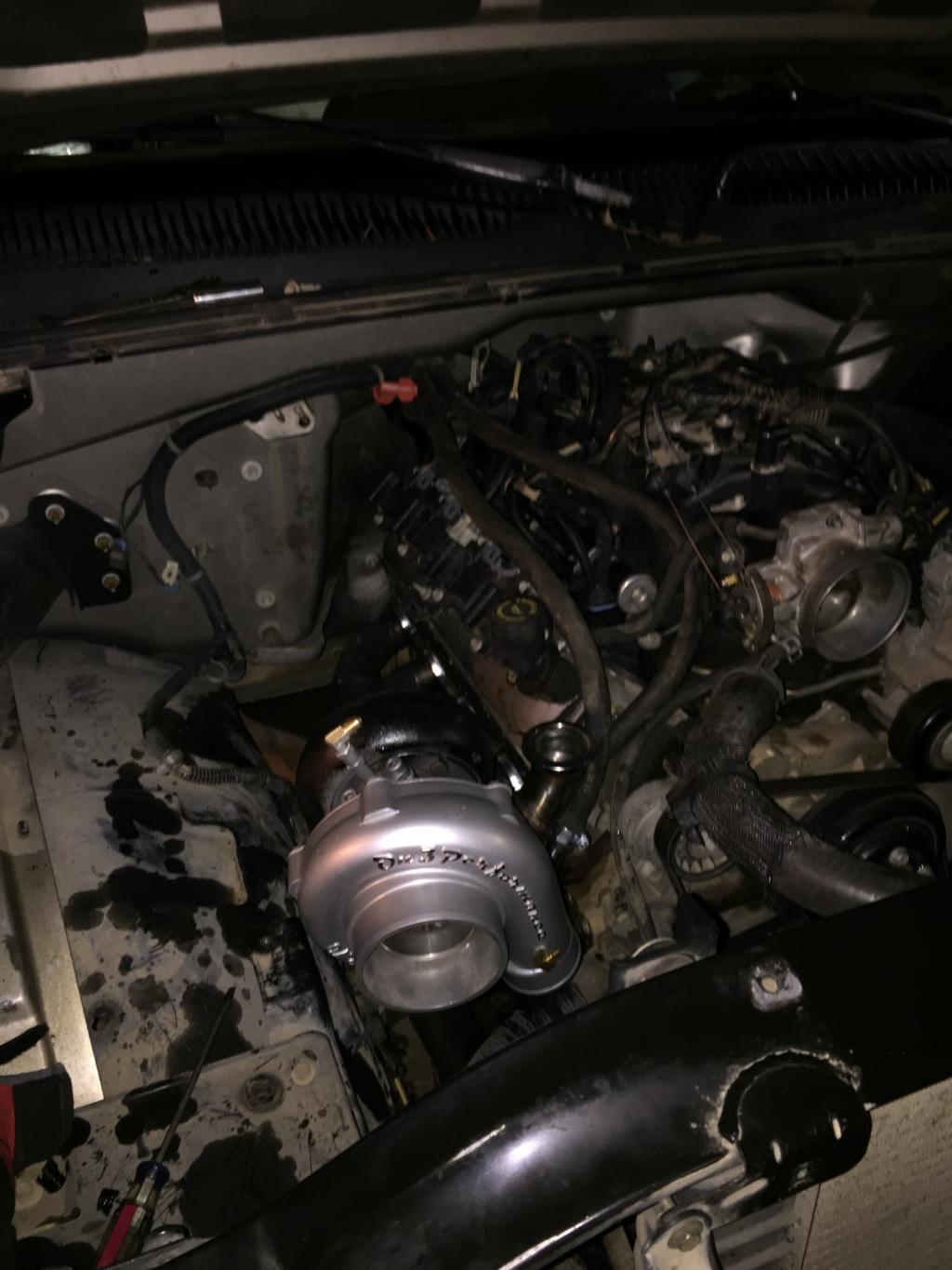

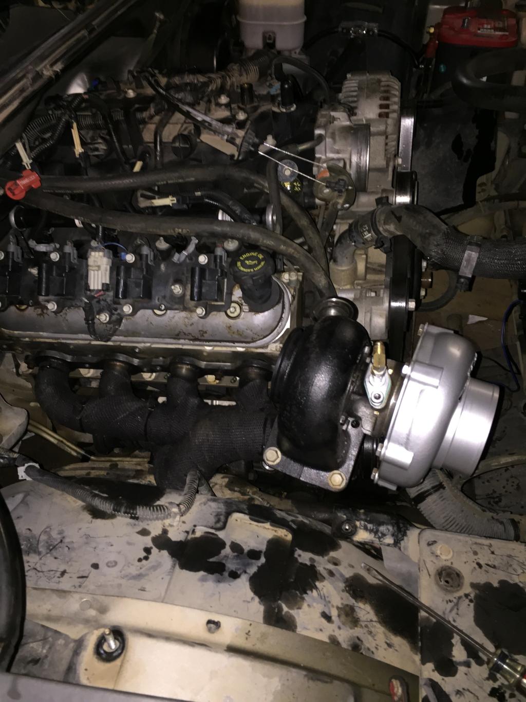

Wanted to go ahead and mock up my turbo (70mm ball bearing), it sits lower and a lil more crooked than i would like but thats just my opinion

Old Mar 6, 2015 | 05:47 AM
  #23
Choda's Avatar
Joined: May 2012
Posts: 2,781
Likes: 62
From: Buffalo NY
Keep going buddy. But man I think you should re wrap that manifold. Go all the way up to the flange.

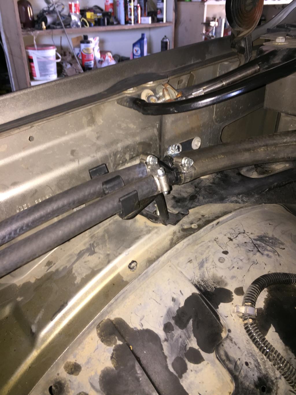

Why not route the heater hoses on the passenger side fenderwell?
Yea i was lookin at that, idk why i didnt do that

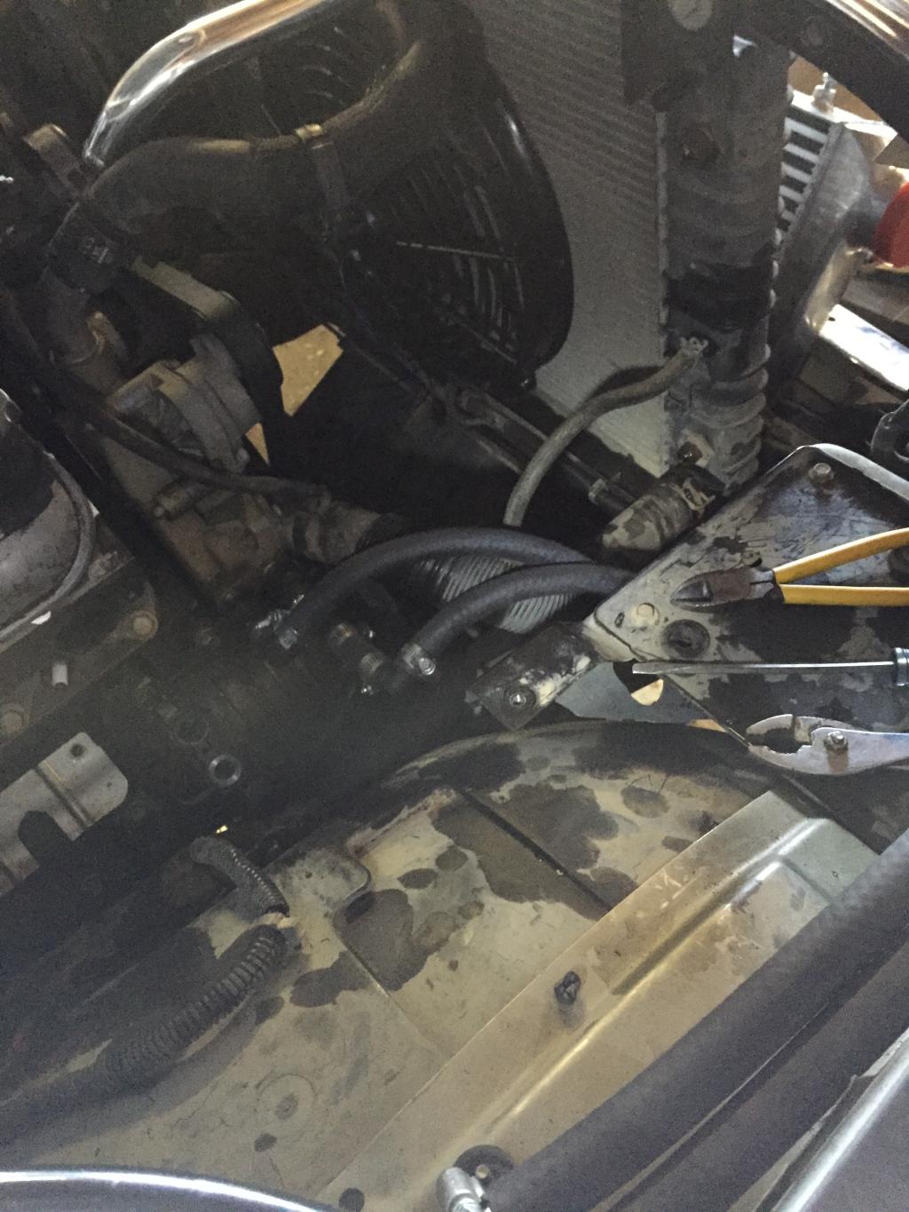

Thats what i was gonna do, but lookin at it, its still gonna be on the manifold now

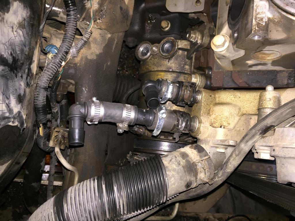

5 couplings and 10' of 5/8 hose, i was able to re-route it down under the air box plate then back around, and also you can use the hose bracket if you want, just mount it to the stud from the overflow tank

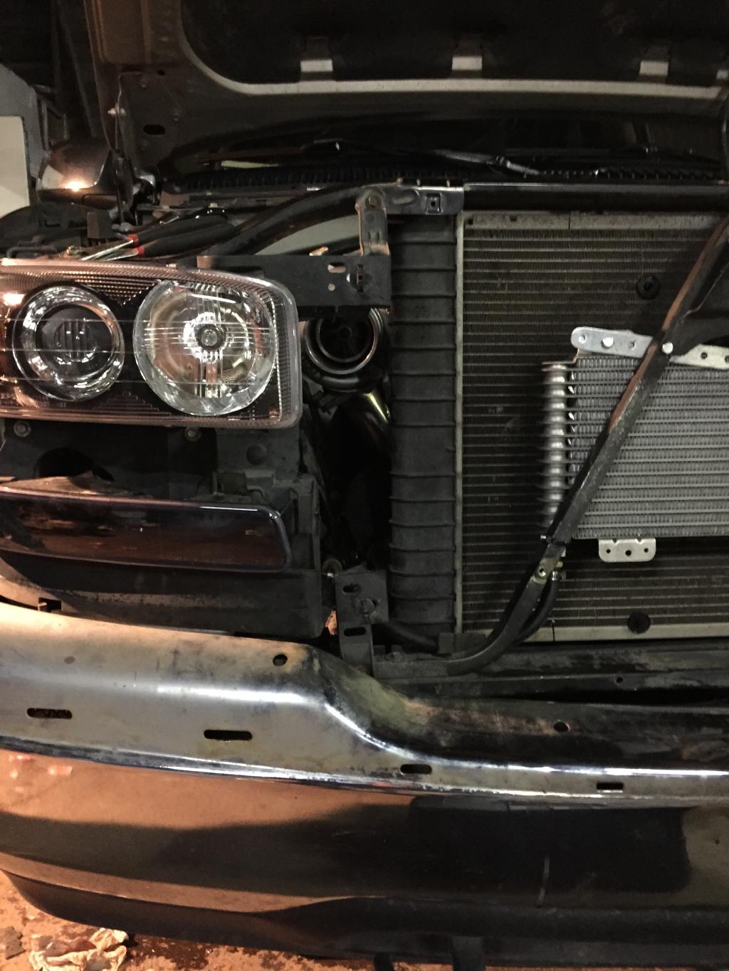

You should do some reading up. Intercoolers behind 99-02 grills take a little bit of work to make fit. For example in my truck i moved the radiator and condenser back about 2 inches and everything fits good now
