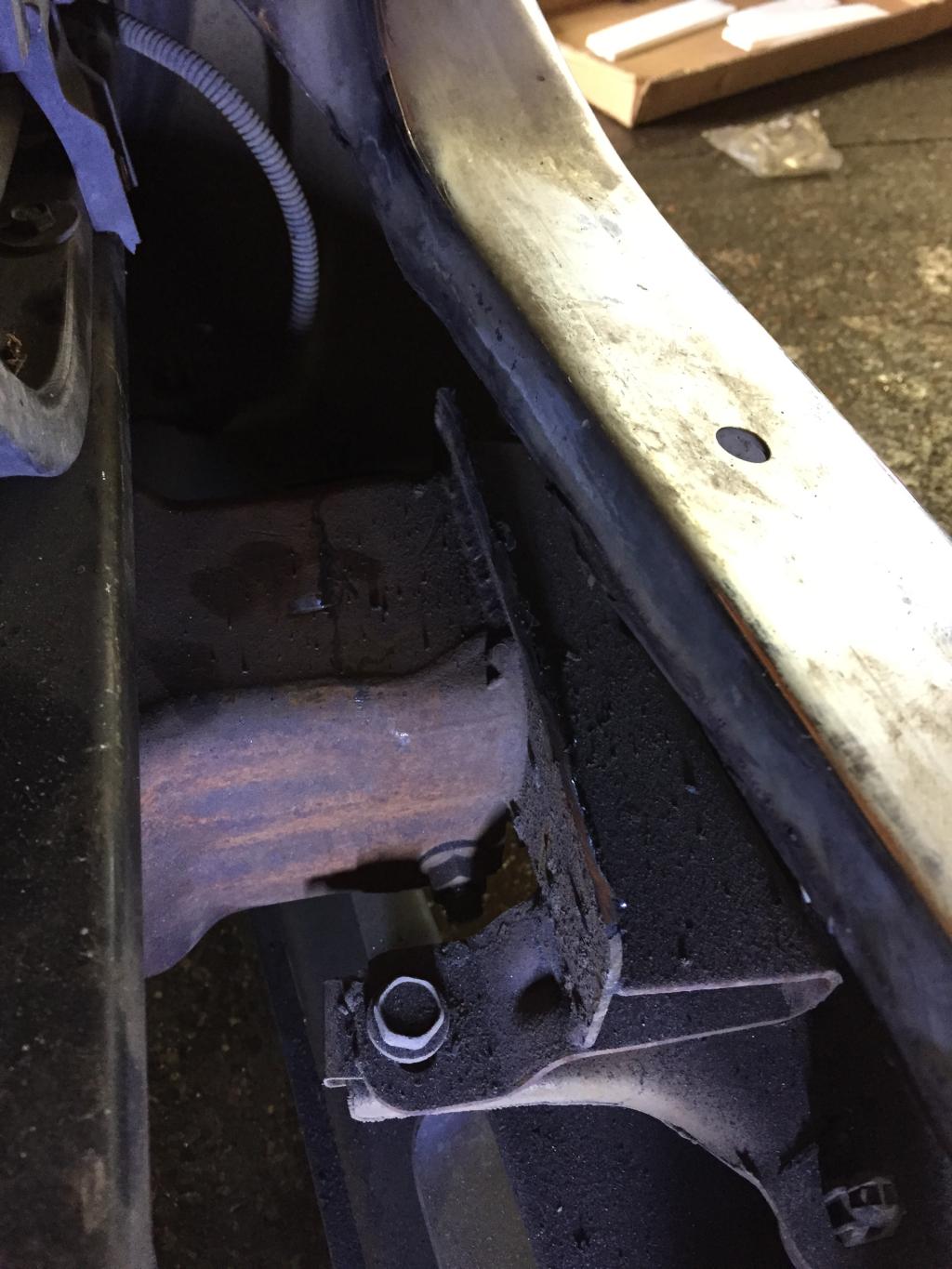

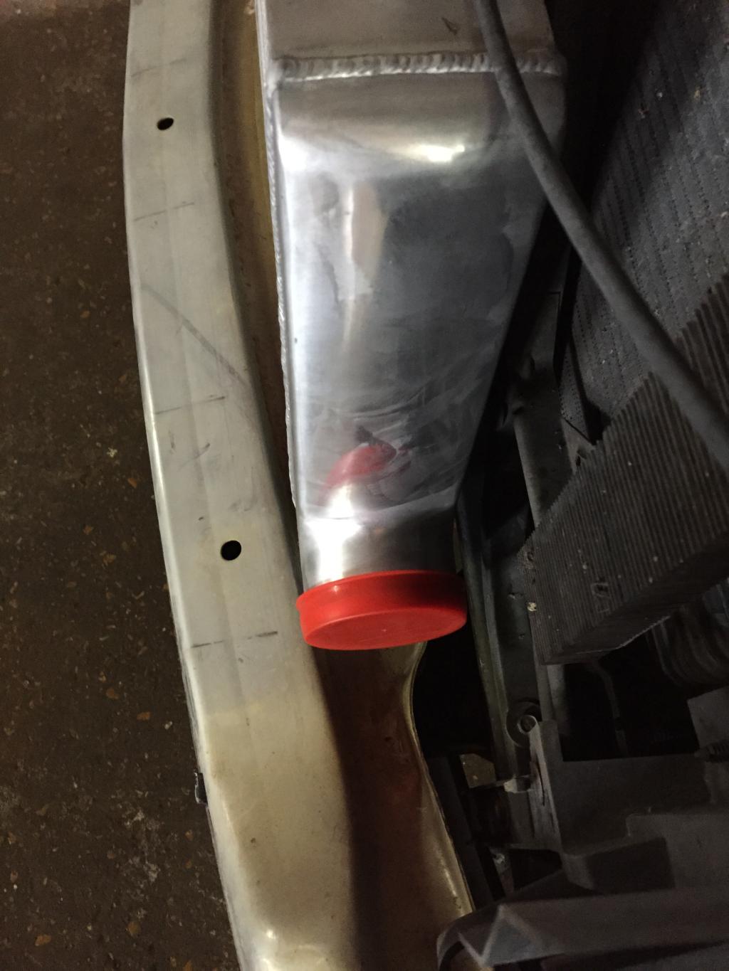

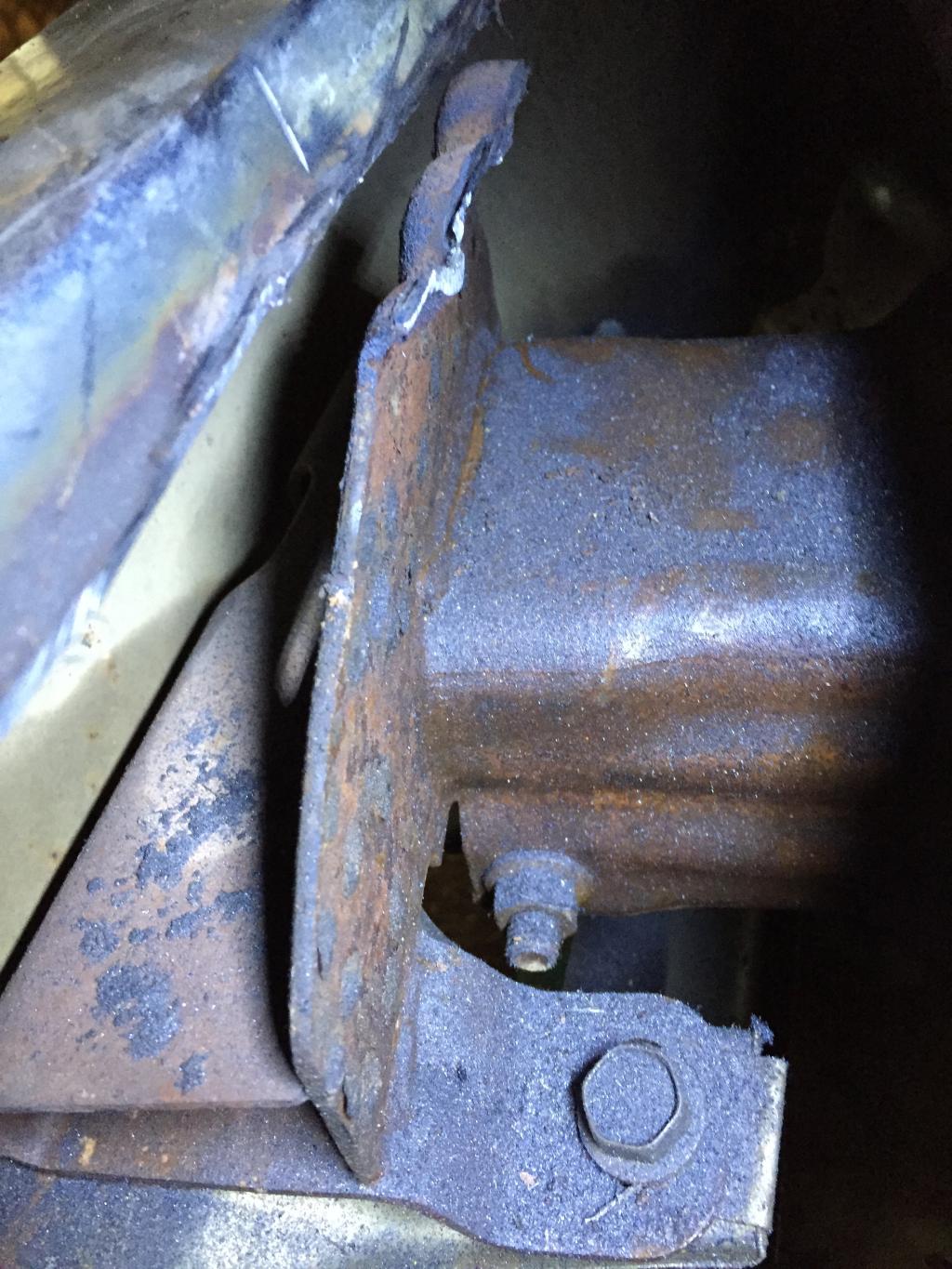

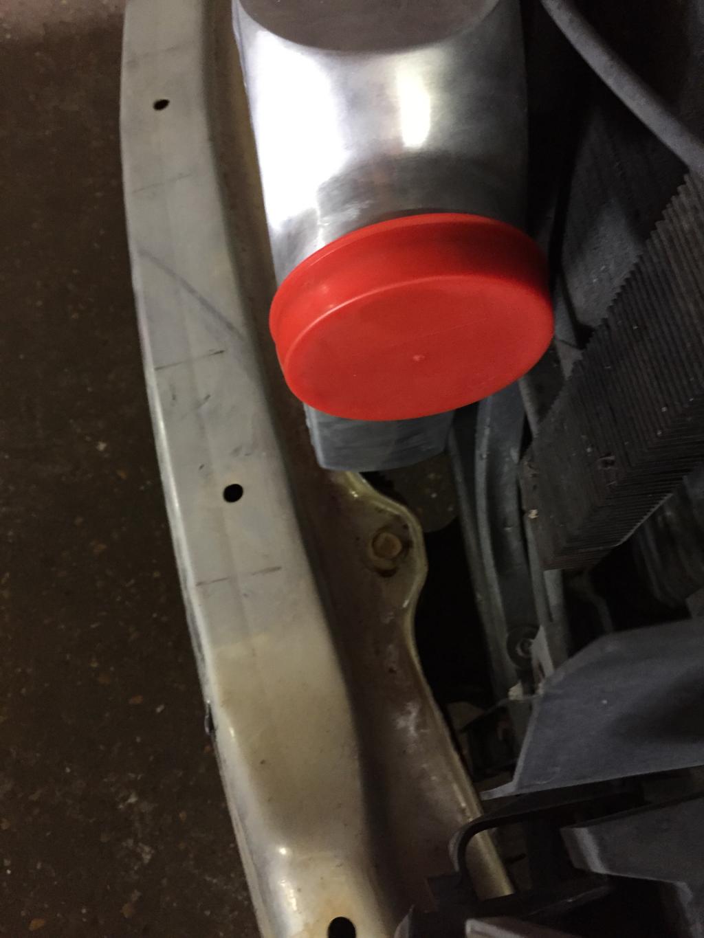

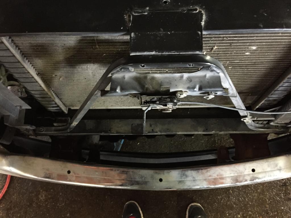

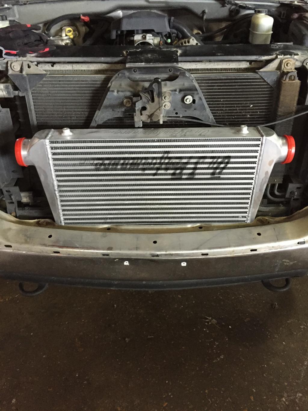

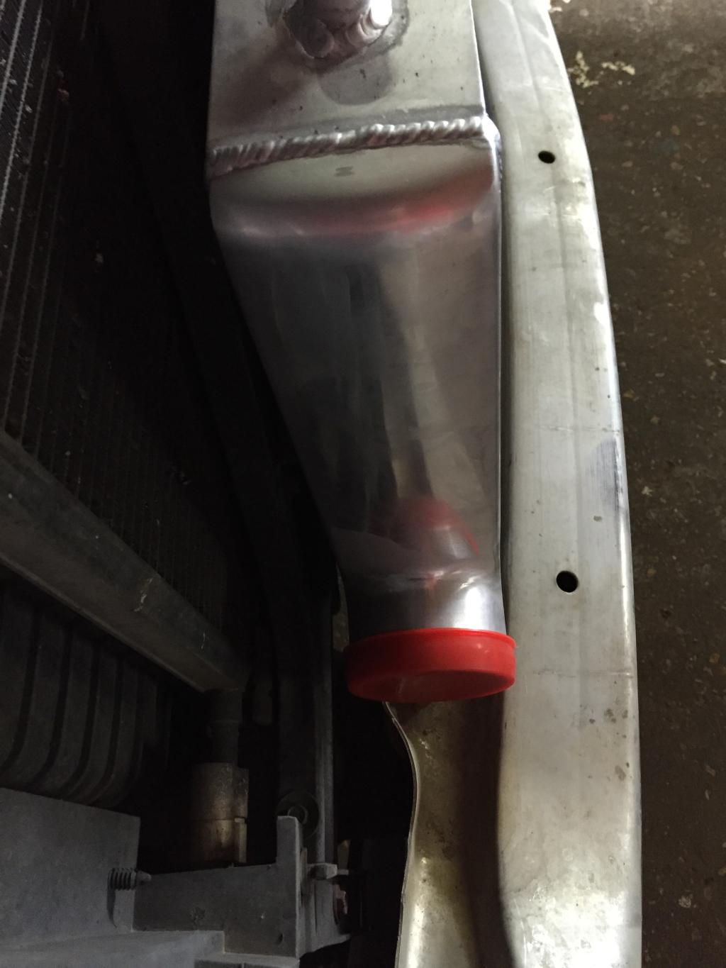

I got everything from 0n3 including the 55# injectors with the plug and play harness, there 340 lph fuel pump, i wanted to give them a full review. Well out the gate when i started to mount the IC it sat on top of my bumper, so i looked at the pic again of the install on the cd and it didnt have that problem. I then called and talked to the guy with the truck and he told me theres no way cuz his is a sierra (the pic clearly shows an 03-06 silverado front end, and theres maybe 6-7 pics on the whole install cd), so it ended with him sayin sorry and to tell them what all i had to do to get it to work for my truck. So far ive had to cut about 2 inches off the inside of the bumper and the braces that hold the upper bumper in place, i still have more cutting to do then thinking of a way to mount it kinda like them so i can use there IC kit.
So as of right now if you have a 99-01 body style its not gonna fit right. You have to have the bumper that has the vents in the metal part of the bumper.
I should hopefully have some more stuff tomorrow, i cant load pics but if someone will then i can send them to post em up for me, thanks.
Does that work?

Pics work fine. Had you already cut the bumper in those pics?

Naw im finishing it up now

Now ima try just running a piece of 2" flat iron across the frame rails and mount my intercooler to that
