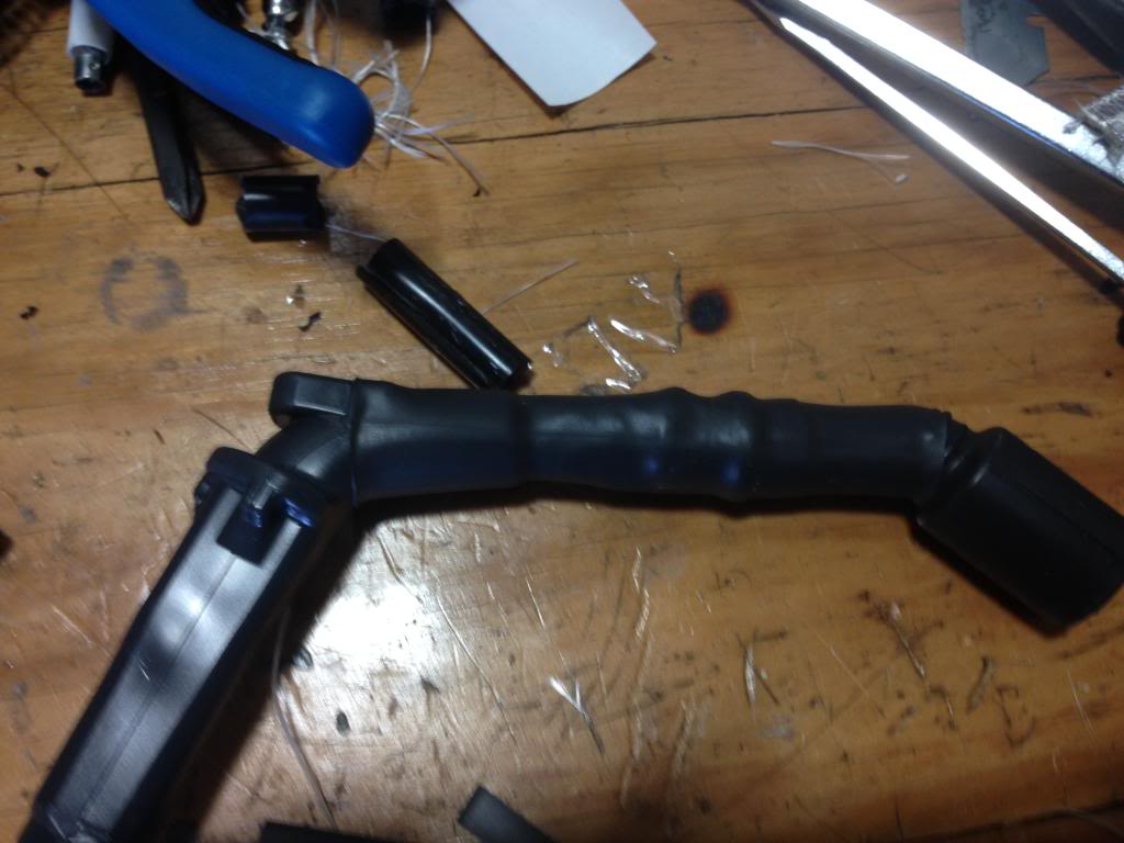

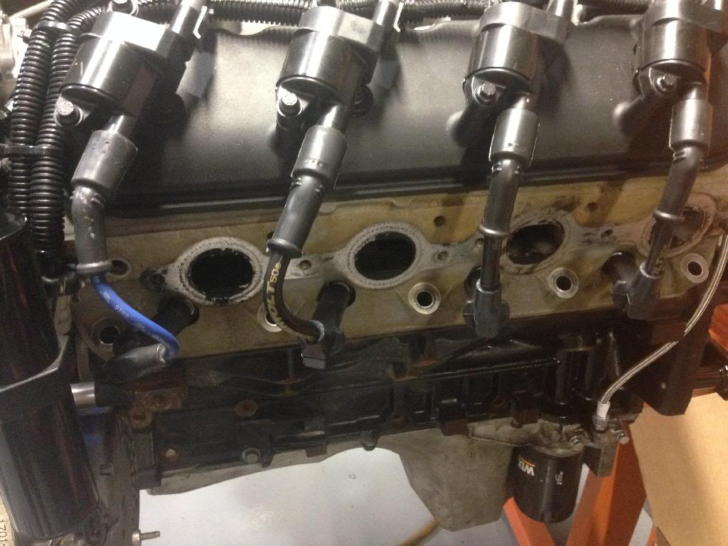

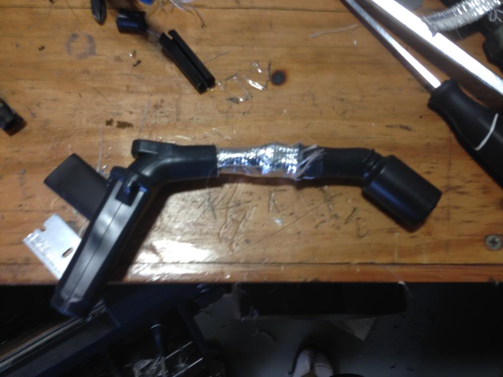

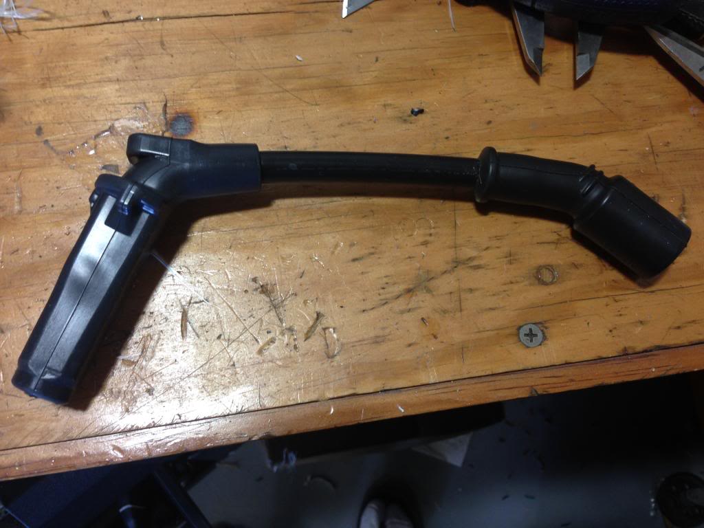

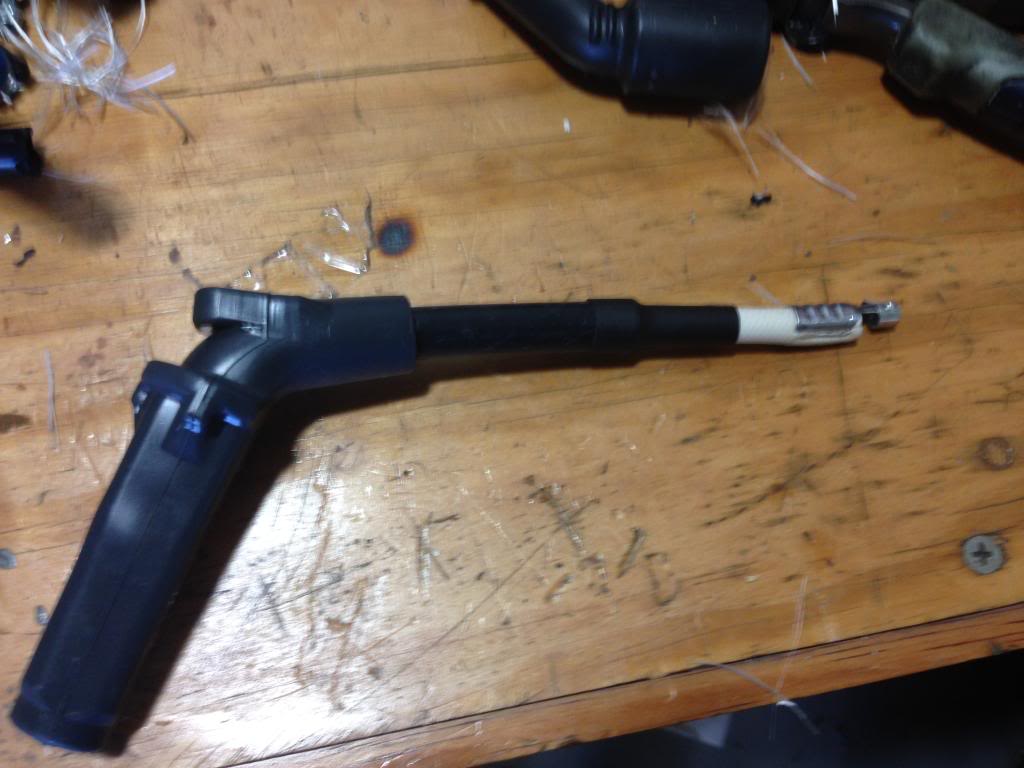

Here is what i did. Slightly over kill but i was bored.

If the wire is touching anything hot, even just a little bit, they will fail under boost and misfire. You need to make sure they are not singed at all and the insulation is not damaged. All of my wires are custom at this point to keep them far away from anything hot.
