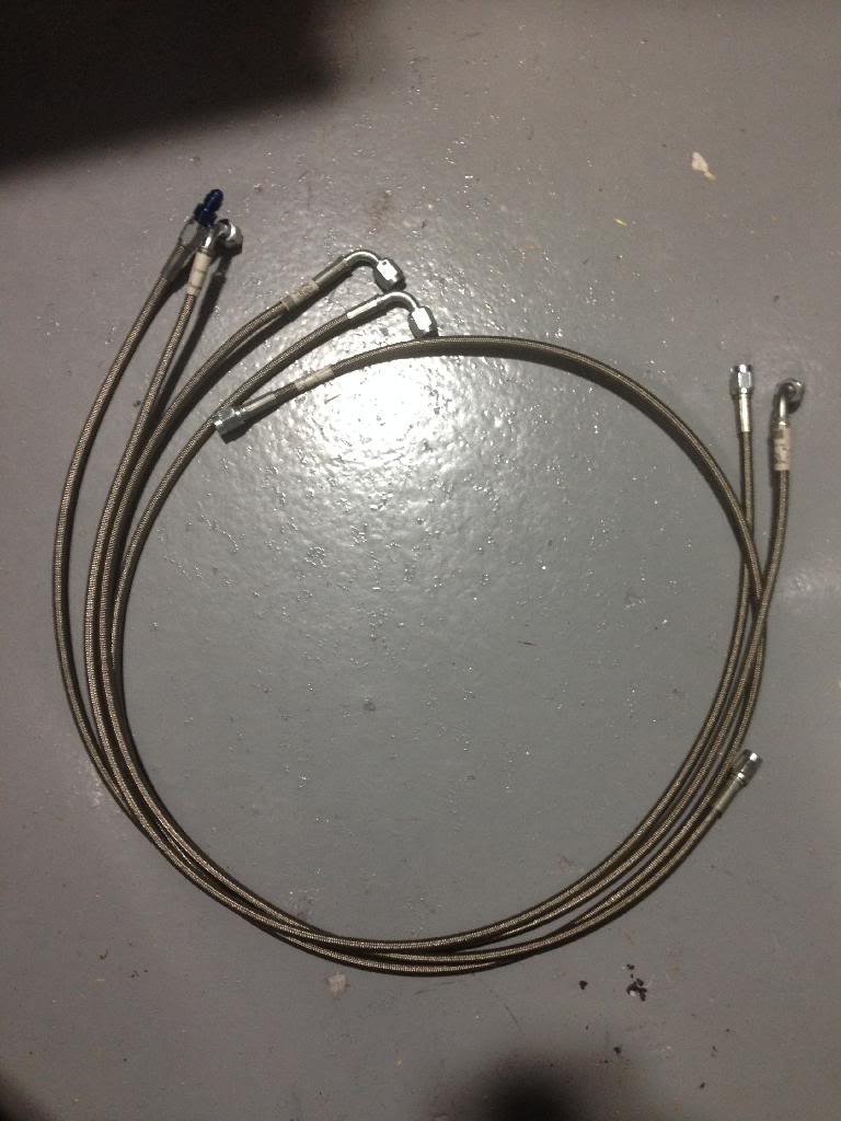

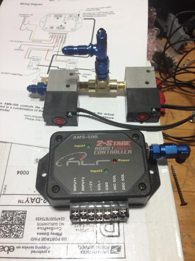

That is the plan. I just have one of these waiting to go in but i am still measuring and the braided lines

The -3 teflon braided stainless lines

ive wondered about electronic boost controllers,
for example. my set up reaches full boost at 4,800k rpm 165kpa
can a controller keep the gate closed at lower psi to build boost faster??
say 165 kpa from 3k to 6k rpm range
I can hear my wastegate open before I even see boost on the gauge

It will add or subtract your spring pressure.

Yep this one does. Basically it applies pressure to the top of the wastegate to keep it closed until the controller reaches the correct psi thus making it spool faster.
This particular controller can use CO2 to apply pressure instead of boost pressure making it spool even faster.
