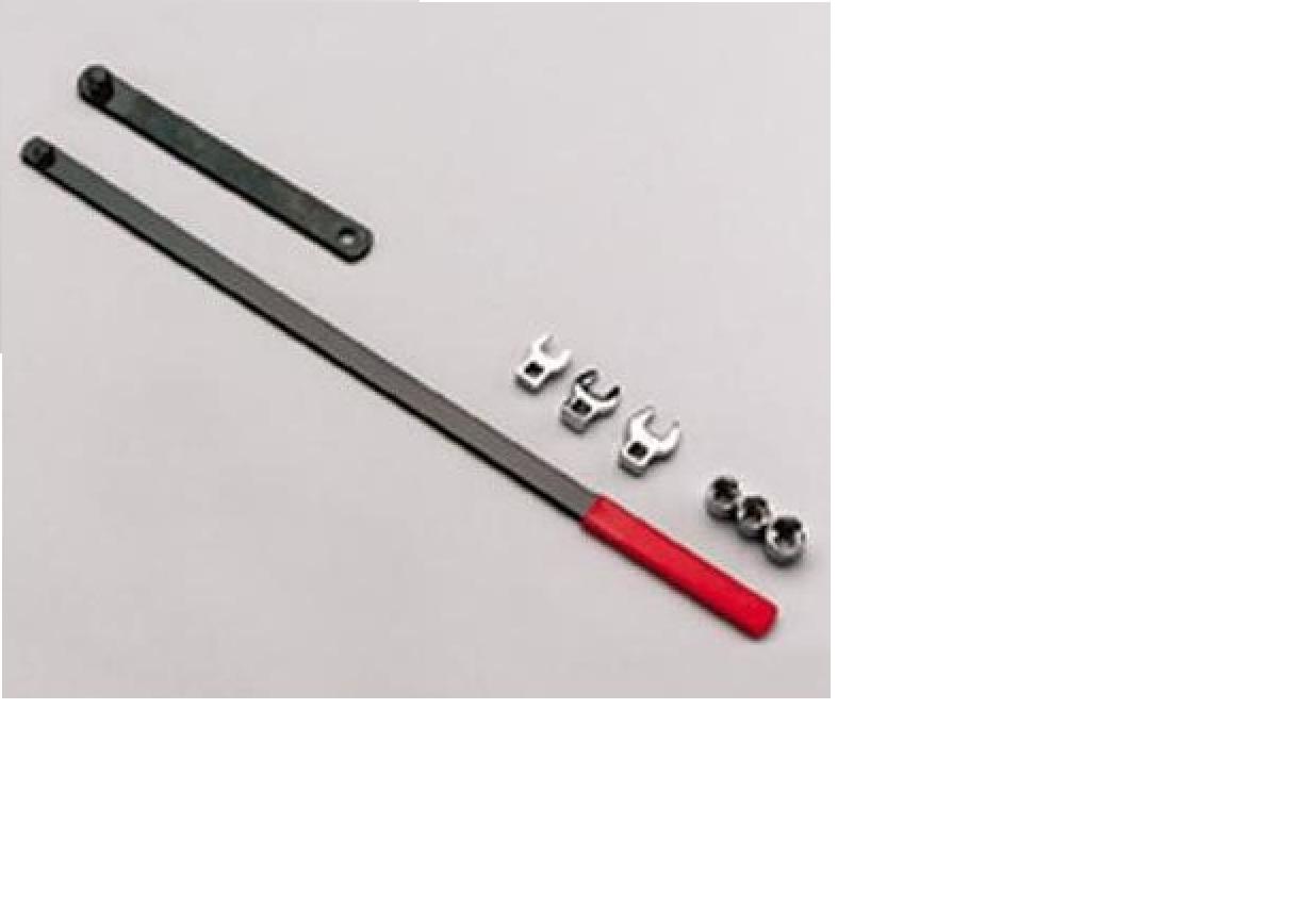

The tensioner must be in place prior to installing the belt. Just use a socket and long bar/breaker bar on the tensioner pulley nut to pull it over and slip the belt on the last pulley(blower). I carry a belt tensioner tool and spare belt with me.

I guess i was a moron trying to use a 12" socket to do the job.
Finally just bought a piece of 3/4" x 18" gavanized metal pipe to use as a breaker bar. Even with the tensioner gully compressed I had a hard time getting that 111.5" belt on.Although Zippy recommends a 111.5" belt on a 3.0 pulley, I'd strongly suggest using a 112.0 since my 111.5" barely and I mean I had to use a damn screw driver to get it over the radix pulley.
