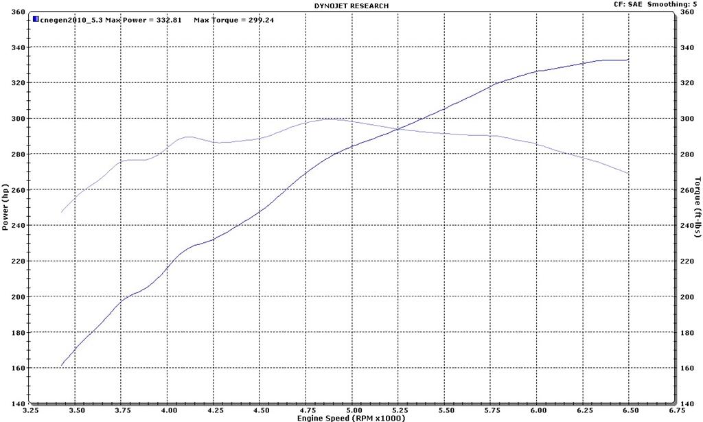

Ok guys SDPC has been working on different setups with our 2010 silverado 5.3l with vvt cam and dod delete. We just got in our 2.3L whipple yesterday. Below will be a list of mods with dyno from the first setup. We will be installing the Whipple this weekend and dyno tuning it Monday. Lots more pics of install and dyno numbers to come.....
1st setup mods list
*DOD delete
*Pacesetter long tube headers
*Pacesetter o/r y-pipe
*25% PowerBond underdrive pulley
*K&N CAI
*Fast 102mm Truck intake (stock T/B)
*Comp Cams custom grind VVT cam 218/222 dur @.050 .562/.566 lift 115lsa
*4:10 gears

First off 332hp to the rear tire is a pretty good number considering that number is with a 4:10 gear, six speed auto, and a 22" wheel that with tire is like 33" tall. As for boost we a hoping to get between 6-8psi. And yes we are trying to get some package price kits together with dyno proven numbers.
