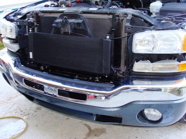

Though I'd start a new thread about converting the Roush tvs1900 kit that was designed for the NNBS to my NBS (2006) truck.
Here's the list of parts I had to get:
NNBS fuel rails.
NNBS water pump.
Injector adapters.
TB adapter.
My computer is at Black bear getting tuned now.

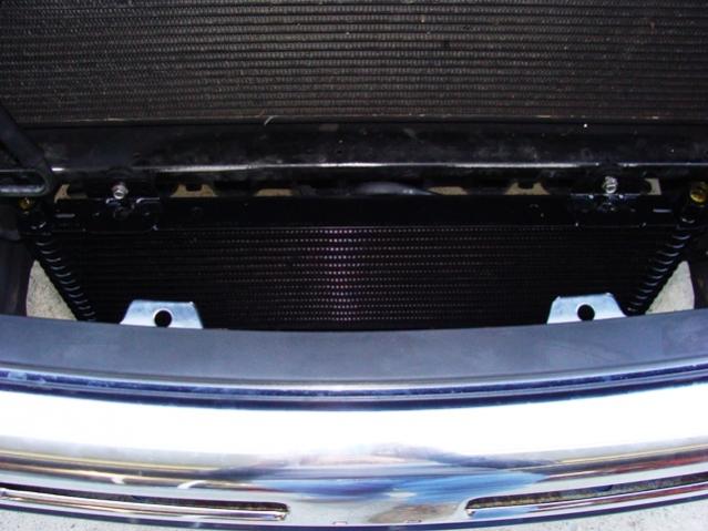

This weekend I spent some time doing some transmission upgrades:
Installed a Sonnax performance pack, 2nd and 4th gear servo's and a tru cool 40k cooler.
Installed the intercooler while the grill was out. The bracket that came with the kit worked after I bent them slightly.

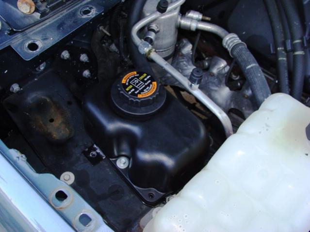

Also modified the coolant tank bracket and figured out where its gonna live.
On a holding pattern now waiting on the computer.
Attached Thumbnails Roush TVS on a NBS-feb-2010-162.jpg   Roush TVS on a NBS-feb-2010-165.jpg   Roush TVS on a NBS-feb-2010-164.jpg

what did you secure the bottom of the trans cooler to?

The heat exchangers looks as if it fits just as is it was designed for it, good deal!
Bumper mount. I used the cheap metal brackets that came with the cooler. Bent them into kind of a -J shape, so they come up over the bumper mount right next to the bumper bolt. The bracket comes from the bottom of the cooler then goes forward and up to the bumper bracket.Does that make sense? Next time I have the grill out I'll take a pic.
Yep, I was happy how it worked out.

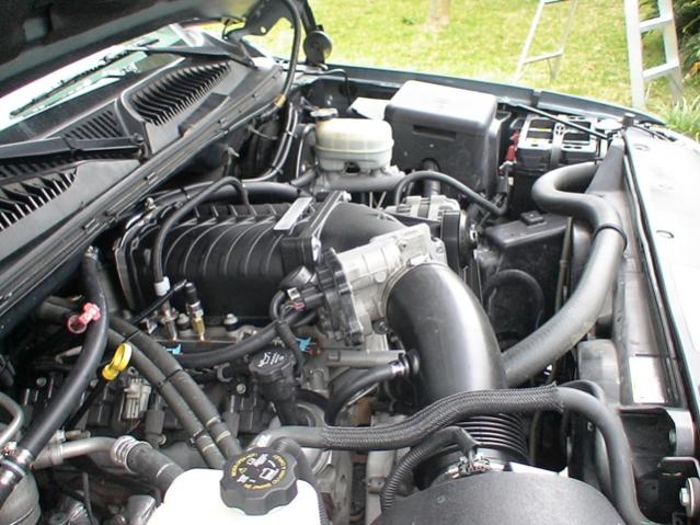

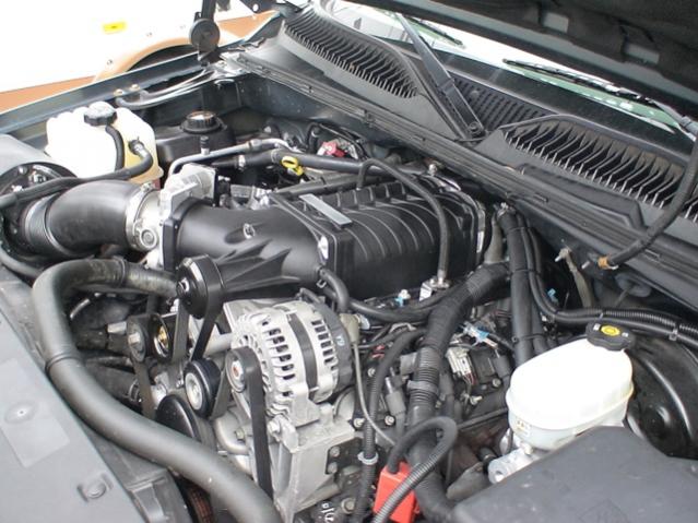

Old Mar 28, 2010 | 09:30 PM
06vortecmaxxx's Avatar
Joined: Nov 2009
Posts: 123
From: Cape Coral,FL
Default Got blown saturday night!
I finally got my act together and installed the supercharger last night.
Runs pretty strong, I'm happy. Makes 6.6 lbs of boost. My tires don't like it at all!:burn
Attached Thumbnails Roush TVS on a NBS-march-2010-101.jpg   Roush TVS on a NBS-march-2010-102.jpg
