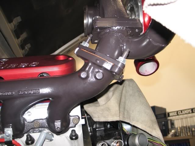

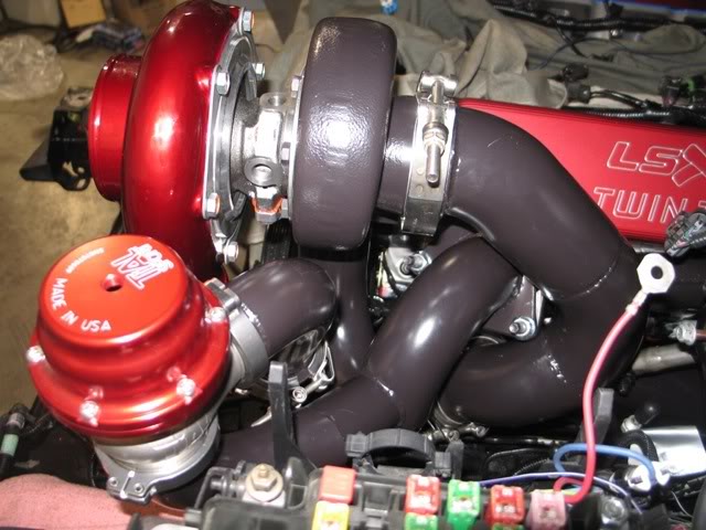

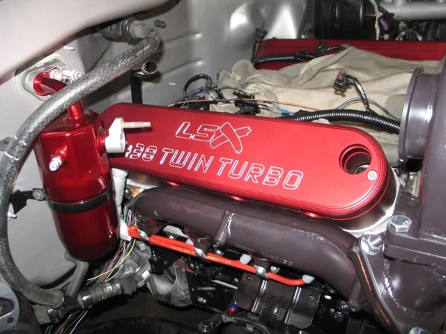

Here's my setup I built in my Chevelle. I sold the turbo to switch my setup to twins, so the piping is up for sale if anyone's interested... I took some measurements off my buddy's 2000 chevy pickup and it will fit with some modification to the heater hoses and possibly the down pipe.
Old Nov 28, 2007 | 02:53 AM
  #23
Spoolin's Avatar
GFYS and STFU
Posts: 13,870
HOLY CRAP that looks like a web of piping!! Looks like alot of heat soak from all the piping would incure no? Nice setup in any case, how did she perform number wise?

I don't think it's any worse than this...
It did get hot underhood, but nothing that I'm sure a little ceramic coating wouldn't help. No good numbers, made it to the track once and had a fuel starvation issue, ran 14.0 @ 105 mph at 5psi though.
It just looks like alot from that angle. But if you saw how short the conection pipes where, its a whole lot better.
R
Old Dec 6, 2007 | 12:20 PM
  #29
350SS's Avatar
iTrader: (36)
Joined: Feb 2004
Posts: 737
From: Houston, TX
R
I doubt there's much difference in length of the pipe if you were to measure it. At any rate the point I was trying to make was that if a pro builds a setup like this that's works that well with a few bends in the piping, I'm sure mine works just fine too.
