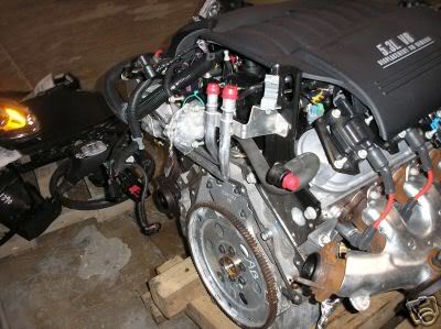

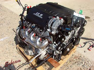

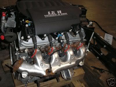

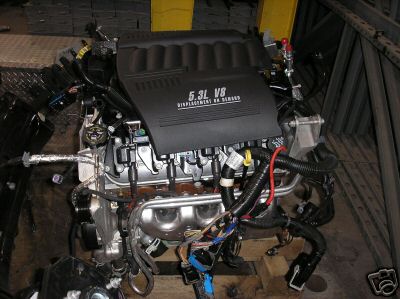

Starting to seem like more trouble than it's worth. Be nice to keep the AC and also not have to worry about plug wires touching the exhaust.
Vanilla, is there something different about the Impala SS manifolds that make them work better or clear where the trucks don't?
I'll try and find a pic of them.

Here's a not so good pic.

This ones a little better, still can't see the flange.
Wish I could see the manifolds on the LS2 engine.

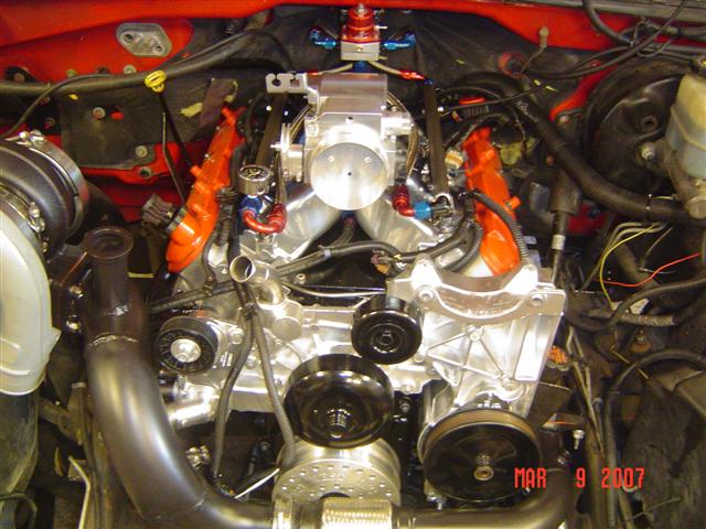

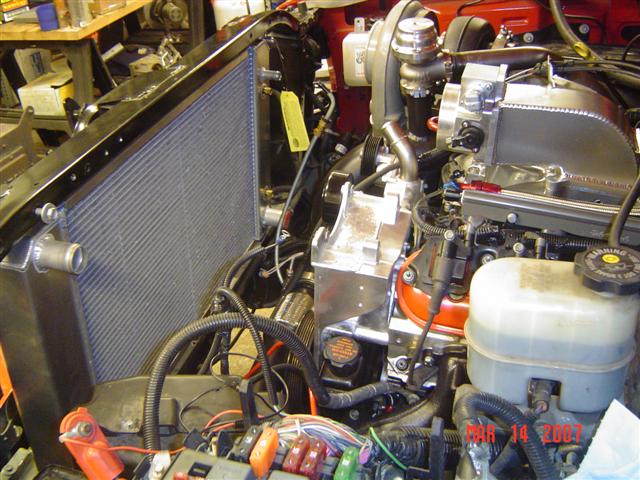

my buddy built his own turbo set up in the same location as how you want to do it. He had the kit almost complete (got the 60 lb injectors in and just had to tune it) when he accidently fed the motor 25 + psi (lots of twisted rods). It's for sale if you are interested, here are the pics of it that I have (clicking on the pic will take you to webshots where there is more pics)

I just checked out the pictures of your buddy's kit. Wow. I can appreciate the work involved in the kit he built. He has lots of skill.

thanks but the biggest problem with the kit is he paid shops/friends to make it ($1500 alone for the turbo mount ) . He has huge money in it, but is selling it for a quarter of what he has in it
