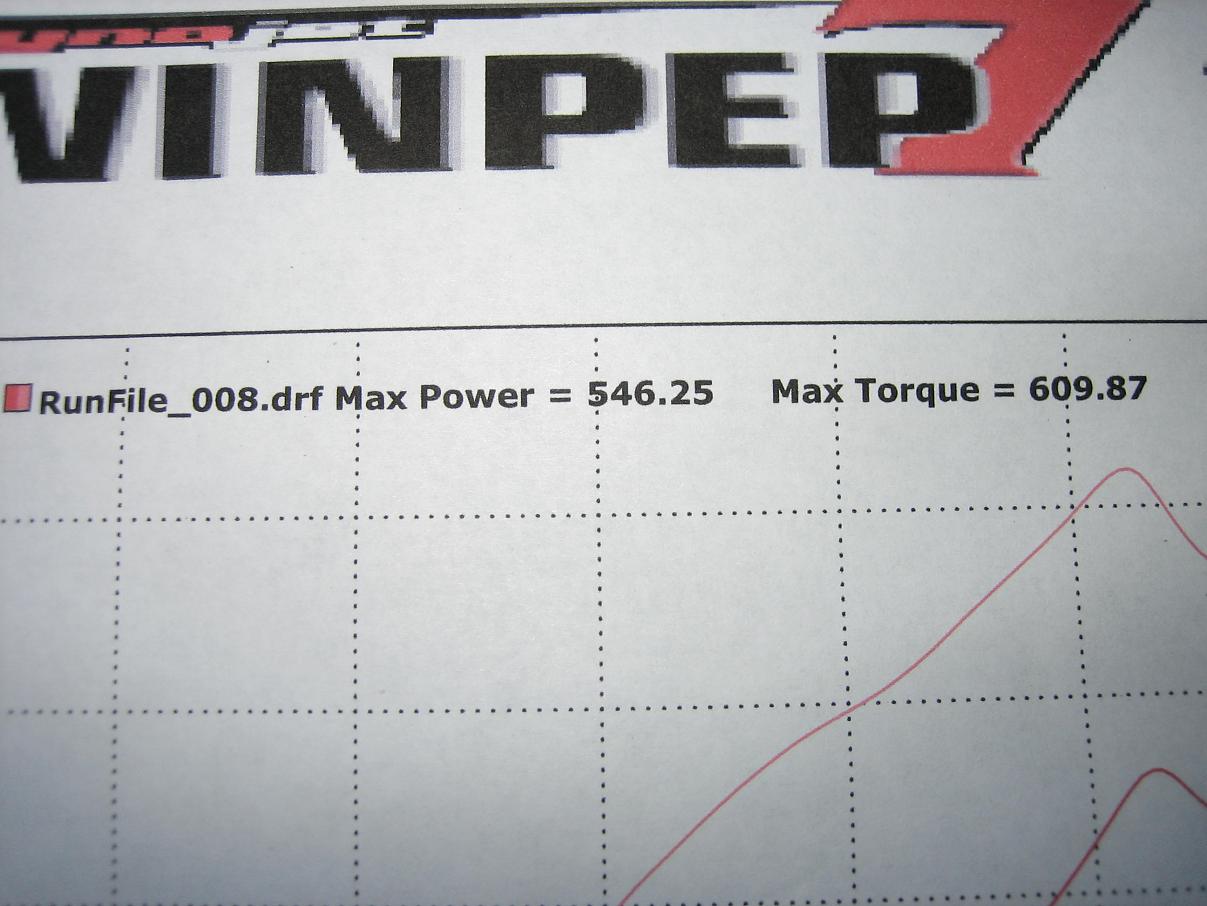

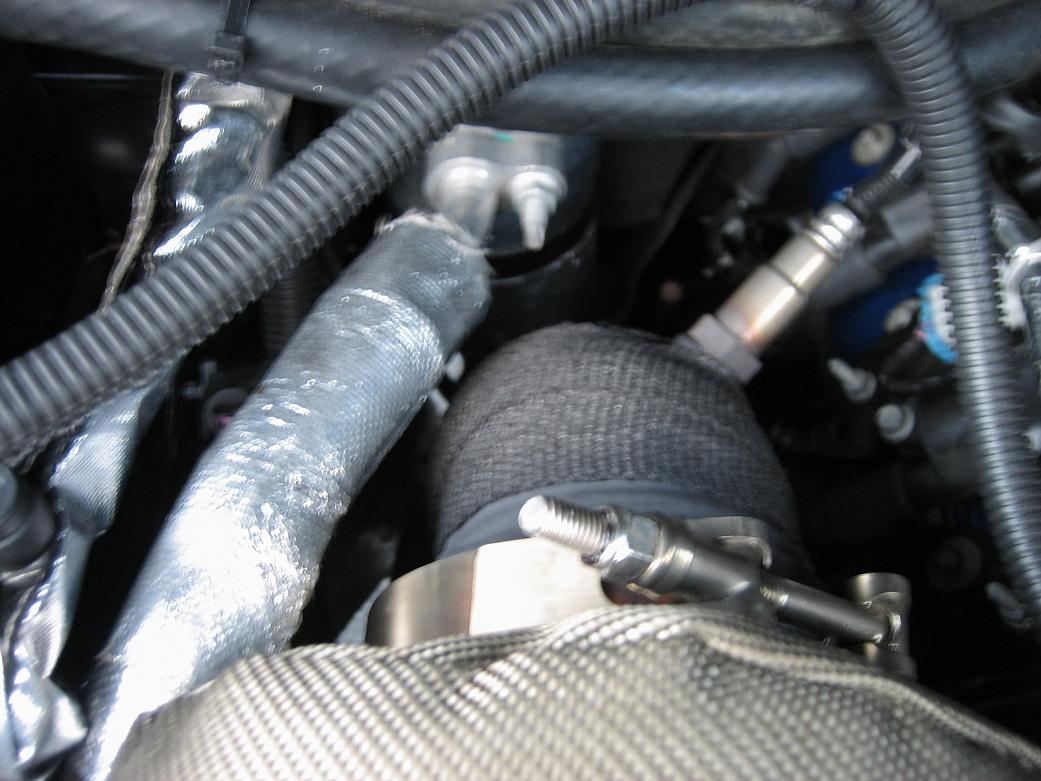

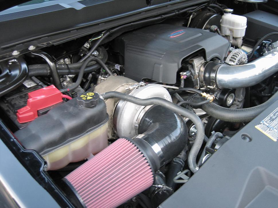

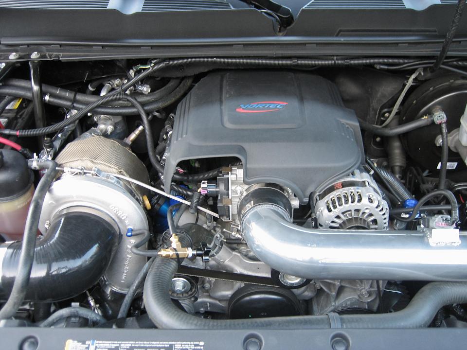

First things first is Rick/Trick performance product is a Awesome person to deal with. First class!!!! You guys know I started my 2011 silverado ccsb 6.2 turbo built a few month ago. I wanted the change a few change on the built before I tuned and dyno my truck. I wanted more turbo and Rick when to work. BW 75/83 1.10ar. We change the crossover and downpipe too. Ok off the dyno, started at 8:30am worked half the day tuning on the street get it perfect I think. Then put the big girl on the dyno 7lb at made 500rwhp and 500tq. Make 7 run back to back IAT never went up pass 125degree. Made a boost change to 9lb and made 546rwhp and 610tq WOW the truck is a beast. And to top it off I'm got 20.5mpg on the way home. Just a update stock engine with a dynomax 16in 3.5 muffler and a Turbo. That it. A beast was born. I see a small cam coming. Here is a few pics.

Great #'s. Enjoy. I'll be stepping up my turbo next year. Just wanted to get my feet wet. 20.5mpg Were you cruising at 55mph?
