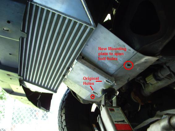

The intercooler issue is really simple... these kits were design for the Escalade, the Escalade has a totaly difirent layout for the front end. I know because i looked at one side by side with my truck and was shocked at how difirent they were considering they are technicaly the same truck! But that said, all i ahd to do for my intercooler was have a plate welded onto it to span the back side far enough to fit the bolt locations. I didn't have to change the charge pipes or anything...
See attached picture for my mocked up mounting plate, i will try to find or take a picture of the finished plate...
And as for Airflow on the Intercooler, i cheated and mounted Two 10inch Electric fans to the back side of it! hehe

I know I could get the intercooler to bolt up, and a new mount wouldnt be hard to make. It would definetly be easier than making new charge pipes. I just cant see having an air to air intercooler sitting like a skid plate getting limited airflow. I want this thing to be done right, which is why I am going to the extra expense to do it right.
As far as the intercooler bolting to the escalade, it wouldnt bolt to 2tone's escalade either, and he made a new mount to get it bolted up.
Yea, I wish it was a true front mount intercooler like you are doing and I am actualy working on this. I am waiting to get a spare front bumper to hack apart though before trying it... Bumpers for a Cladded AV are not cheap and there really are not any after market choices out there. Only one that i know of by Valcana and it is very expensive... :-\
