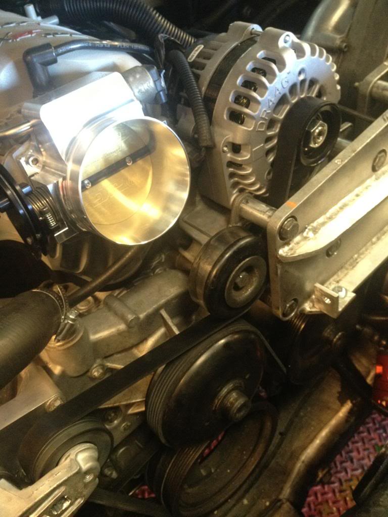

Old Jun 3, 2012 | 04:50 PM
  #30
Superado's Avatar
11 Second Truck Club
iTrader: (37)
Joined: Mar 2006
Posts: 2,867
From: Dallas, Georgia
One delay after another has postponed results, but...
belt and tensioner are now on and tensioner should now be indexed where it needs to be...pulley sits at 75%+ of full travel w/ belt on...w/ about 2" of available travel, stretchwise...using K061099...full belt routing laser aligned.
Now that the LSXRT is installed, we're finishing up the fuel supply, fpr and return lines this week as well as steam vent lines and we should be able to fire her up and see how well she does
