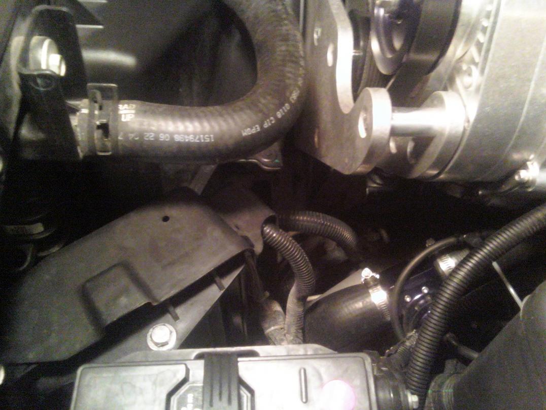

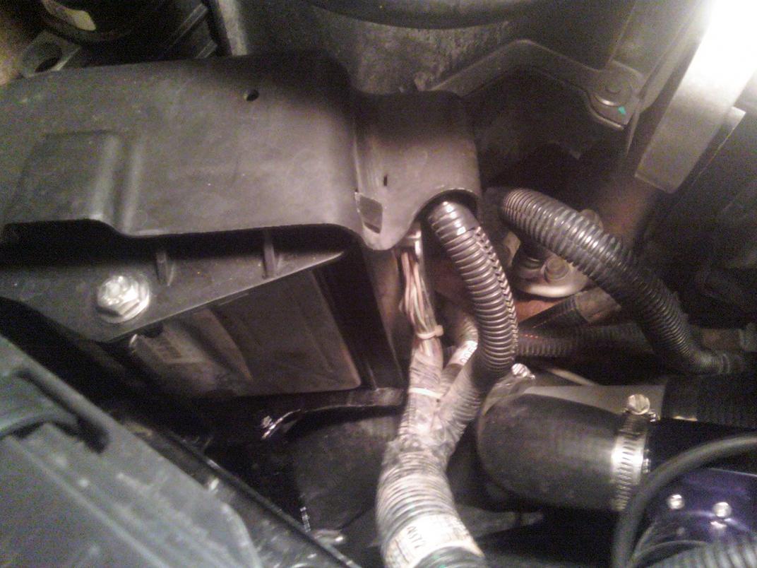

I relocated my pcm by removing battery and running my procharger plumbing as required. I made the pcm bracket fit as required. I ended up dotco-ing the back factory mounting frame off the back. Using 1/8" x 1" flat aluminum i bent up brackets to support it accordingly. I am still able to clip it in and out and the cover still fits too. I painted the aluminum brackets black to blend and look more factory. Here are some pics if you can see them. Oh, and my red box is just zip-tied tight and out of the way. Will find a better solution soon. Hope this helps.
