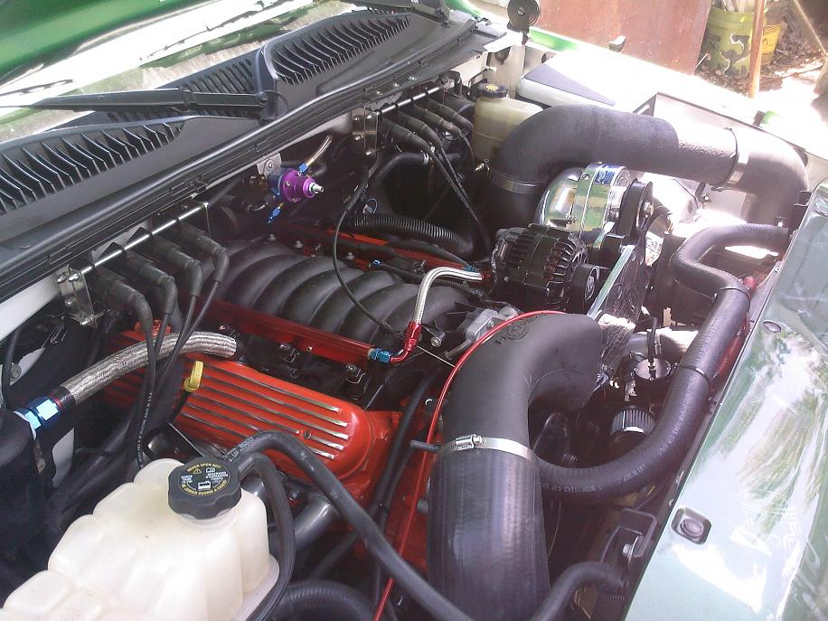

Funny you should ask, just completed mine. Need to take a better pic.
Already had my battery relocated so that made it easier, removed the windsheild washer tank and moved the electical center back and that opened up a big space.
I used metal 4" tube and coated it with Lizard skin, have yet to drive the truck but going to the track tonite if it doesn't rain again!
Damn!...looks like u got a pretty healthy setup. Keep me posted if u get any better track times. im curious to see if its worth my time to build one. thanks
