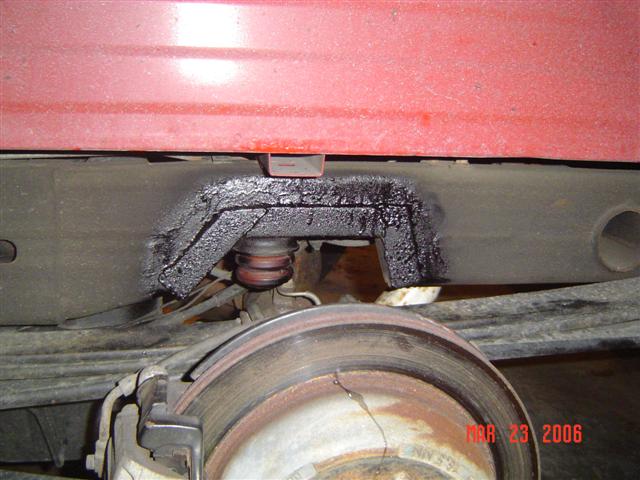

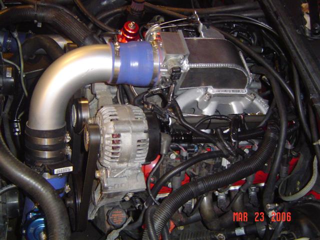

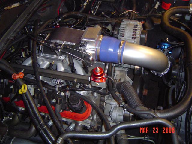

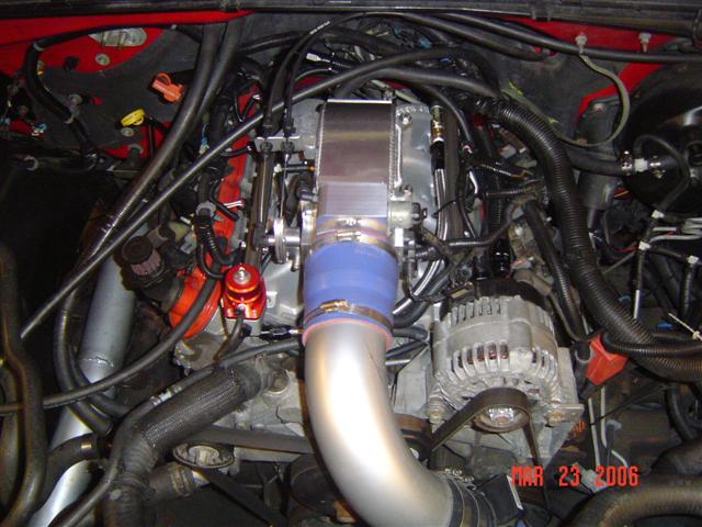

Here are some updated pics,It's running.
Also a pic of the notched frame which the undercoating made it look like crap.

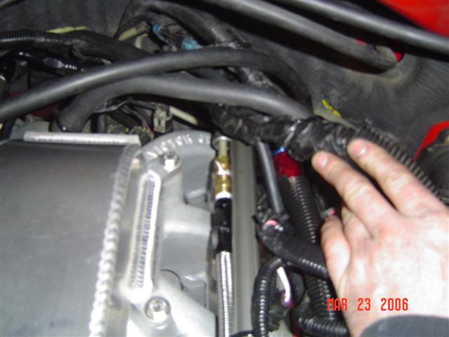

Here are the fuel lines connected

Is that an areomotive fpr on the end of the pass fuel rail? Also how did you connect the throttle cable bracket to the elbow? Just weld it?
Old Mar 23, 2006 | 08:48 PM
  #60
Slowhawk's Avatar
LS1Tech Sponsor
Joined: Nov 2001
Posts: 14,771
From: Bridgewater,Ma
1-yes
2- I just cut the stock bracket and welded on some extensions.It's bolted to the inlet hat.
