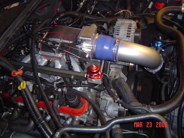

I circled the part I am talking about in red. It looks to me like the bracket was welded onto the elbow I dont see where you bolted it onto the inlet hat? Thanks for the help. Looks like this swap is going to be a little more involved than I thought but the gains should be worth it
You won't see the bolts unless you look under the bracket.The bracket has a 90.The bolt's are actually tapped into the hat from the inside so you just use nut's to attach the bracket. This intake took me about 8hr's to do with the fuel lines and rewiring the injectors.

Yeah its nothing hard just a little more involved than I originally thought but like I said before should be well worth the gains. I may make me a custom bracket also for the throttle cable. Thanks for the help
