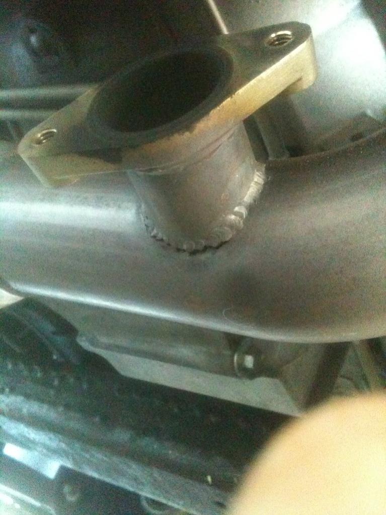

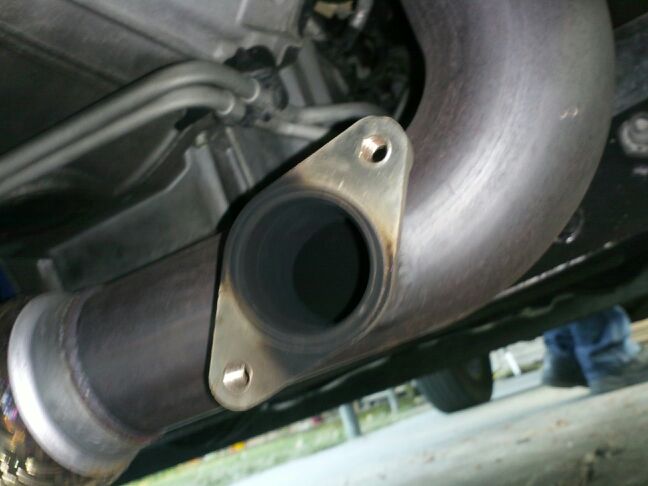

Well guys i dont know what happen to be making 15 20 lb of boost.
I have a t76mm from trick performance with a 6 lb spring on a 2010 5.3, The truck was working good airfuel at 11.5 timing at 12.
This happen after i install the boost gauge so i start looking for a leak and found it. Its was on the hose that goes to the boost gauge I fix it but it still over boosting.
Today i went under the truck to check the wastegate and found this, I dont know if this is the problem. Theres a crack and theres signs where is leaking where the wastegate sits. Can that make my truck over boost? Or the boost gauge is not working right? I dont want and try a long WOT run to see if my air fuel gauge goes lean, Not trying to blow the motor.

Need to weld up that crack. It's under warranty if you send it back we can do for. Just pay the freights. Or a local muffler shop might charge less then the freights.
