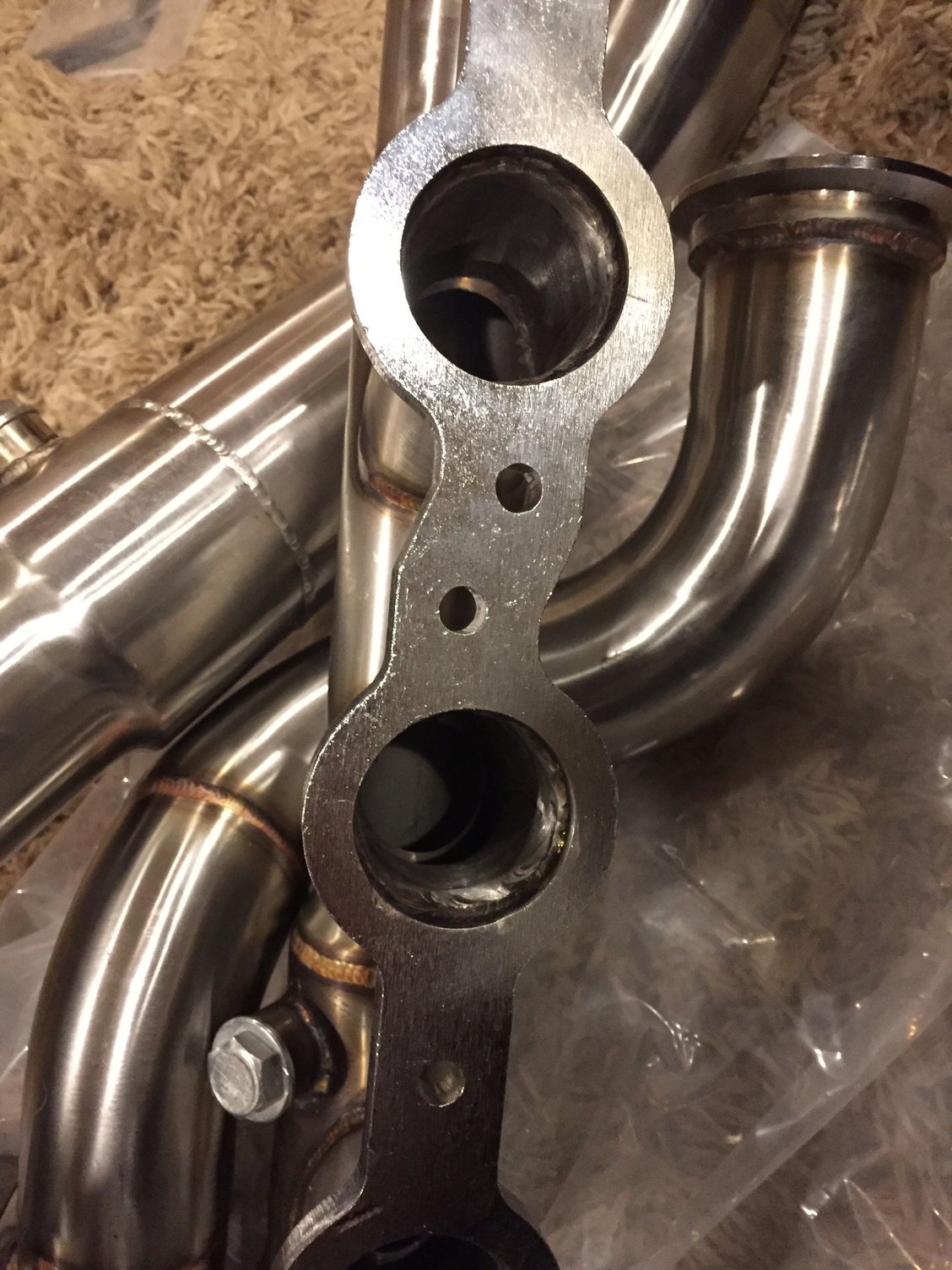

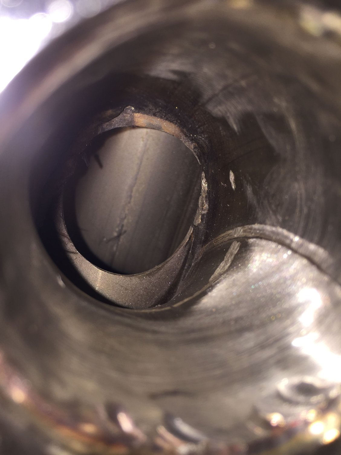

Originally Posted by MIZEBAD
That's how they were. I don't have a picture after I ground them out but now if flows with the way the pipes are bent
Another picture from a little farther away
How does On3 aim the wastegate dump? Is it just angled the same direction as the down pipe?

See its that stuff that would make me red flag the whole kit.

And even though the on3 kit has it faults, minor stuff like that exhaust mismatch wouldn't really put me off that much, it's very fixable. It doesnt have to look pretty to make stupid power, just look at that matt hapel's stuff. He'll have 90 degree bends, jagged piping and it still makes power.
No it's a 90 degree bend that faces the front of the truck and dumps down by the ac compressor. I took it to a welder and got it welded into the down pipe though so I wouldn't have to hear it vent every time it opened.
I agree with you. The piping in the exhaust and the vented waste gate were my only two minor complaints. Mainly just because I wanted to get it out on right away and couldn't because I wanted to make it how I wanted it. But everything is on now. And I am happy with how it went. Pretty easy actually. For the kit it was just bolt on. But I had to make the electric fans fit on my truck with some cutting because I didn't want to get the bigger radiator to make it an easier instal. But got it done and hopefully have her tuned on Tuesday
