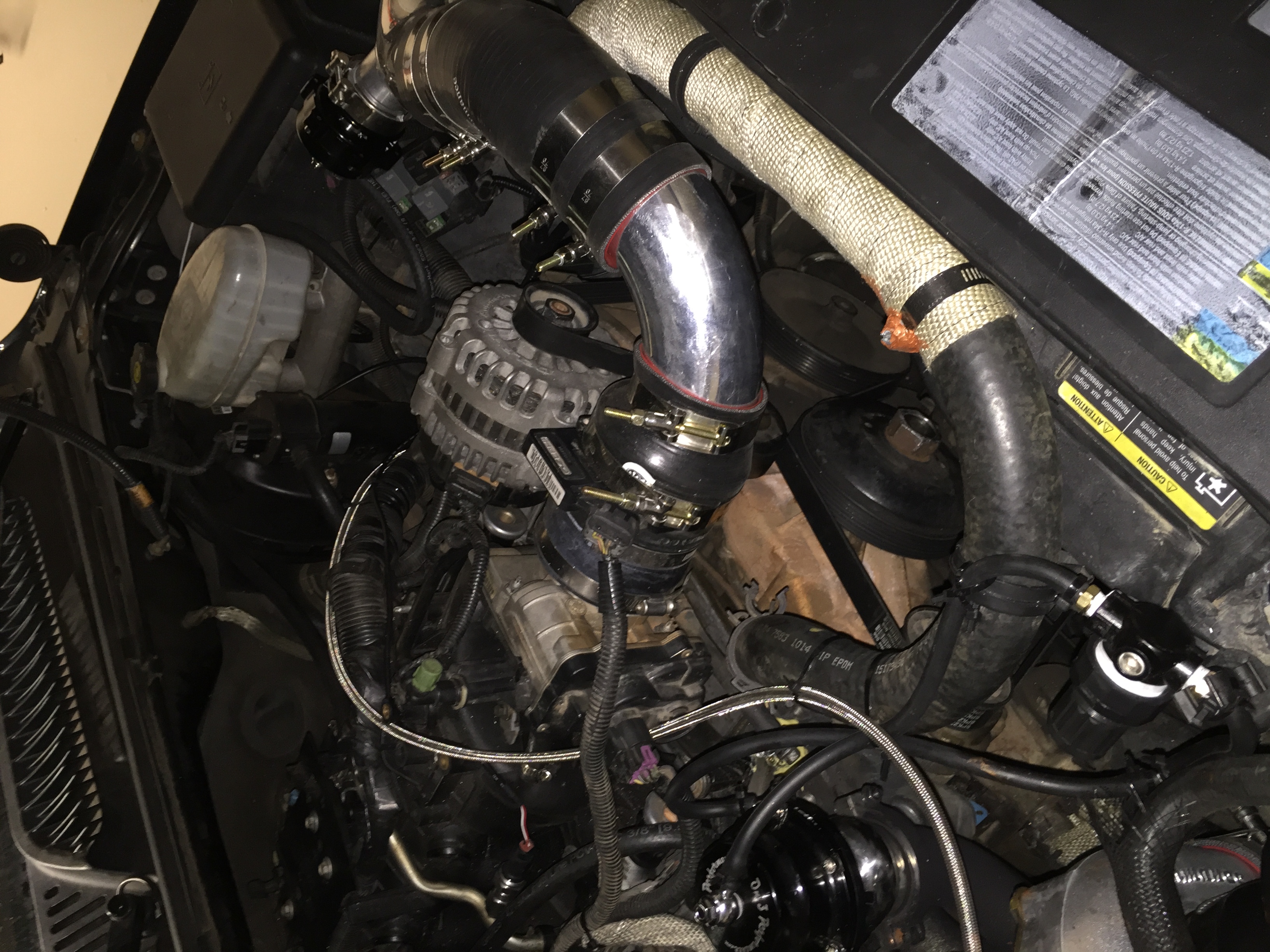

Originally Posted by d_gans96
Can everyone here grasp the concept of having more power and getting better mpg's when the engine isn't under load? Or is everyone's tuner just adding a percentage over the entire fuel table and calling it good? If the pcm can still still adjust STFT and LTFT, then it shouldn't run too much richer than 14.7:1 at cruising speeds. With increased air and fuel at the same load the engine shouldn't work as hard to keep moving the same speed, therefore without a change in driving habits, mpg's should increase some.
Hey. Finally got my truck tuned with the on3 kit. I've driven it for around a week now and I went from 12.2 mpg's to right around 17. My trucks lifted and sitting on 35's and I wasn't expecting any increase because I was thinking more power more fuel less mileage. But with the engine having more power it turns everything easier so it actually is saving me some mpgs. I think any of the kits would be good. I'm happy with the on3 kit for now. I welded an extra support that bolts to the cylinder head to help with bumps and stuff but I think it would have been fine the other way as well. But any of the systems will be freaking sweet. I love it and it's like a whole new animal under the hood. Plus the extra gas mileage makes up the cost for running premium. Good luck to whatever you decide to do!
Damn that's a pretty big increase in mileage. I think I'm just going to turbo my truck and roll the dice. If the mileage doesn't increase so what. If it does increase that will just be icing on the cake. I've got to do a little more research on what kit I want to go with. Right now I'm thinking using the KB racing hot side and Denmah cold side kit. Did you keep your MAF sensor in your kit? And did you have it tuned with hp tuners?
The kit was designed to use speed density and cut out the MAF all together but I kept it. all I did was put it right in front of the intake manifold. I was skeptical with it being right there but it actually worked very well there from what my tuner told me. The tuner suggested a 2bar speed density tune also but until I go crazy big on horse I'm just sticking with how the truck was made. That way you don't have to cut and splice in a different IAT sensor etc. I'm not sure which program he uses. But I have to stop by after work today to adjust my shifts a little firmer so I'll ask him then. And the better mpgs were cruising at 75ish. If I'm romping on it gas mileage is about the same as if your romping on a regular NA engine so I'm happy with it. I drive to and from Colorado a lot and this extra bit on the highway will save me a ton of cash along the way
