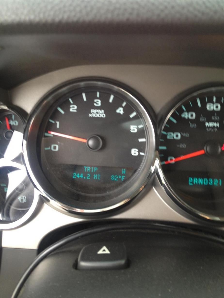

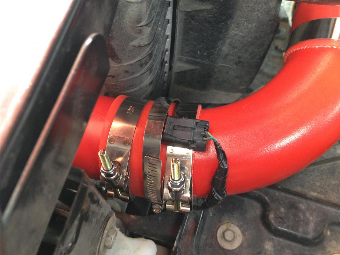

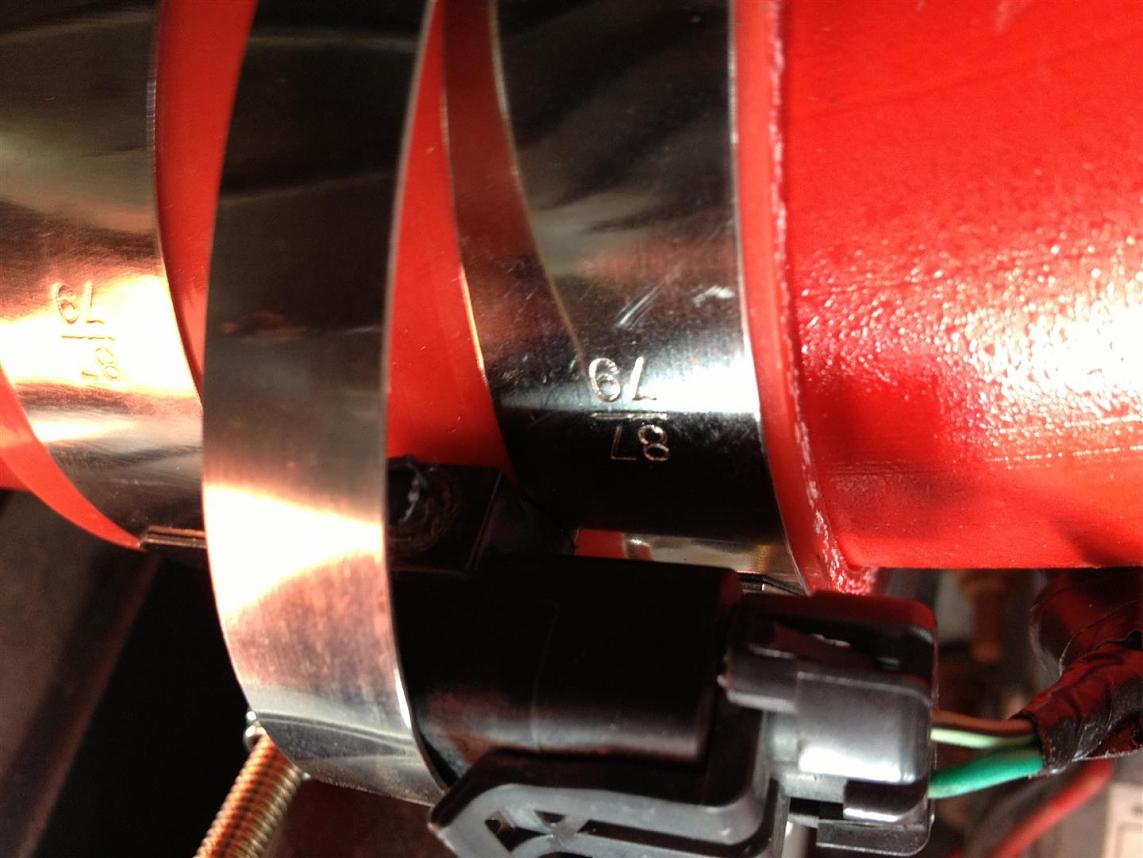

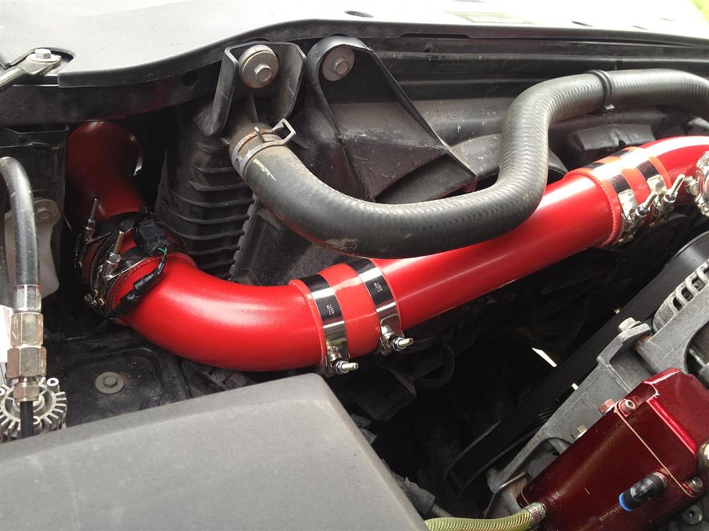

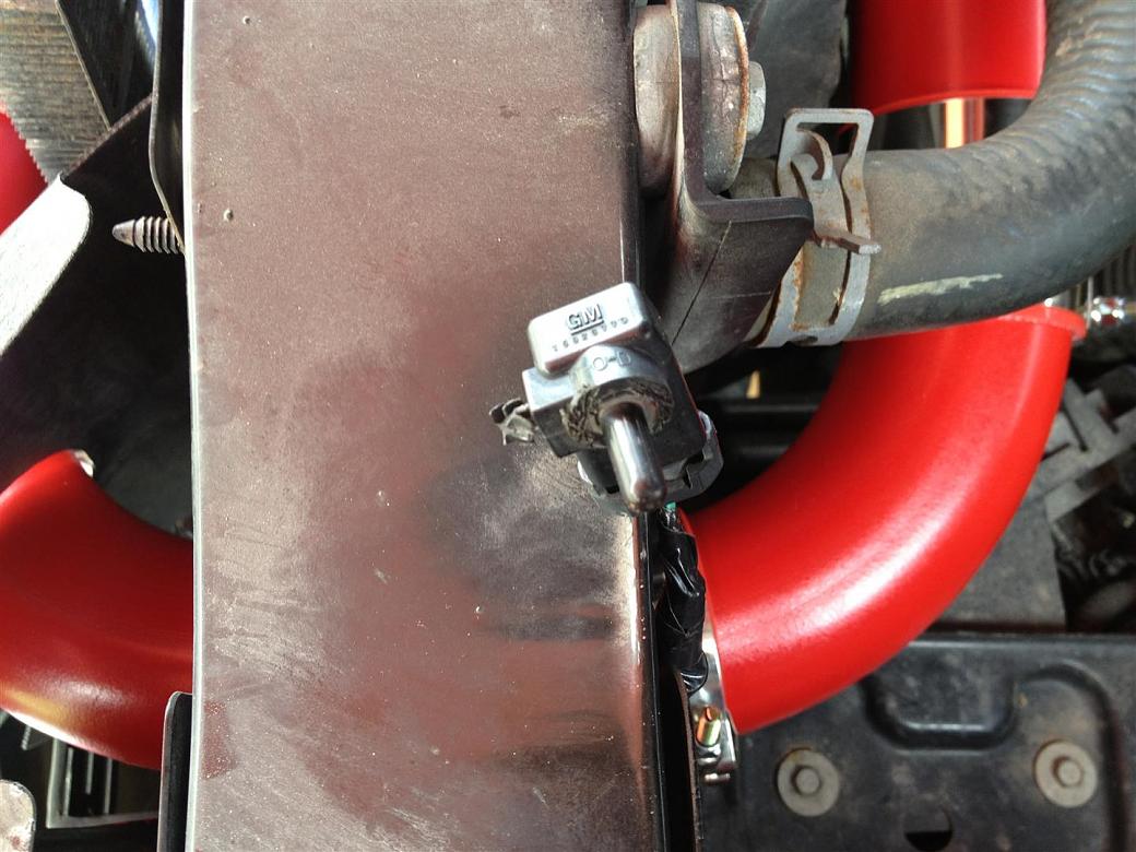

I installed the intercooler yesterday.
I took the OAT sensor and trimmed the sides off. They appear to have no use in the application for my truck but it looks like it can snap into something for a different connection.
The sides had to go.
Then, before I put the connection together, I drilled a hole through the silicone connector and the end of the 90 it was on. This will make sure nothing can move. Also, if I just put the sensor between the pipe ends in the connector, when I put the hose clamp on the secure it, it would just push the connector out of round. This way, the sensor actually seals against a solid surface.
I did a short run yesterday and the discharge side of the turbo was 123 degrees and the sensor read 82. Shooting the outside of the pipe in the engine bay with a temp gun I got 87 degrees.

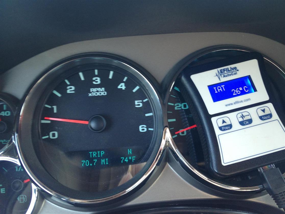

My MAF is set as draw through so it's before the turbo.
Now I know what's going into the turbo and what's coming out of the intercooler.
This is after about 45 miles of easy driving this morning.
Normally I'm finding it to run 10 degrees higher out of the intercooler than the OAT.
