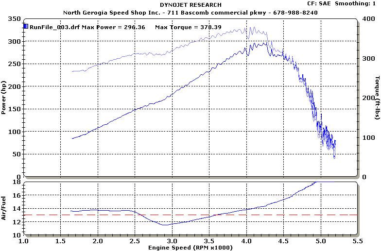

After getting a new air intake in place and the surge valve venting to atmosphere I took it to the dyno, figured I gotta crawl before I walk...walk before I run, right?
Ran a 296rwhp/380tq...A/F started to climb so I backed out of it.
Checked inline booster pump...working
Checked fuel pressure @ idle...50#
Went back to file that cablebandit saved of run to check duty cycle...100%
Not enough injector with stock injectors...whodathunkit? ...I've been in denial...
Cablebandit pointed out that the fuel rail has a 1:1 regulator on it. So what good is the FMU doing when I don't have enough injector anyway?
FMU...gone! It's in the tool box now.
I'll keep my foot out of it until I get some injectors in...then we'll see what she can do...

Here's the dyno sheet...
I believe that their A/F was off, because HP Tuners was showing only a couple of degrees of KR and as soon as it began to climb, cablebandit tapped me to back out...as high it was showing, I think that I would have imploded...
