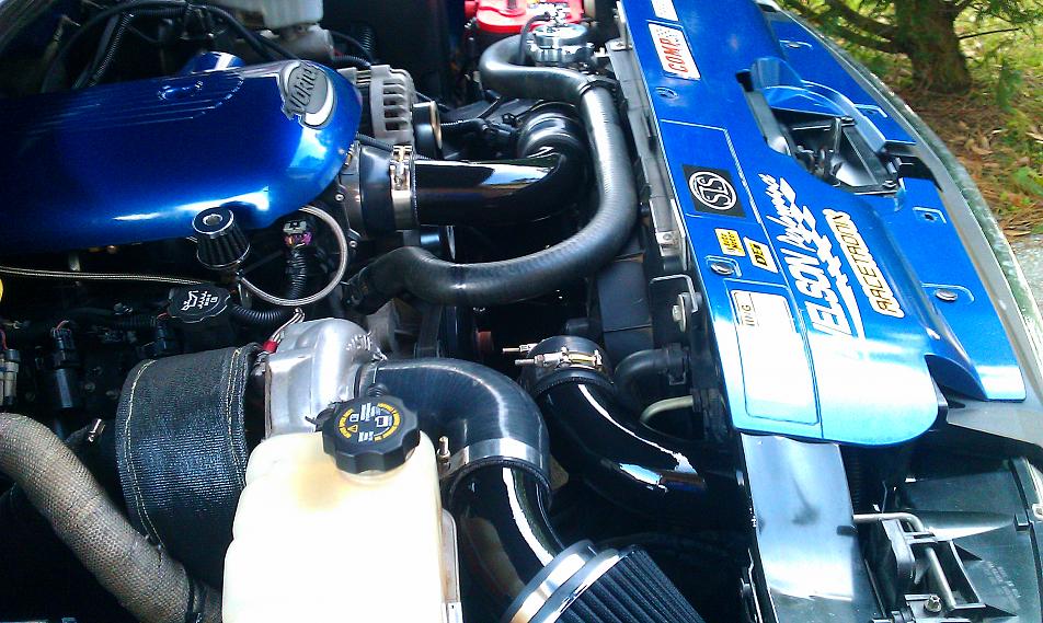

Considering you can make your own intercooler kit for round $200 and a days worth of work. It kinda seems like a no brainer to not run a intercooled setup.
