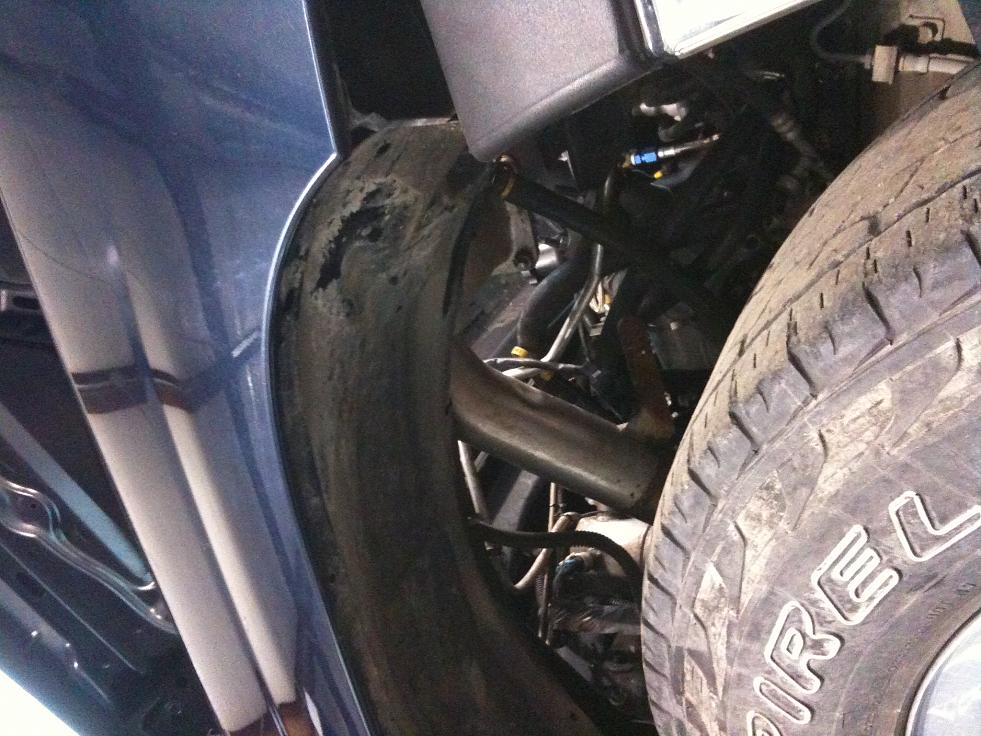

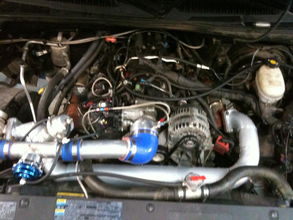

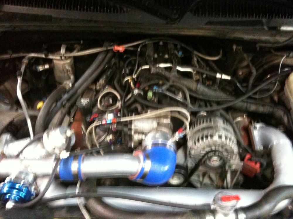

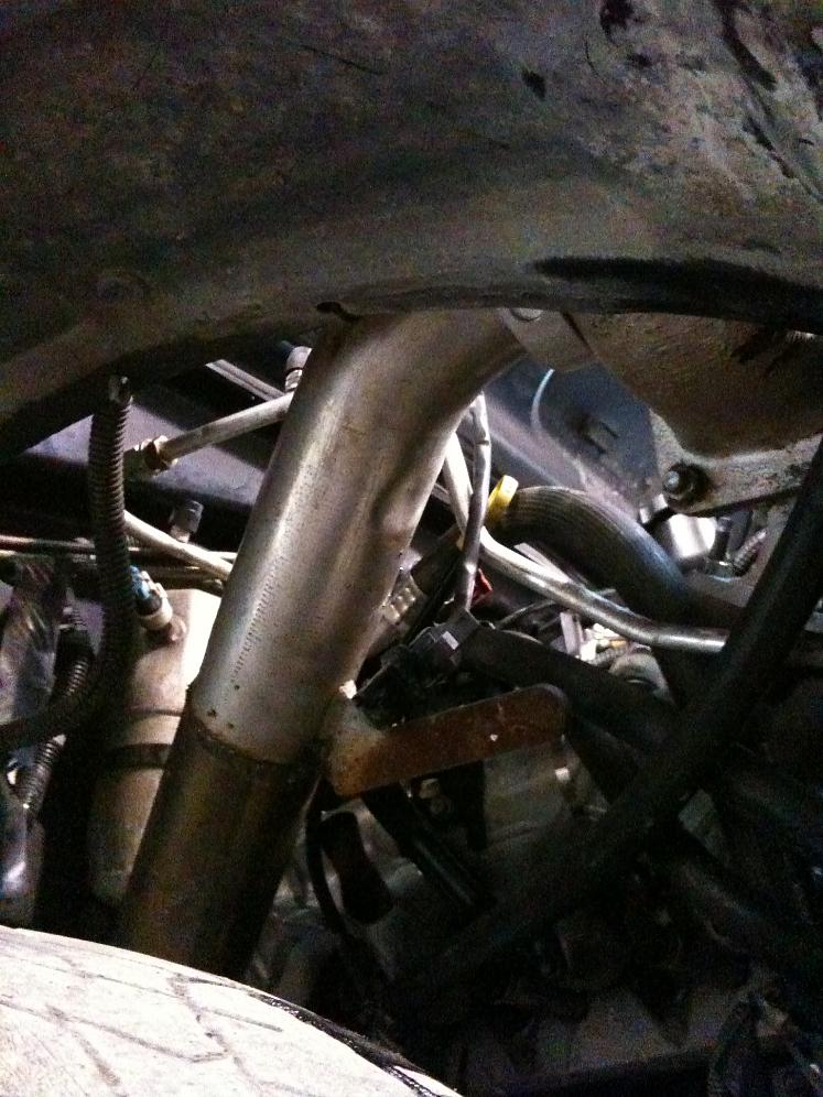

the turbo is almost done... it spools up lie nobodys business and is turning out good heres some pics... let me know what yall think...

right on. what turbo? that cam is working all right with it?

Looks good, reason for no intercooler? And what is MSC?

its a GT-67the cam is working well, but its probably the reason im making boost at idle... MSC is Main Street Customs. i will be running an intercooler but not until i can afford an A/W... im only running 5 to 8 psi... im running the stock fuel pump and no FPR

i guess im also wondering if i should run the wastegate into the atmosphere or back into the DP... any sugestions

run on open dump... that way you dont get creep or w/e
also it sounds much better lol
