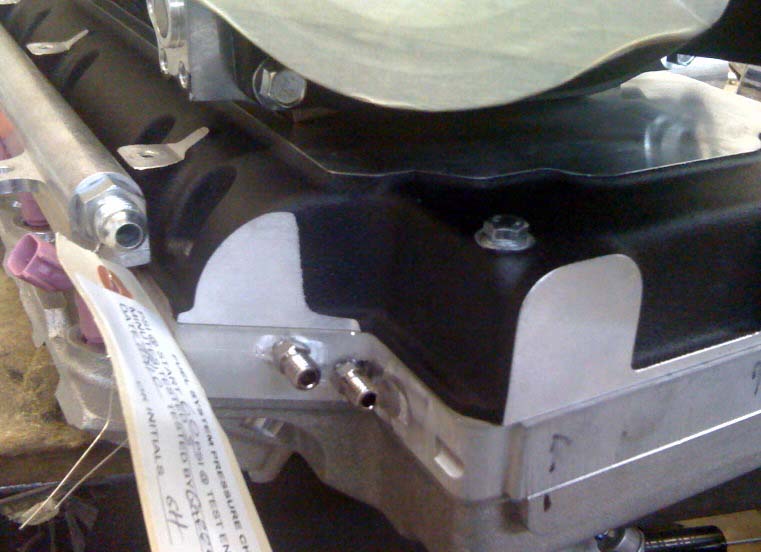

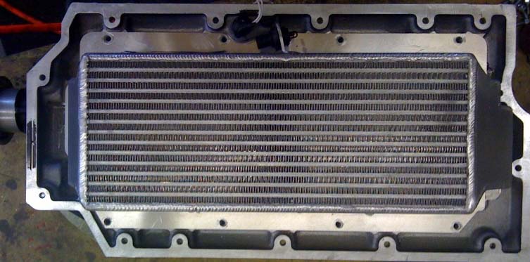

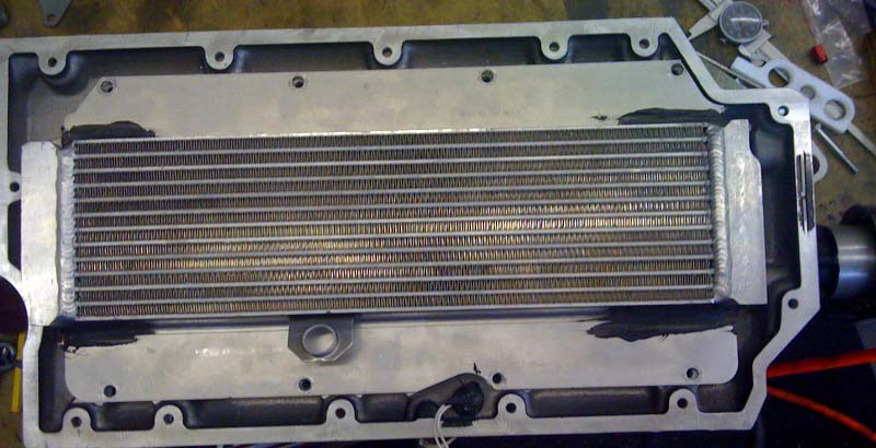

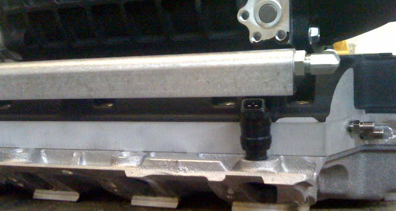

Not too much to report.
Nitrous plate is done, core is done, installed and sealed up. You can see the size difference really well in these pics. I will have more later.
One problem you will have with this set up is the fuel rail height. You either will have to swap to a taller injector, or do some custom fuel rails, or modify the stock rails that maggie sends with there stuff.
One of the pics shows some 48lb bosch units I have here for mock ups. With these injectors installed the rails bolt down fine.
We did make new silicone spacers and pulled the ic away from the blower about .175. The IC is still close to the bottom but farther away then the stock unit.
Completely removed the stock water inlet adapter on the back side. So we can keep the water flow hi. The stock unit is pretty but the ID holes are pretty small compared to the ID holes on the new inlet, outlet..
We had to weight on longer bolts.
Here are a few pics, I will get some more up soon.
NOW for the diy installer. There are small tweaks that have to be made on the fly while installing the IC. So any future builds will require the blower unit be here at our shop.
Attached Thumbnails New 2300 Massive intercooler. :)-photo-47-.jpg   New 2300 Massive intercooler. :)-photo-46-.jpg   New 2300 Massive intercooler. :)-photo-45-.jpg   New 2300 Massive intercooler. :)-photo-44-.jpg
