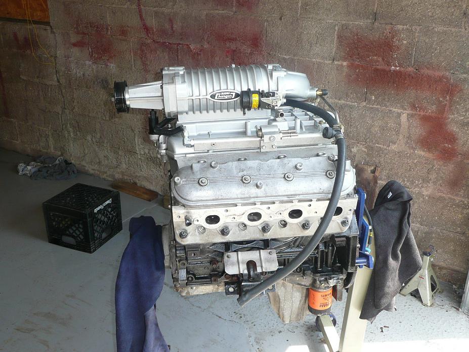

i would do a bosch pump in the tank, long tube headers, intake, pulley, and retune/ custom tune. those should help it purrrrrrr. might want to invest in a fuel pressure gauge first before u spend money on a new pump.
when you look at your radix's snout if there is a spacer inbetween the snout and the blower it is the 122. i also dont think the 112's have a radix sticker on the side of the blower like the 122's

Thde 112s have a little space in between the front cover and the case. Unless Im not understanding what youyr saying.

is there a spot on the fuel rail you can tie into and run a guage into the truck to see what the pressure is?
ya i guess i am wrong. the 112 does have a spacer.
Ya, I think you can run it off that spot where the black cover is in the picture Lance just posted. You'd have to take the core out of the schrader valve and then you should be able to get it there.
Someone correct me if Im wrong.
I knew because my friend got a polished 112 and that spacer wasnt polished, so it really stuck out. lol
Yes, this is correct.

Lance, that Radix pic is pretty sweet in post #17!
