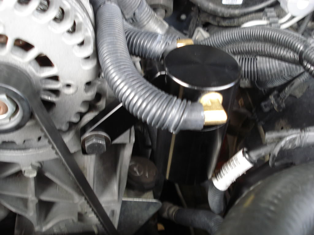

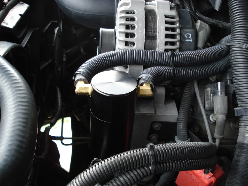

geezz man a bad azz truck like that and you cheap out on a catch can
btw here's mine
