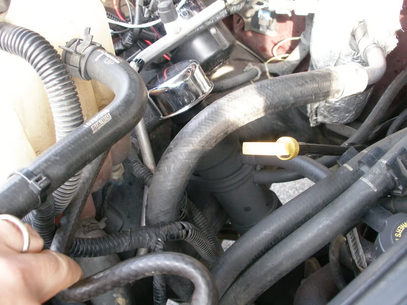

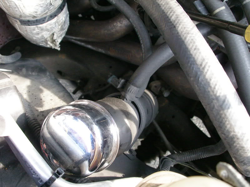

I think the radix makes it simpler. I routed the pcv hose and the other line that went to the intake tube into this homemade job. I have no oil in air track anymore and everything seems fine 20K miles later.
It's just a vented cap with filter on top of a 2" piece of PVC with a screw in cover on the bottom.

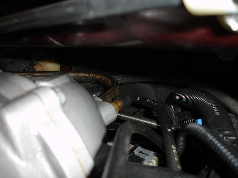

Nothing to it. 3/8 line from the PCV valve on the drivers side to the inlet of the catch. Outlet of the catch can to one of the large ports at the back of the J-tube. I need to pick up some more line and should probably put some clamps on them.
You can see the line from the catch in this picture. The port next to it used to provide the vacuum to the brake booster. Now I'm hydraulic braked.
