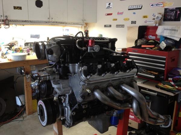

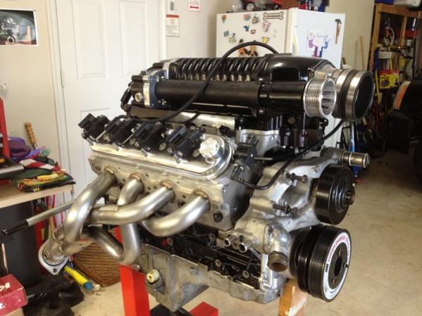

Couple of Pic's of rebuild
Attached Thumbnails Motor Grenade'd Looking for Feedback-2013-06-08t18-56-08_13.jpg   Motor Grenade'd Looking for Feedback-2013-06-08t18-56-08_14.jpg

Who is doing the wiring?
Old Jun 12, 2013 | 07:29 PM
  #27
03SuperSLADE's Avatar
Joined: Feb 2012
Posts: 106
From: Davie, FL
TORQ in Miramar, FL will be wiring in the LS3 harness.
