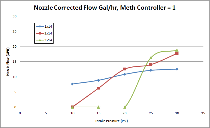

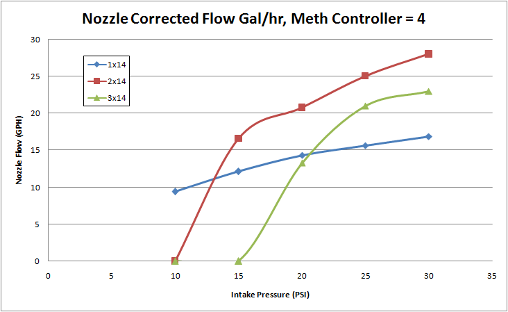

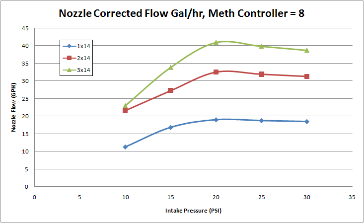

Alright so I got a chance to revisit this. It looks like my pump voltage was low in the first series, around 6.8v at full blast which is why my numbers were lower. After talking to Julio I tried a couple things and got everything lined up. I upgraded the power wire by adding in an additional 12ga wire straight to the 4ga from the battery. I also adjust the controller "initial" **** to about 1:30 clock position from the 11:30 clock position it was before. I also recorded all the voltages this time.
It looks like from doing this I gained roughly 3.5v at full blast which greatly improved the flow numbers.
Controller set to "1"

Controller set to "4"

Controller set to "8". All the way up.

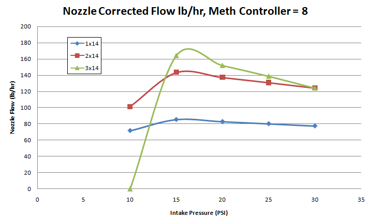

So if we compare this one to my result last time...
Obviously it is working much better now
It is clear the pump is struggling with 3 nozzles at low controller settings. This would indicate I need more tweaking with the turn on and initial settings to really optimize this. It is clear though the pump is at full voltage by 20psi the way I have it set (voltage readings confirm this).
To put some numbers to it, using 2 nozzles after my latest adjustments at 25psi of boost the system is moving 211 lb/hr. Before at these settings it was 131 lb/hr. Thats a 61% improvement. Comparing to earlier with 3 nozzles at the same settings was 139 lb/hr so a 52% improvement over that.
What im getting at is I did not have the system set up well before, but now there is clearly no need for a 3rd nozzle at this point.
