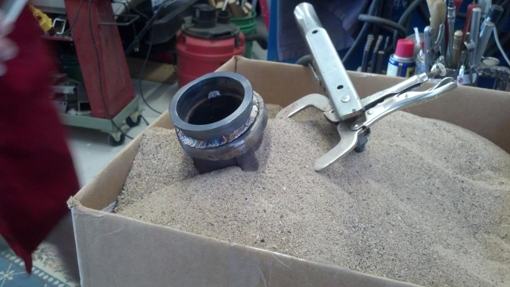

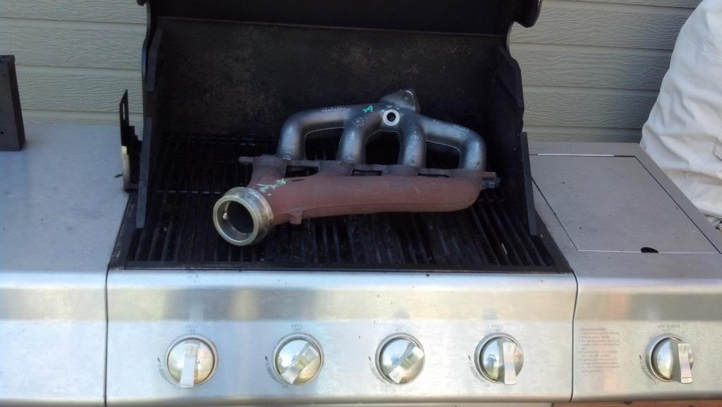

this is how we welded my cast manifolds...
heat to 500*

bury in sand to obtain the heat...

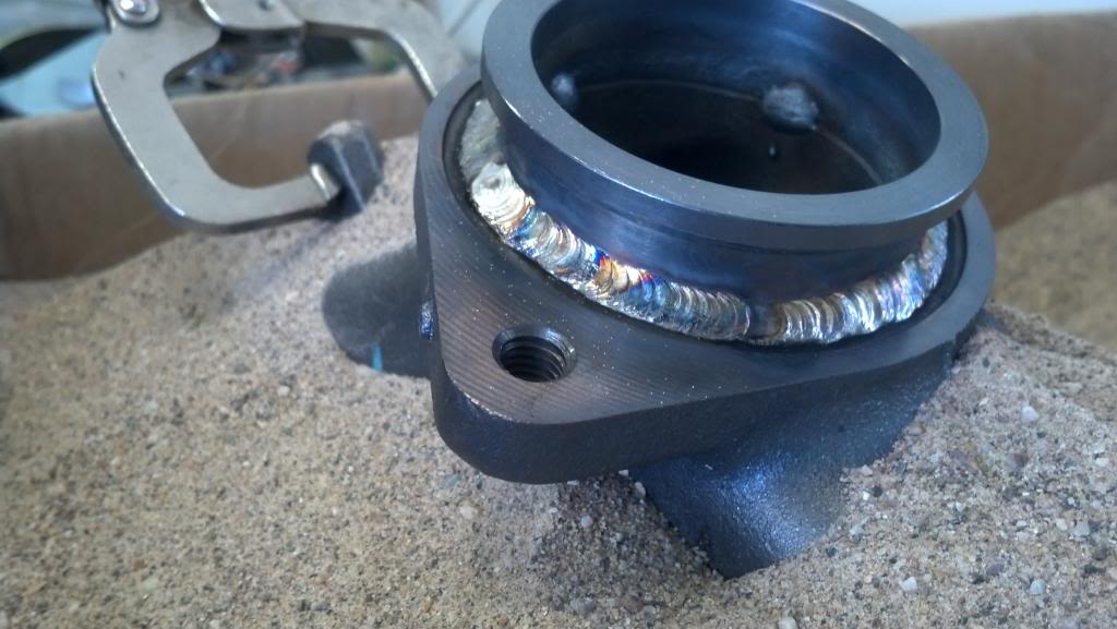

weld and make pretties ...
