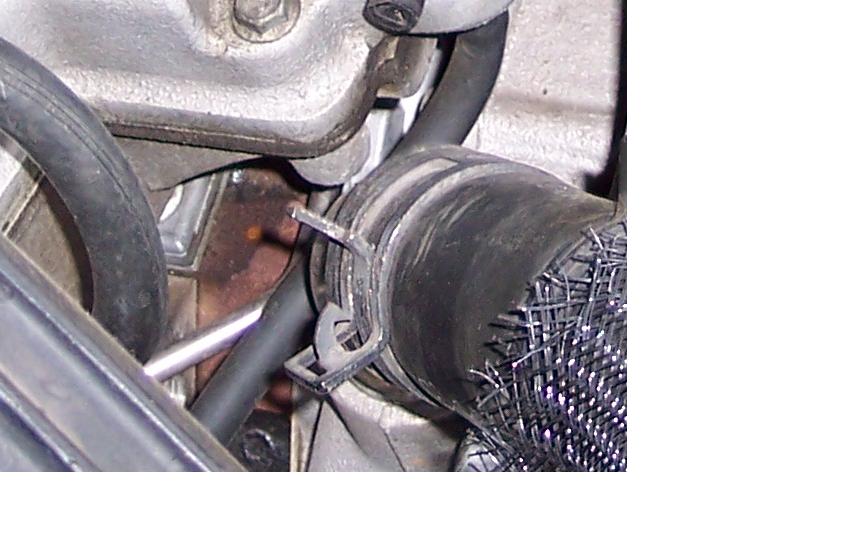

Originally Posted by moregrip
excellent work!
How do you get the tubes to seal in the holes drilled considering they will be under positive pressure?
Thanks,
I use a thread sealing compound, that is good for .010 gap. The tube to wall gap is only .004 so se we are covered there. I have been going over pics Chris was nice to send to me. The water neck and altenator area is in question? But once I get this into someones hand that has the unit on their truck I am sure it will be fine.

Originally Posted by KySilverado
For some reason I see an interference with tubing on the front in my mind. Have to get home and pop the hood on the truck. Maybe I'm wrong. Is there room for the snout support in front of the hook ups tab?
That caught my eye also.
Old Oct 23, 2006 | 01:45 PM
  #103
NXRICKY's Avatar
Former Vendor
Posts: 2,801
From: Wichita Falls, TX
Yea, nothing a little tweaking, bending, can not handle. I think if it does hit the water neck. All I have to do is raise that corner a smig-gen. No big deal with the tubes on the outside they can bent to fit around that neck.

Originally Posted by 1SlowHoe
Hows it coming along? .
Well I threw it away. Just kidding. the plate is done and even had room to tweek the lines up on the passenger side and should clear that water neck.
