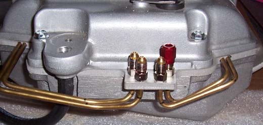

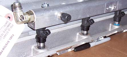

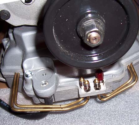

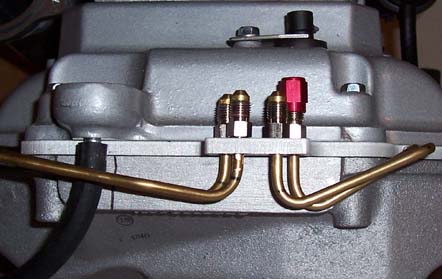

here are some more updates. Tubes are installed ready to drill. This plate the fittins are really to close, but for a working prototype it should kick ***. Now the injectors are where the skinny is at, seeing how I do not have larger injectors to trial fit to see what the final height would be with those.
Anyone useing stock delphi will need a cutting tool to remove the stock brackets.
Thoughts?

Lookin' good so far, but my thoughts are most people will be too scared to actually use nitrous with their Radix. I hope those who have pushed for this will step up when the time comes and you start selling them. It seems like quite a bit of time and material is going into this project, hope you get some buyers.

Likes: 33
From: Wyoming
Thoughts?
excellent work!
How do you get the tubes to seal in the holes drilled considering they will be under positive pressure?

Dunno if I would want to cut anything up. Thinking about re-sale down the line. If I were to go this route I would probably be changing out injectors and they would be taller than stock so wouldn't be an issue. Not all would be going this route though.
For some reason I see an interference with tubing on the front in my mind. Have to get home and pop the hood on the truck. Maybe I'm wrong. Is there room for the snout support in front of the hook ups tab?
