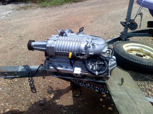

Can you guys tell if this is a 112 or a 122? It was pulled from a 2002 2500HD with a 6.0L. Thanks! I did a 2004 LQ4/ 80E swap into a 92 GMC last year for a customer and he is toying with the idea of Magnacharging it. I doubt he will ever try to max it out so I wonder if a 112 would be ok for his intentions. It will never see the track, he just wants a little more than stock. Opinions?

Looks just like my 112.

That's the 112. 112 has 10 splines on the case while the 122 has 12. If all he wants is 'just a little more' than stock, then the 112 at 5psi will be fine.
